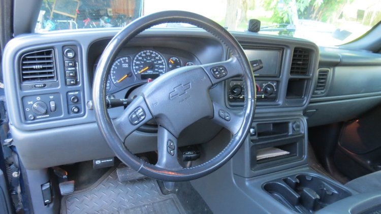

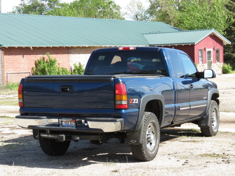

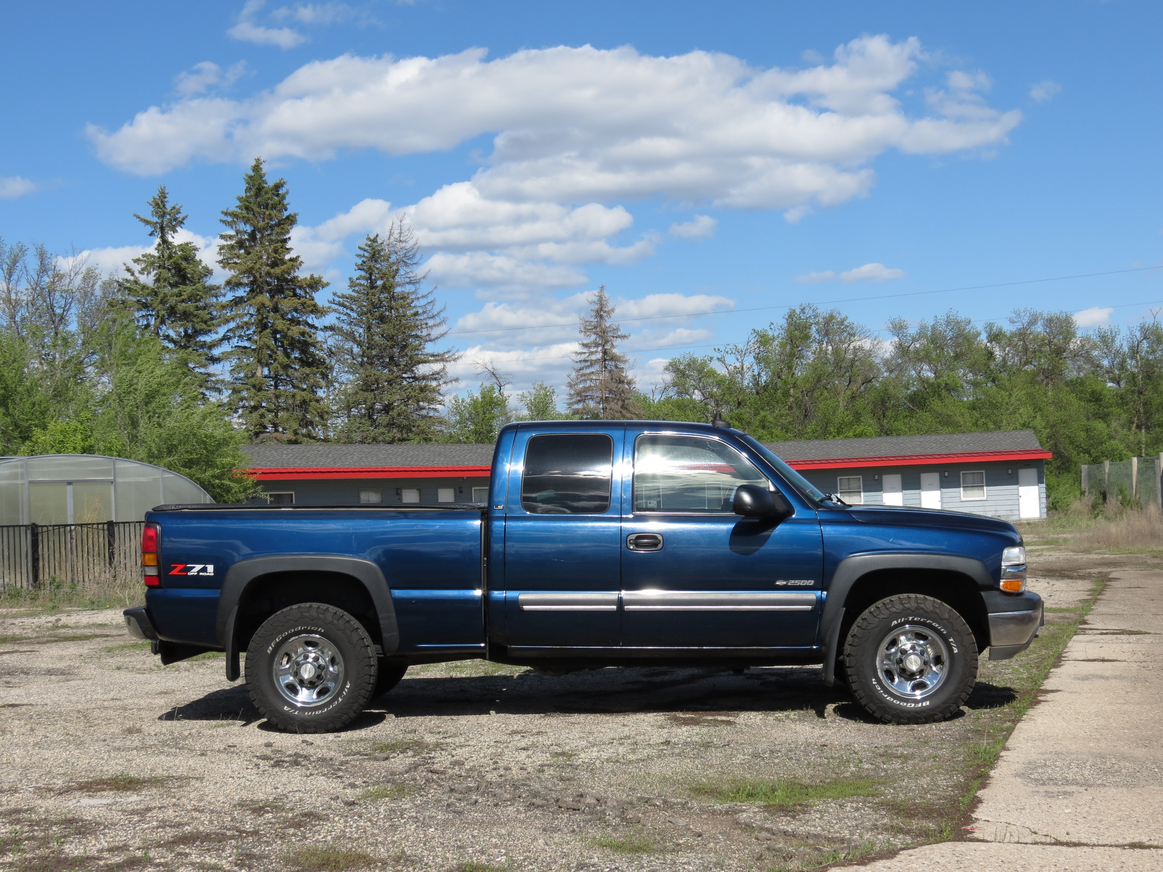

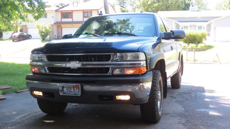

  1. Here are a few pictures of my Silverado! There are many many small modifications inside and out to make my truck resemble a 2003+ facelift GMT800. This truck and every electronic in it is still like all 1999-2002 trucks though. Listed below is some of the things I've done off the top of my head. (Nearly everything was sourced through my local junkyard) Interior: 2003+ Full console (with Bose sub) 2003+ Steering wheel (Steering column spline shaft change, with a single stage express van air bag) 2003+ Gauge needles (Easy to find in 2002-2009 Trailblazers) 2003+ Black interior buttons (dimmer switch, 4wd selector, fog lights/cargo lamp) 2003+ Double din dash bezel with Sony touch screen 2003+ Dash cubby 1998-2001 Oldsmobile Bravada climate control knobs 2004-2006 Escalade Platinum speaker grilles (painted to match interior) 2006-2007classic Upgraded Gentex rearview mirror 2007+ GMT900 Column shifter Exterior 2003-2005 Camper Style power extending mirrors (fully functional power extending and retracting Via a momentary Waterproof Reverse Polarity Switch, working signals in the glass as well as full adjustability using door panel mirror controller) 2001-2002 HD hood (Factory paint that already matched the truck, got from the junkyard for only $25!) 2000-2006 Suburban/ Tahoe front chrome grille 2000-2006 Black textured Tahoe door trim (The rear door trim length matches the length of extended cab trim) GM Genuine Black textured mud guards 2004-2007classic GMC Sierra black outlined taillights 2001-2007classic Z71 Off-road rear bedside stickers GM Genuine Upgraded aluminum front skid plate, Steel transferase skid plate installed as well GM Genuine Tailgate spoiler cap 2001+ Dually/Quadrasteer rear marker light (this one was from a Quadrasteer Denali!)

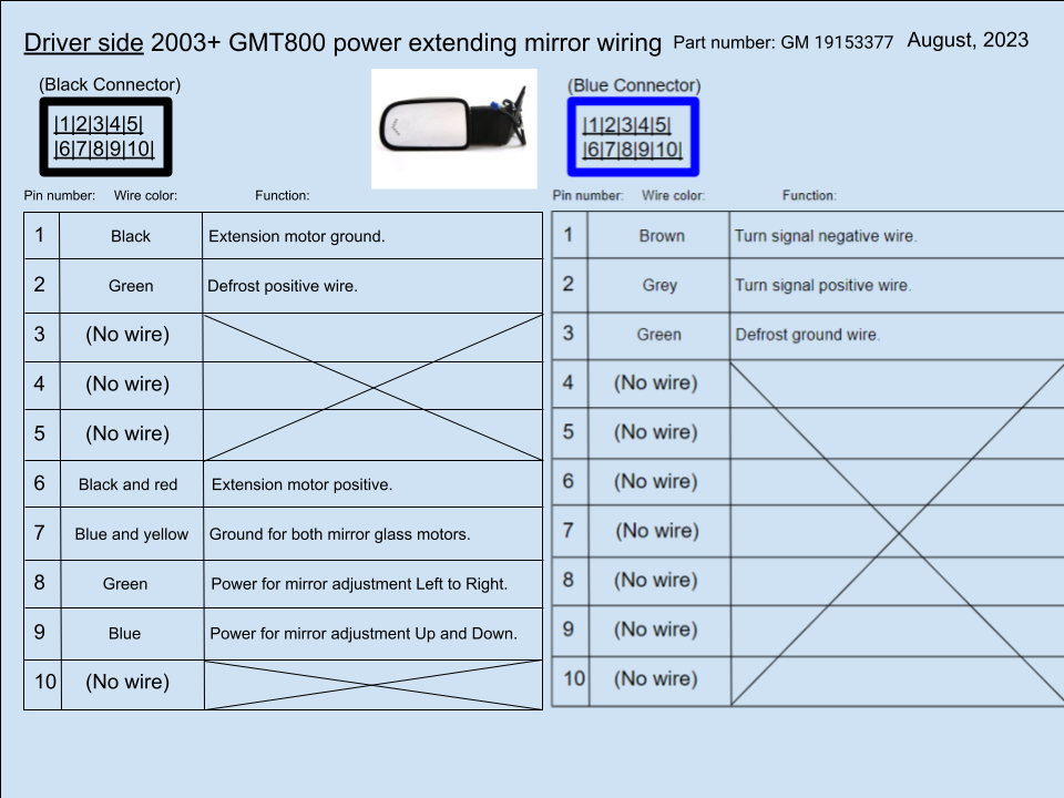

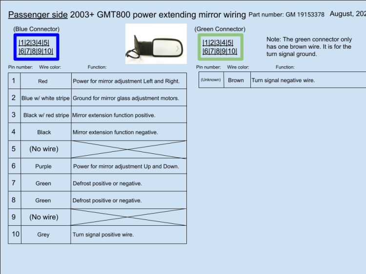

  3. Hello, last week I picked up some power extending mirrors from a 2004 Chevrolet Silverado 2500 at the junkyard for about $40. I own a 2000 2500 Silverado and I wanted these for my truck. So I took them apart and made diagrams for both driver and passenger side mirrors. While I was at the junkyard, I also got two 1999-2002 mirror connectors so I could plug them into my trucks mirror harness after splicing. I made diagrams for those too.
