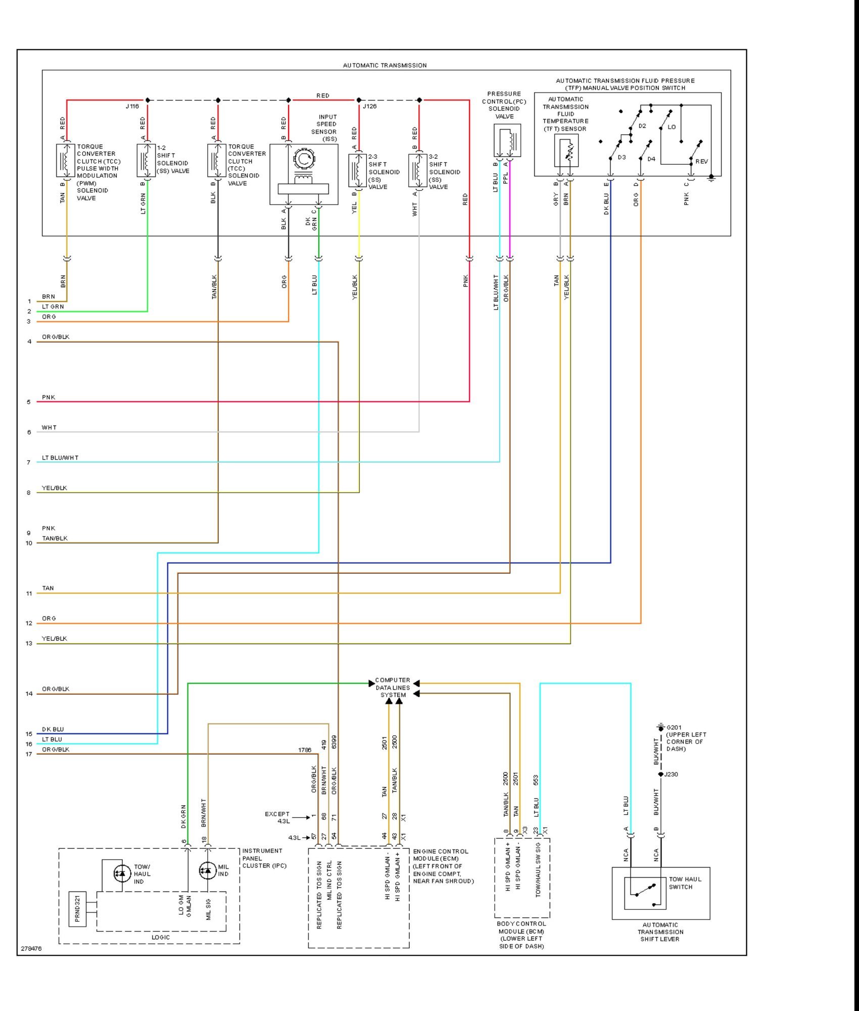

  18. Got my truck on the ramps. The plug is on the top side of the tranny. I dare not pull it out for fear of never getting it back in. I figured that it is the yellow & tan/black wires. I did find them on the transmission control module (pictured below). No idea what I would test or how but quick question, do these wires look like someone has been in here before? tan and black wires. Maybe this has been a problem? What do the tranny gurus think?

  20. How should I diagnose the problem? Visually inspect the harness?

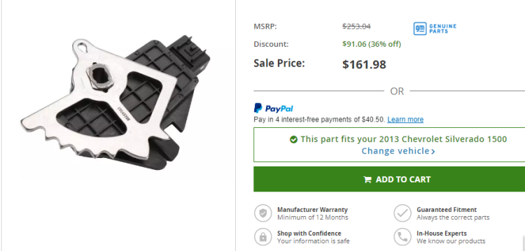

  21. https://g.oempartsonline.com/oem-parts/gm-automatic-transmission-gear-position-sensor-19181161 That's where I shopped for the part and it told me it would not fit. Do you have any spot for a tutorial how to change the part out? Do i need to drop the valve body?
  22. Half the parts houses I look up that part say its the right fit, the other half say it's not and I need Automatic Transmission Manual Shift Shaft Position Switch - GM (19181161). Seeing how one is $29 and the other is $168 I am hoping you are right. But nothing anywhere talk about transmission temp sending in any of these parts which is super frustrating.
  23. That is super helpful. Thanks. I will inspect it. (top right rear, is that passenger side?) Can you confirm that the trans temp is in the wire harness in the tranny? And any idea how I can find the part number other than going to the dealer? I can't find it anywhere. Most the time I have no transmission temperature.
  24. That is what worries me. You can chase those forever. Maybe I will crawl under the truck and look at the harness where it enters the firewall?
