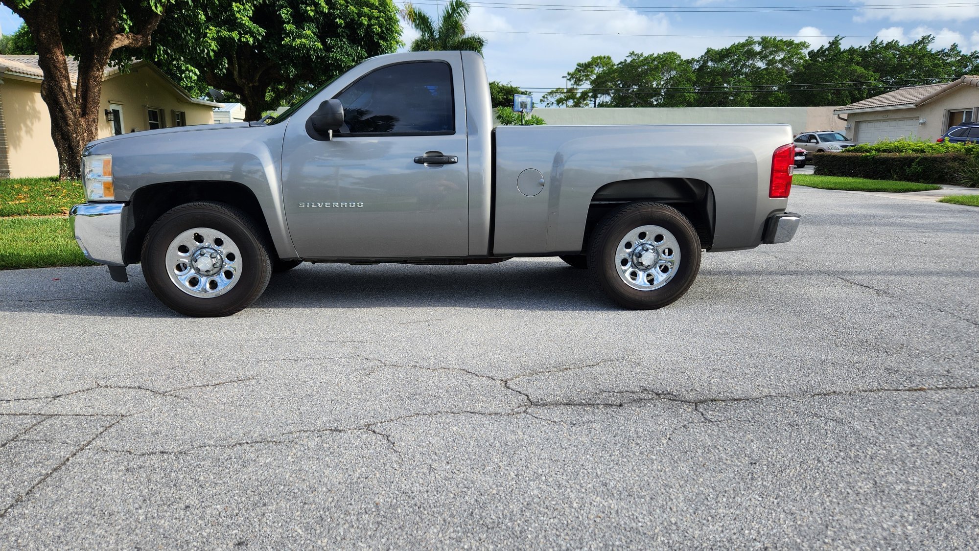

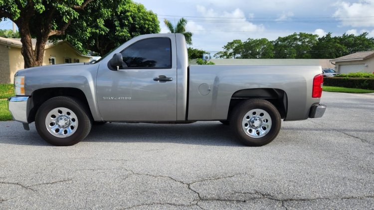

  7. Including lunch and a trip to Harbor Freight, it took me 5 hours to do the first side. Took a little less than an hour to do the other. Lowered three inches. This is the lowering shackles I bought. Wish I saw they came with U bold spacers when I removed the block. Had to do it again on the first side. I bought an impact last week and I am so so glad I had it. That would have taken exponentially longer without. The biggest hassle was just figuring how to reach the bolts and get the axle in place. So the second side went easy peasy. Having the leaf springs lose from the axle was the key for the upper shackle bolt.

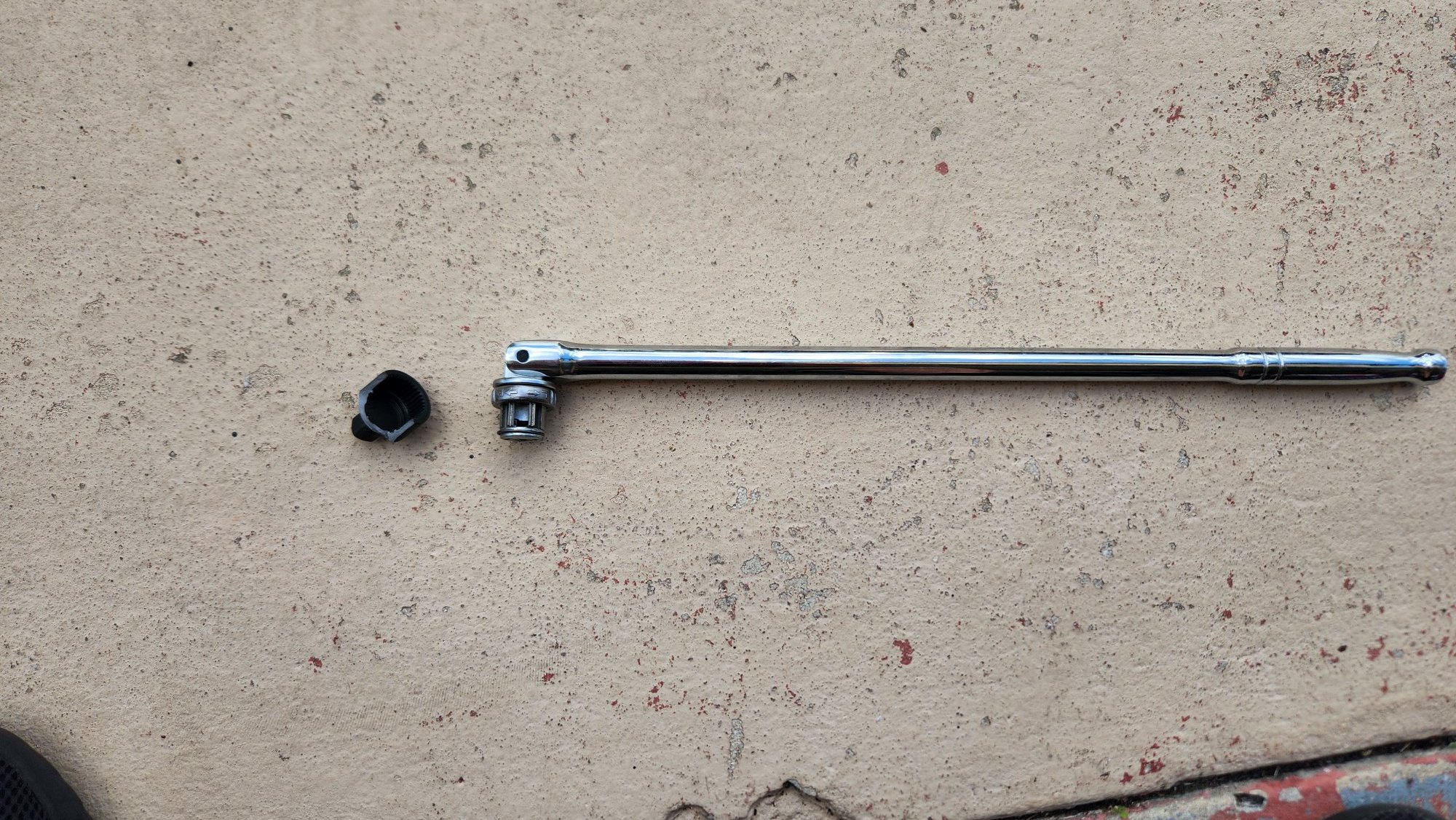

  10. Well, got the U bolts off with no problem. But first time using this HF breaker bar to take off the wheels and it snapped. Off to get another.
