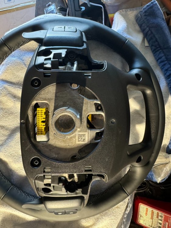

  1. More photos to help you if you need them.

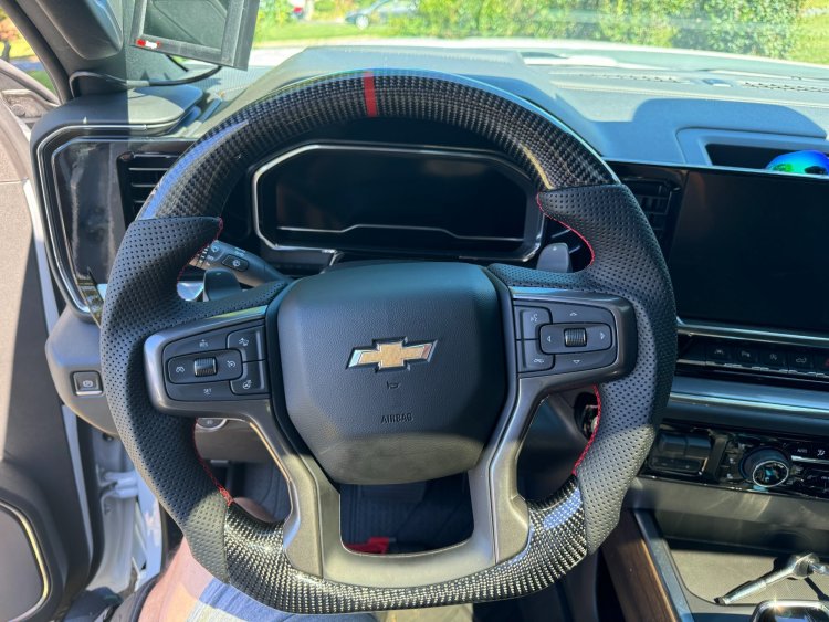

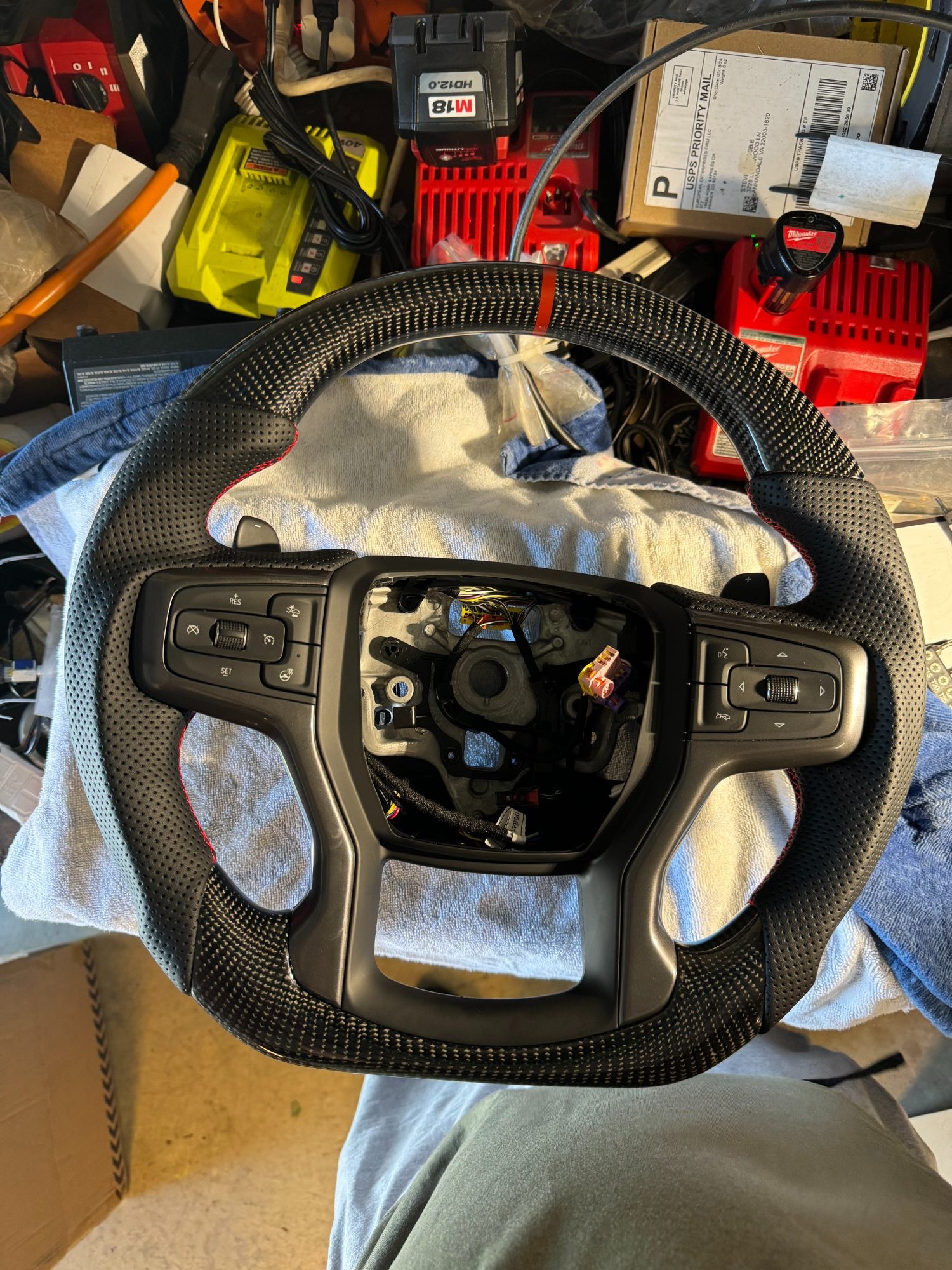

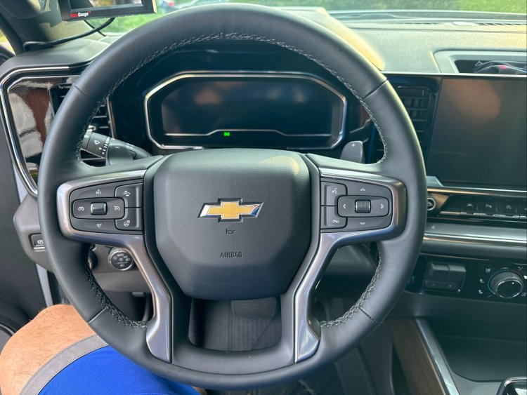

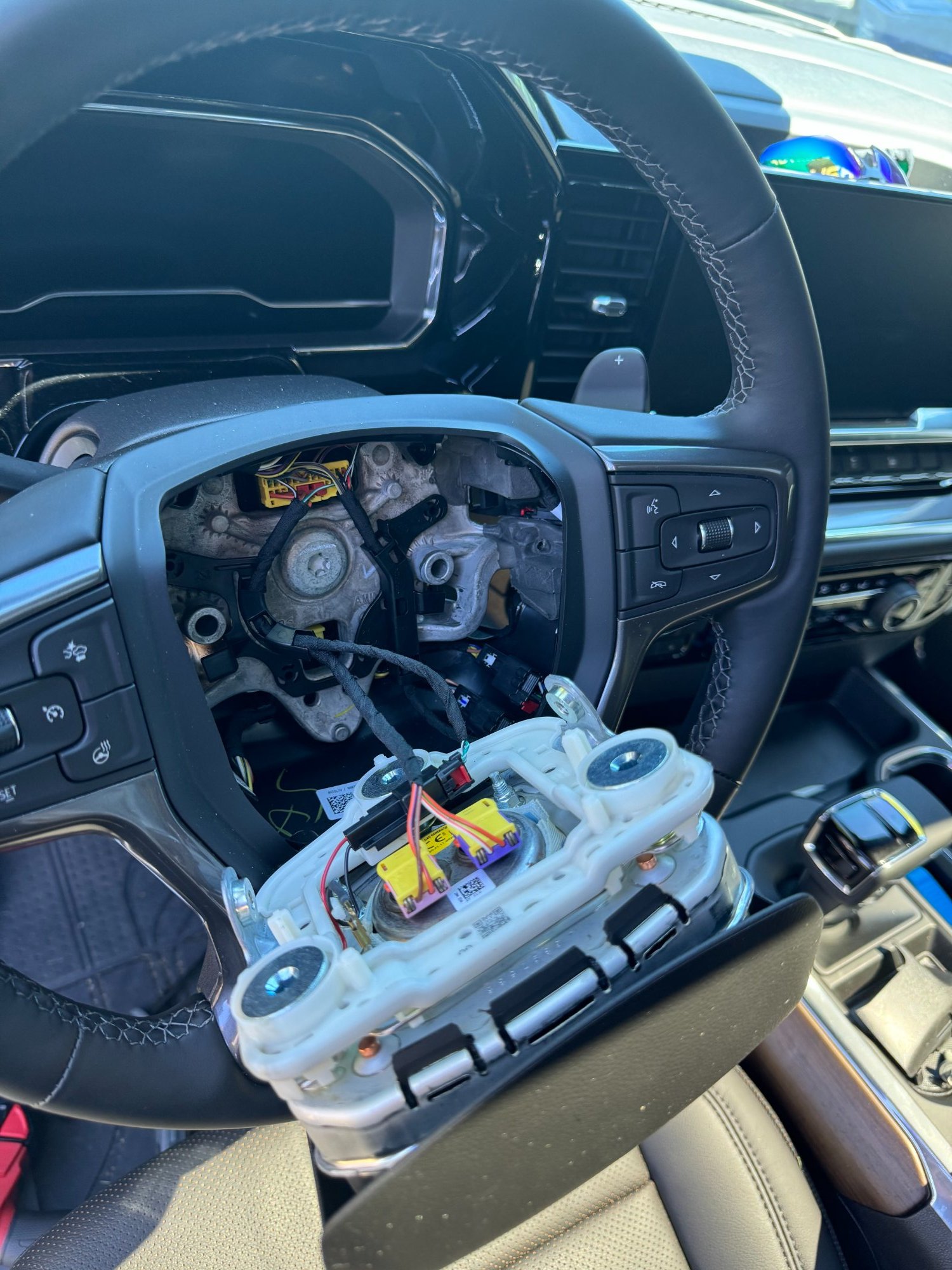

  2. After purchasing my new High Country, I was less than impressed with the steering wheel thickness. The Tundra I had and the Ram before it had a far thicker steering wheel, which I preferred. The Ram had wood inlaid into the top of the wheel that I also liked. This new wheel feels very high quality and I'm pressed with the look and feel. I was looking across ebay and found this wheel: https://www.ebay.com/itm/305680150993 Final Product Installed is attached, airbag removal, and old photo. The job wasn't very difficult. Tools Needed: T50 Torx w/ extension 10mm Socket T15 torx Plastic interior pry tool so you don't mar any plastics Blanket so you can work the old and new steering wheel without scratching anything 2 small flat head screwdrivers to remove airbag plugs Notes: Disconnect battery (10mm socket) Pry the two access panels off the back of the wheel to access the 10mm bolts to remove the airbag I used an impact Gun to get the steering Take pictures of the interior wiring so you know where things go T15 screws are on the back of the wheel, note the order you take them out. All go in at the end after you put all of the switches and plastic covers back on
