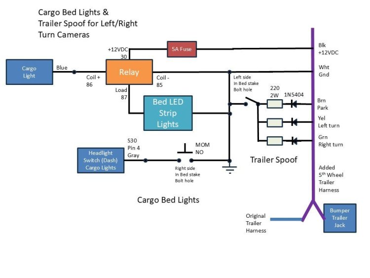

  16. I used this MOM switch mounted in the bolt hole where the post for a rack would be inserted. No drilling needed. I did use two stainless steel washers to cover the entire hole. You can also tap the ground on the existing cargo lights to run one less wire. https://www.amazon.com/dp/B09BKWMNJ9?ref=ppx_yo2ov_dt_b_fed_asin_title&th=1 73, N1WV
  17. Looks like pin 19 on BCM. You are adding a momentary contact switch in parallel in the bed to duplicate the cargo switch function. What's nice is it keeps the 10 minute timeout to automatically turn off the lights if you forget. Push on. Push off. Sweet.
  18. I used pin 4 on the headlight switch in the dash. Easier to get to than me crawling under the dash to get to the BCM. Here is the schematic info for both sides - headlight switch in dash and BCM under dash.

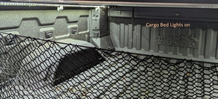

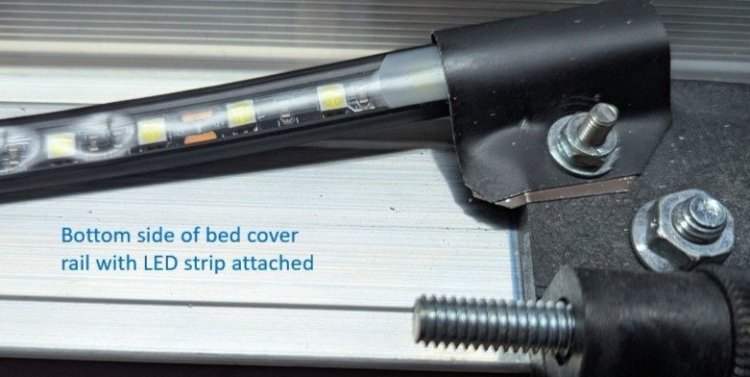

  21. Added Cargo Bed LED strip lights and a Trailer Spoof circuit to my '23. Used the headlight switch wire described by DasGoob above. Works great. It was easy to get to the cargo bed switch wire in the dash. It took more time to run it under the truck. Still easier for me than trying to access the BCM under the dash. Strip LEDs are from amazon. They are mounted on the underside of my bed cover rails (aluminum) using double sided tape and Lexel caulk (Lowe's) to seal the deal. No drilling needed. Trailer spoof is to turn on the left and right turn signal cams. I like seeing what is beside me before changing lanes. Turn off switch also included. Resistors draw enough current for the BCM to think a trailer is attached. Diodes are to keep the circuits isolated. Used similar switches in the bed (12mm diam) as above and they fit nicely in the bed stake bolt holes on left and right fender sides with a few stainless steel washers. Thanks to all in this thread. Difference is night and day! See on and off pics.
