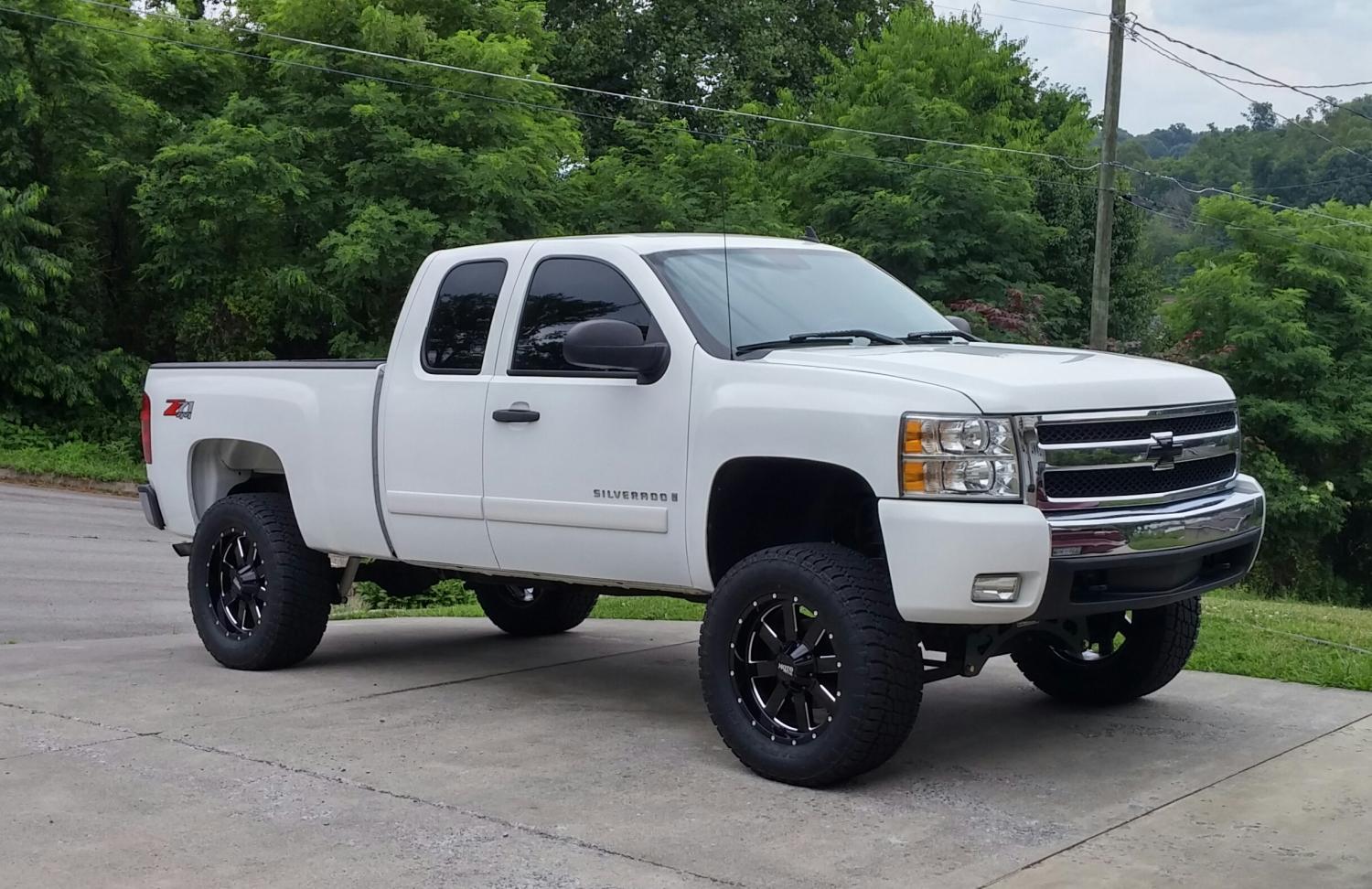

  3. Before: 2008 silverado Z71 5.3 with 3.73 gears and G80 locker 6" fabtech lift with moto metal 962 wheels 35/12.50/20 terra grapplers After:
