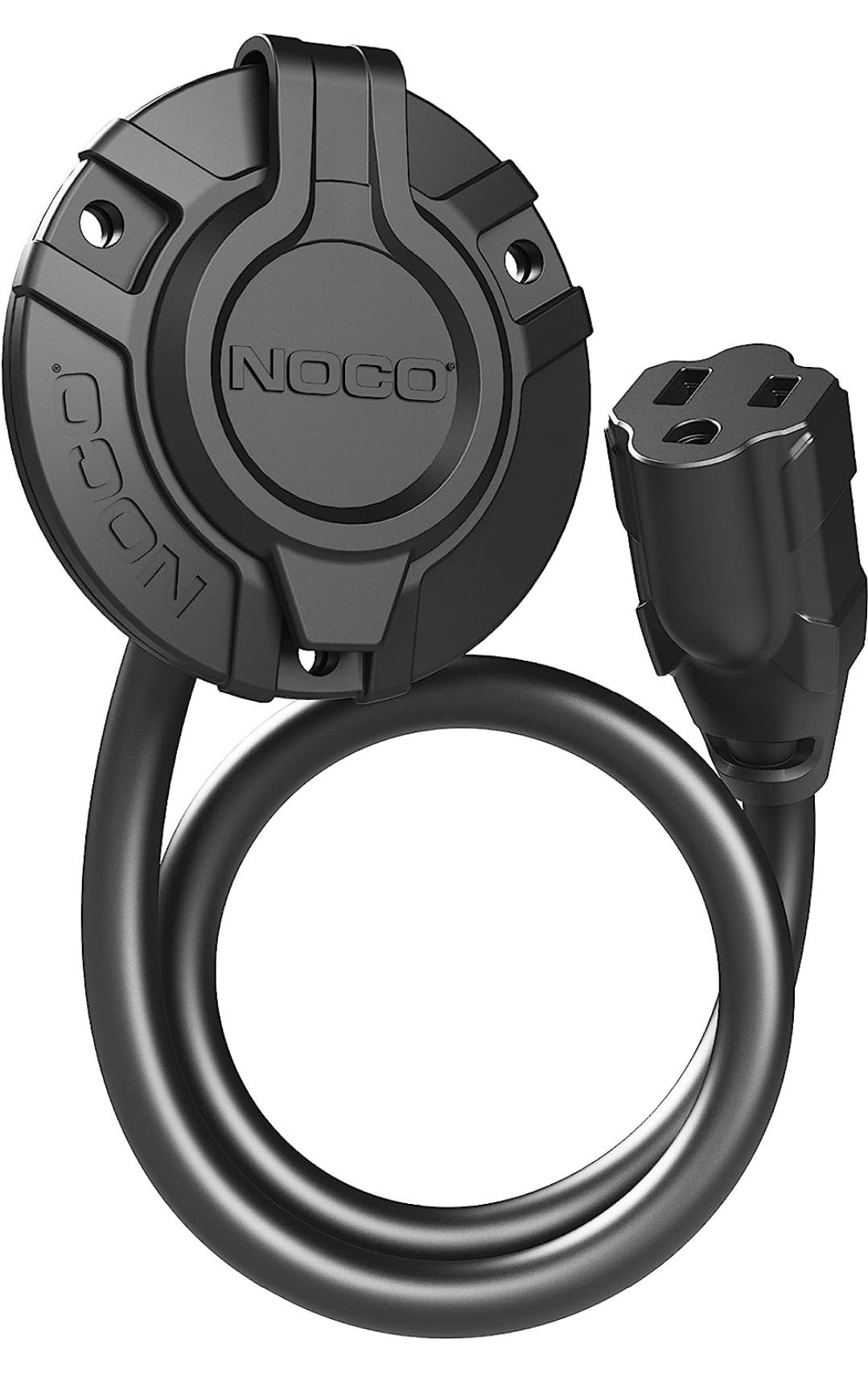

  1. Looking for install ideas with photos to add an AC Port plug to my truck. I don't run my truck enough to keep my battery in topped up. Planning on permanently installing a NOCO GENIUS 2D battery maintainer. I found several examples on Dodge, Ford and older Silverados but not much for the 2014-2018 models.
