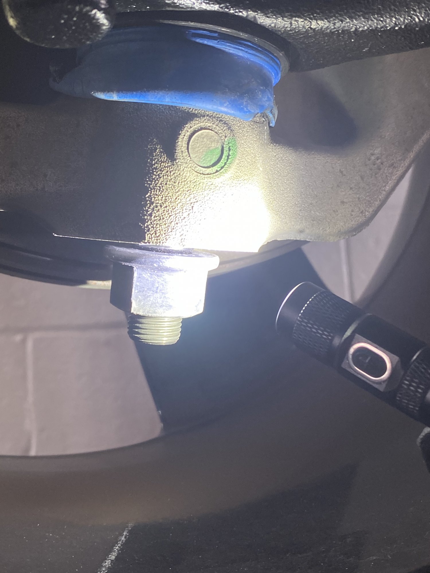

  2. I have a 2015 ltz z71 premium crew cab 1500 and was wandering if changing my lower control arms from the stock aluminum to the cast steel will affect the truck at all. Or if the two control arms are interchangeable below is the pic of what the control arms look like after I changed them out. Still have to add the washer but looks like they will work? Everything fits correctly other than the balljoint bolt length
