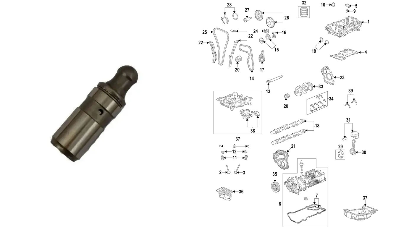

The annoying metallic tick comes down to internal engine debris. According to the GM bulletin, debris from the valve rocker arm can make its way inside the hydraulic valve lash adjuster. Once that debris gets inside, it prevents the adjuster from properly pumping up with oil. This creates what GM refers to as a “soft” hydraulic valve lash adjuster, which directly results in the audible ticking condition.

If you bring your truck in for this issue, dealership technicians are instructed to first verify that the ticking noise is actually coming from the valvetrain area by using a stethoscope or similar diagnostic method.
Once verified, the fix isn’t just a simple patch job. Technicians must remove the camshaft carrier and manually inspect for a soft adjuster by pushing down on each valve rocker arm where it rests on the adjuster. They are required to check every single one on both the intake and exhaust sides.
If the technician discovers even one soft hydraulic valve lash adjuster, GM dictates that they must replace all 16 hydraulic valve lash adjusters and all 16 valve rocker arms.
Because this is a significant internal engine repair, GM notes that the replacement is fully covered for vehicles still operating under the standard Powertrain warranty coverage.
But if you’re handy and out of the powertrain warranty for whatever reason, the Hydraulic Valve Lash Adjuster – GM (12663277) mentioned in the repair only run under $5 each at your local dealer. Unfortunately they are currently running on a 7-10 day backorder as of March 6th, 2026.
