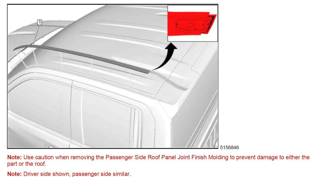

A engineering diagram showing the approximate location of the issue, with the drivers side substituted for the passenger side.
The location of the roof split on the Silverado and Sierra (driver side shown but the issue exists on the passenger side)
Silverado / Sierra Roof Splitting – The Problem
Some new 2024 Chevrolet Silverado and GMC Sierra full-size pickups may have roof panels that begin to split or crack on the passenger side.  The cracking, tearing, or splitting location is under the roof molding and is usually concealed from prominent view.

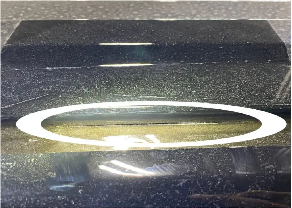

A crack or split on the roof of a Silverado or Sierra pickup
An example of the type of crack or split that this repair order covers on the Silverado or Sierra
Unfixed, the issue may worsen, causing a safety issue, additional corrosion, and leaking into the cabin.
