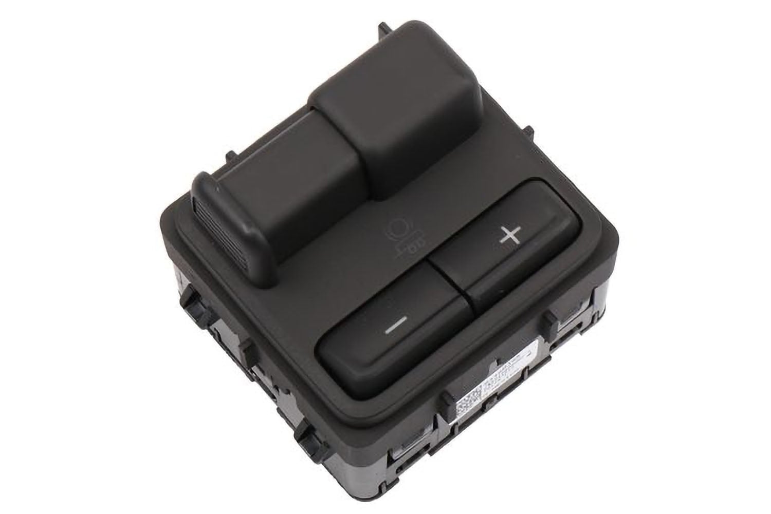

A close-up of a black, factory General Motors integrated trailer brake controller dash switch featuring squeeze tabs and plus/minus gain buttons.
You can easily find the OEM dash switch online for under $35, but buying this switch—or even a handful of other factory parts—will absolutely not work without the factory-integrated wiring and modules.

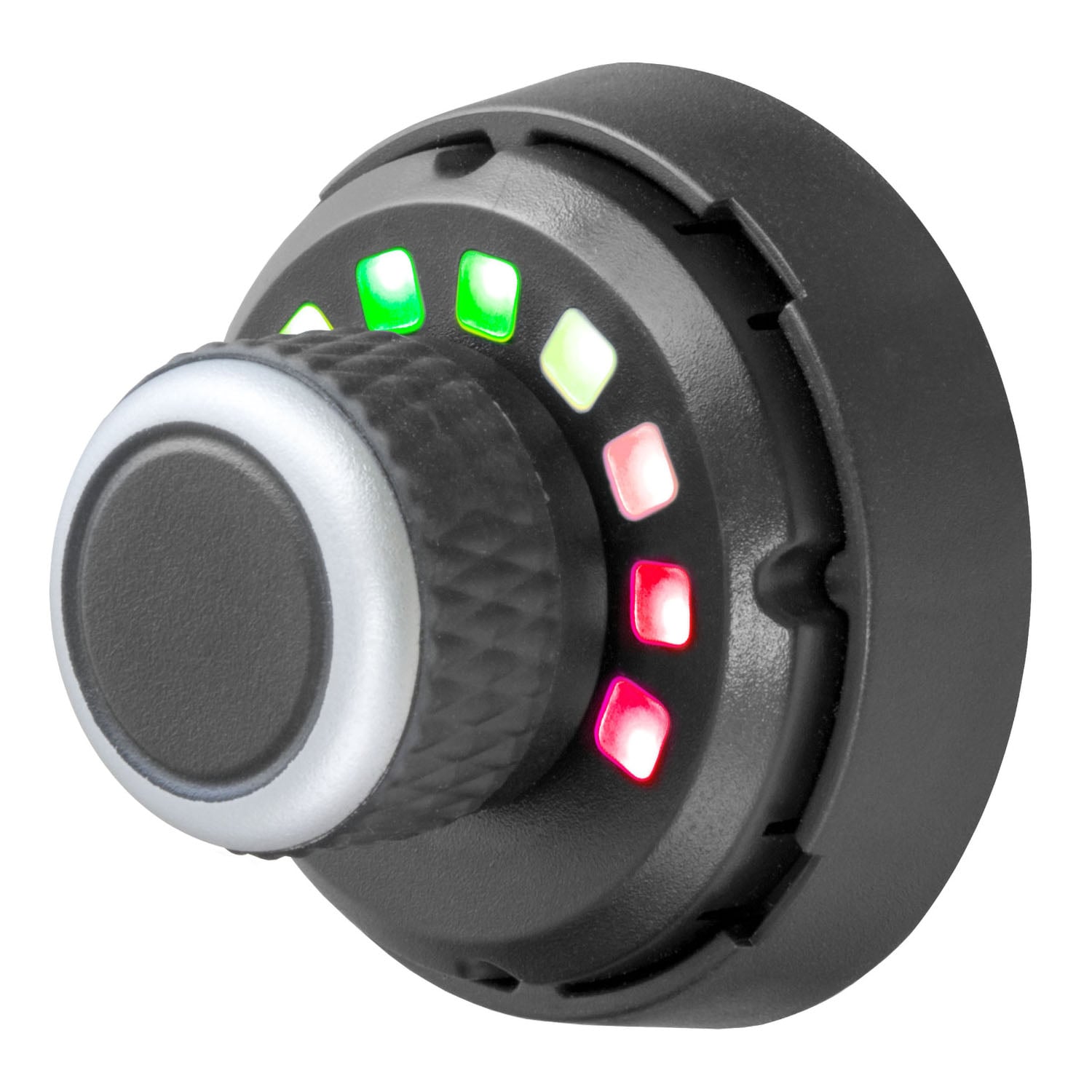

A close-up of a circular Curt aftermarket trailer brake controller knob featuring a textured dial and illuminated green, yellow, and red LED indicator lights.
Since the factory system cannot be retrofitted, installing a high-quality aftermarket proportional brake controller—like this sleek option from Curt—is your best and safest solution for towing heavy loads.

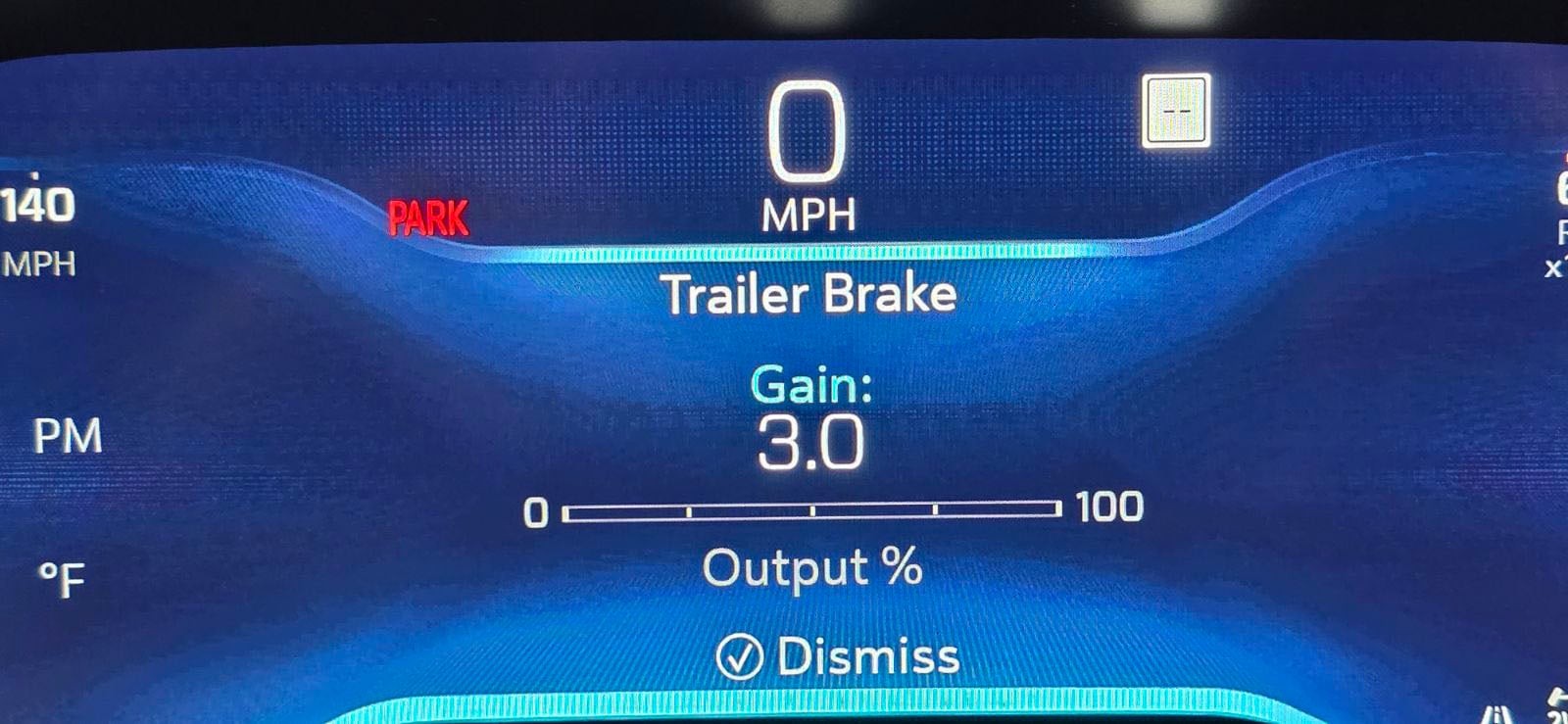

A digital instrument cluster display in a GM truck showing the trailer brake screen, with the gain set to 3.0 and an output percentage bar.
One of the biggest drawbacks to installing an aftermarket controller is that you will not get this seamlessly integrated digital readout on your instrument cluster.
