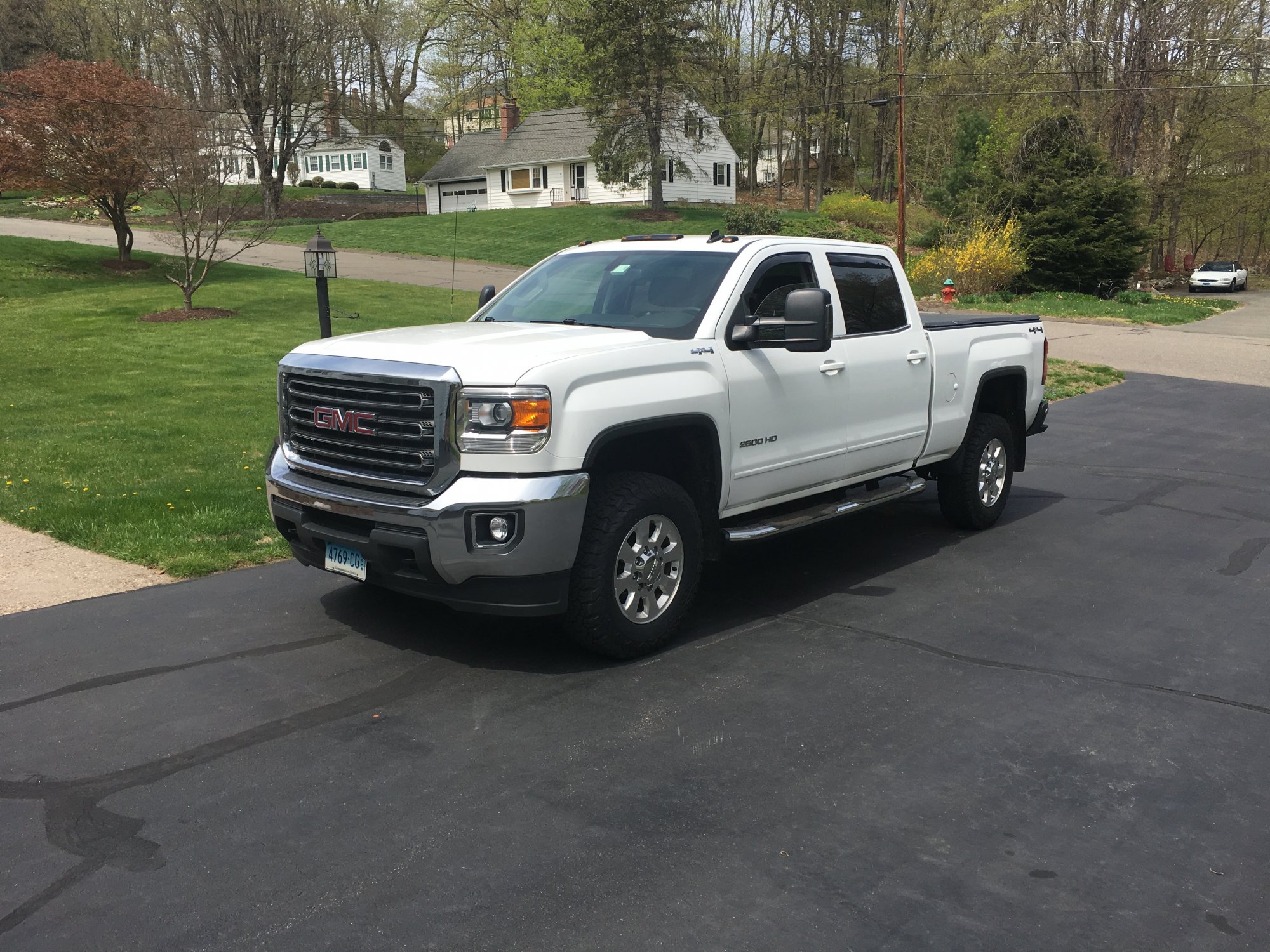

  1. 275/70/18 BFGoodrich Ko2 I raised the front about an inch 4 cranks on the bars. i dont think it would have rubbed if i didnt.

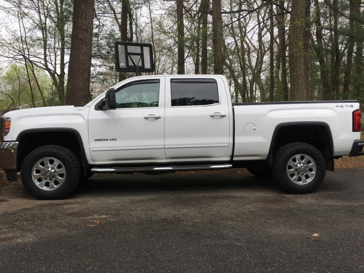

  2. Turned up the keys about 1 inch, got new kicks and of course an alignment. I went with BFGoodrich KO2 275/270/18
  3. installed these after market foglights using the OME bumper position last weekend. took about 4 hours or so. couple cuts and bruises. the mirrors were done last spring

  6. Looks great. What size tires did you mount on the original rims, and did you do anything to raise the front end? any rubbing? I assume those are OEM 18" rims. thanks
  7. Depends how the dealer orders them. When I bought my 13, they were ordering with the tow mirrors, now, not so much. Funny thing is if you order them on the truck, its about $300 - $400 option, if you go to the dealer and get the OEM its $1800. No thanks not on my dime. I had issues putting these on, they kept popping the fuse. Come to find out, its very easy to pinch the wiring harness between the mirror mount and the door. I took them off and found that I had done it, fixed, remounted being extra careful not to pinch them again and they work great. Next up, wire up the blinkers.
  8. Thanks for all the followup to you both. I did not get power folding. I have these. they are pictured in my profile pic. The truck is a 2015 GMC 2500HD SLE Model, I had power heated mirrors. no turn signal and no lights. When I first started researching at the dealer, they gave me a price of about 1800$ for the OEMs and they mentioned they would have to remap to make them work. Not sure if that is the case or not. https://www.amazon.com/Scitoo-2015-2016-Silverado-2014-2016-Mirrors/dp/B01MAUTYYK/ref=sr_1_3?s=automotive&ie=UTF8&qid=1482887753&vehicle=2015-48-551-556--53-6----9-2---1-0&sr=1-3&ymm=2015%3Agmc%3Asierra+2500+hd&keywords=2015+gmc+2500+tow+mirrors
  9. Installed tow mirrors. need to get the info on making lights and blinkers work since I didn't have it on the original mirrors. I may just have someone do it for me.
