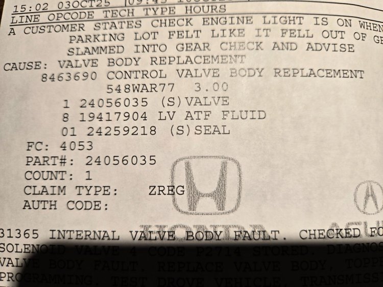

  3. I had my valve body replaced on mine at 33,000 it is thec8 speed. I thought the 8 speeds were bad for valve bodys?
  4. Did they replace the valve body? Is it an 8 speed?
  5. Sometimes when it's really cold like low signal digits or negative out my parking brake is on and Sometimes I get service 4wd message and my forward collision light is on. When it sat all night. But only does it Sometimes. After I drive it and re start it it's all off. Anyone else experienced this before?
  6. So do you think this will do the same thing in another 30,000 miles? I guess I'm just nervous it will happen again out of warranty.
  7. Does anyone actually know the new updated 8 speed valve body GM part number?
  8. I looked up that GM part number does not say anything about an update. So maybe they just told me they put in a updated one and didn't???
  9. Well I got truck back on Friday seems to be all good. Transmission shifts super smooth. I hope the new updated valve body fixes it. I keep my trucks for 8 or 9 years.
  10. Pulled out of a parking lot and it went to shift from 1st to second and just reved like it was in neutral. Then slammed in to 2nd gear. Then check engine light stayed on and it said to reduce power and speed.
  11. Yes, I really thought comming from my last 2 trucks having 5.3's I wouldn't like it, but very happy with it. Takes a while to get used to how it sounds. Just worried about transmission. Dealership said the valve body they are putting in is supposed to be GM updated one. Just hope that fixes it .and it holds up for along time.
  12. Well at 31,000 miles valve body went bad. Dropped it off at dealer last Friday. They called me today and said they have one coming. Also told me gm has a new updated one. Has any one had this new updated one installed? Now I'm nervous I'm going to have problems. If so has anyone had issues after new one installed? Thanks.
