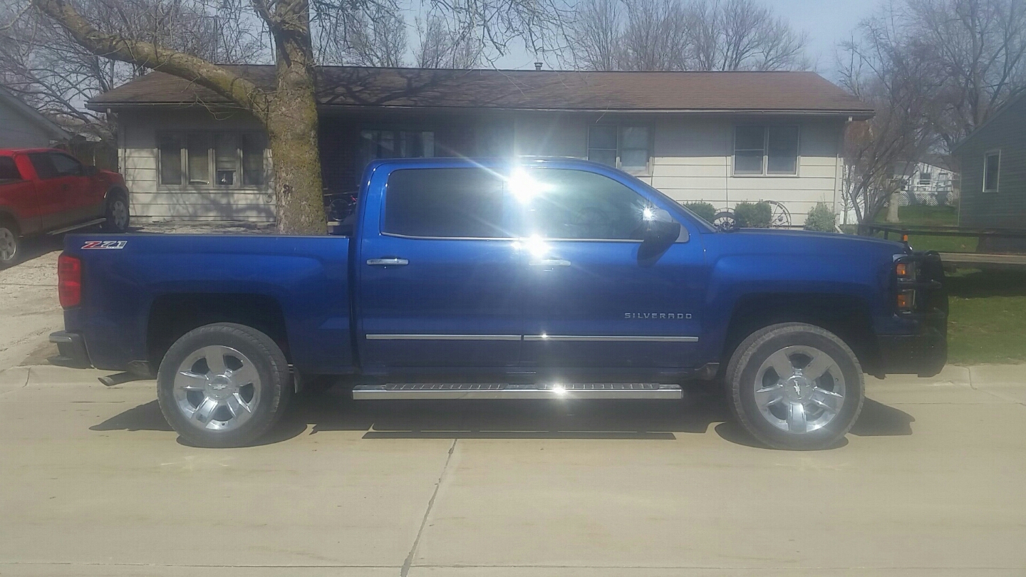

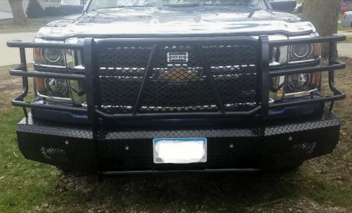

  2. I installed the 2.5" rough country level. I didnt use the rear blocks though because i have a ranch hand on my truck. It still has 1/2" rake. Looks good and havent had any issues in 500 miles. I searched through every leveling kit i could find. I only went this route to be cheap and save for either a set of king shocks or maybe go with a fab tech suspension lift with fox shocks. You might look into bilstiens 5100 height adjustable shocks. They look like a good deal for all 4 corners for just under $400. I think these silverados ride like crap so i dont think you can make it any worse. I havent actually noticed a difference in ride quality.
  3. 2.5" rough country leveling kit. Didnt use the rear block that came with it. Still has .5" rake but also has a ranch hand on the front.
  4. Purchased rough country 2.5" leveling kit today. Probably wont use rear blocks. Truck has 2.25" rake so figure after everything settles it will be dead on level or have an unnoticeable rake. Figure this will be a cheap option until i purchase king shocks all around. Will post pics after its finished.
