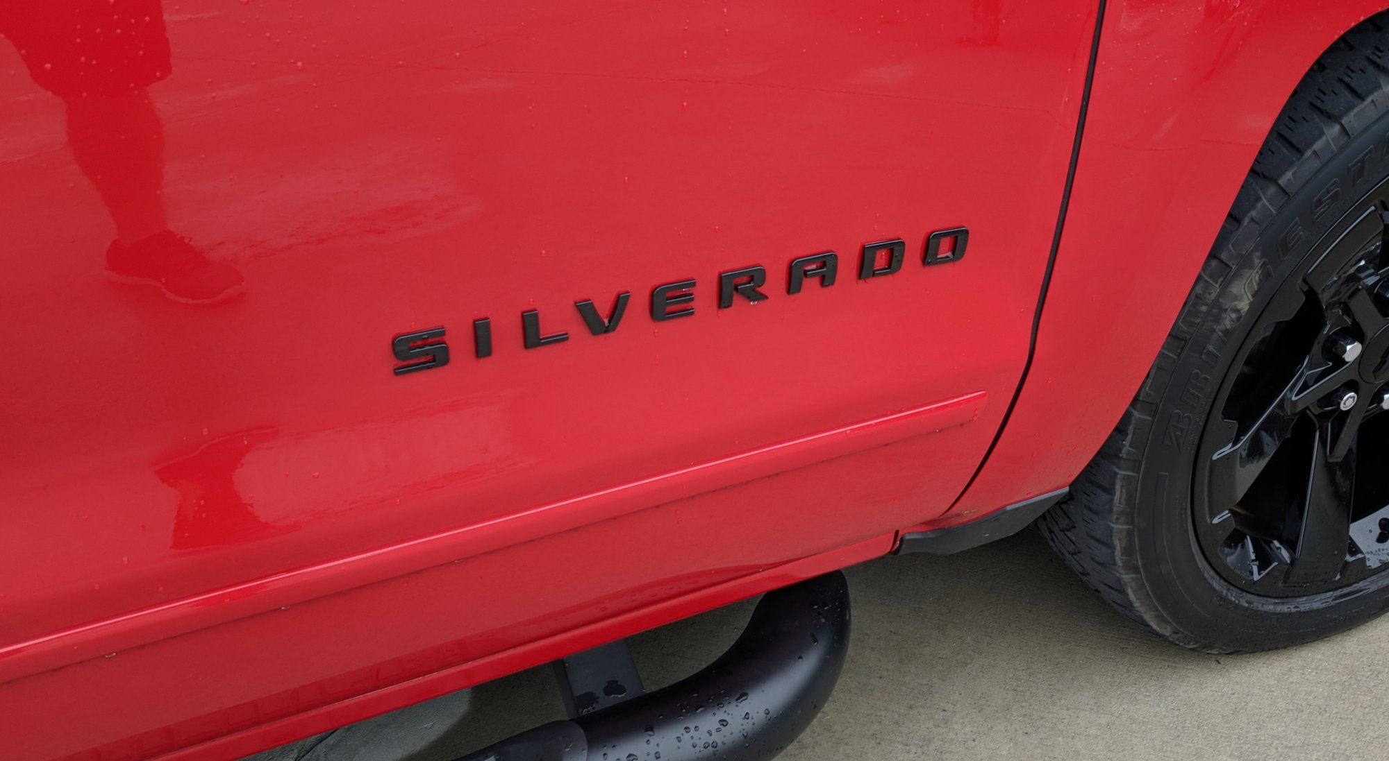

I had a shop replace the chrome emblems that come with the truck (and really look out of place on the Rally editions) with black emblems. I had a custom RALLY emblem made up to replace the LT on the tailgate. Ordered all these on eBay. The RALLY emblem was a custom that one of the sellers agreed to do for me at a very reasonable $20. The black is so much better than the chrome on this model/color scheme. Couldn't be happier with this mod. Note the lettering perfectly straight though the picture does not look like it is. Not sure if this is due to the rain or a strange picture angle or what. -

I also had that same shop replace the chrome emblems that come with the truck (and really look out of place on the Rally editions) with black emblems. I had a custom RALLY emblem made up to replace the LT on the tailgate. Ordered all these on eBay. The RALLY emblem was a custom that one of the sellers agreed to do for me at a very reasonable $20. The black is so much better than the chrome on this model/color scheme. Couldn't be happier with this mod. Note the lettering perfectly straight though the picture does not look like it is. Not sure if this is due to the rain or a strange picture angle or what. -
