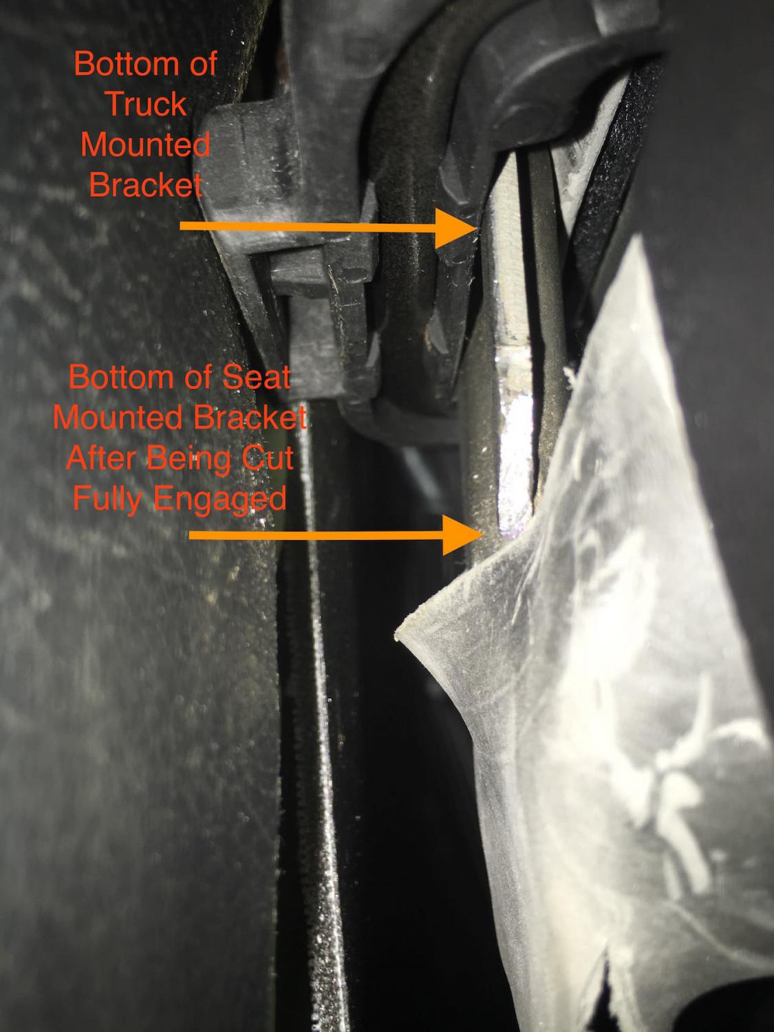

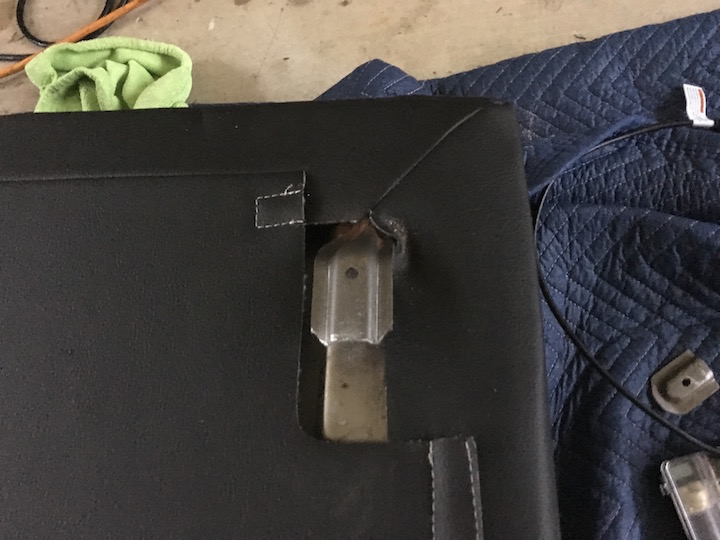

  1. I agree. I have years as an accident reconstruction expert. It would take a crash that would probably be unsurvivable before that tab could come loose with the seat down. i.e. buckling of the rear or bottom of the cab.

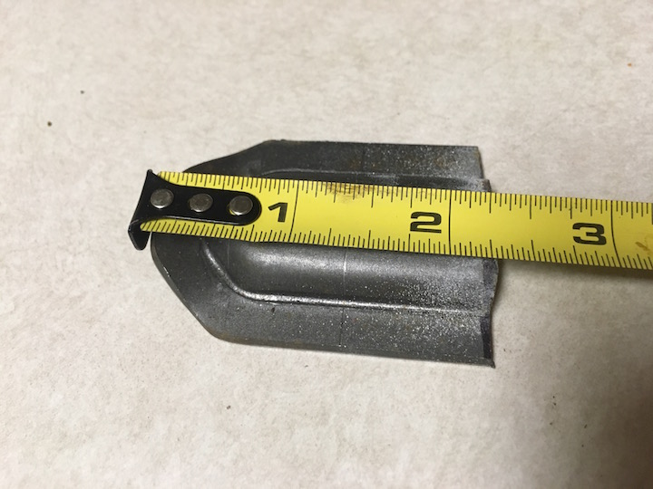

  2. I folded the bottom up then reached behind the the seat back and marked the tab. It looks to be about 2 and 5/16 inches. I would mark then cut. Not sure how standard this is. Yours may be set slightly lower or higher.

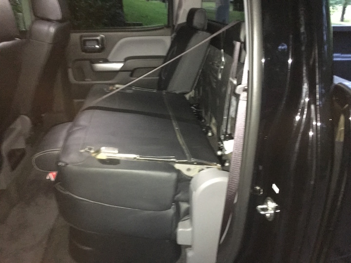

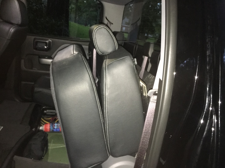

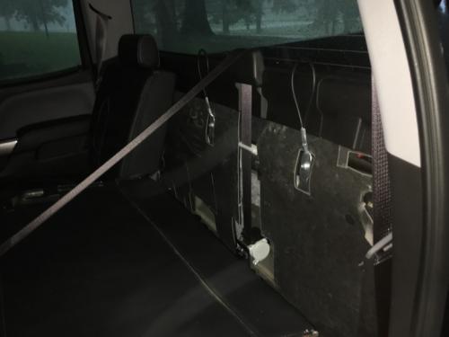

  3. Seat in normal position Seat bottom folded up. This is all that is available without the mod. Both seat an back folding forward. Seat Back folded all the way down on the seat bottom.
  4. Ok, On the new crew cabs the bottom of the seat will fold up. When this happens the back of the seat moves up but the back will not fold forward. By cutting the 2 tabs, When you fold the bottom up, it releases the tabs and allows the back to fold down allowing access behind the rear seat. I will post some pics to show you.

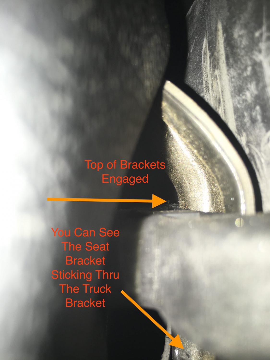

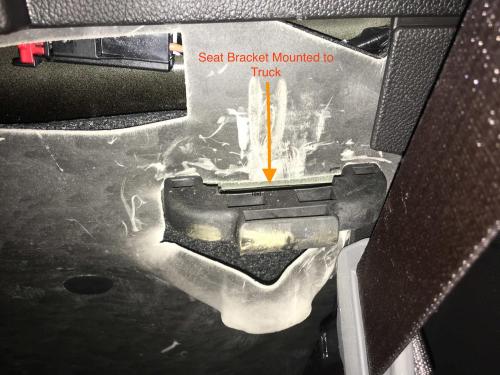

  5. No problem at all. Was not sure how secure it would be till I took the seat out and saw how everything connected. I am not the least bit concerned now. I used to work crashes for a living and nothing about this upgrade is a safety issue in my opinion. This is what the forum is for to me. Learning new things about the trucks and the back and forth discussion.
  6. Should not be an issue at all. 1. in a rear end collision the force would push the passenger further into the seat. 2. The bracket is fully engaged when the seat is down. So the same amount of metal to metal contact. 3. The seatbelts are mounted to the truck not the seat so no effect on them at all. 4. If rear seat passengers are belted this mod would have zero effect. If not belted the seat is still not going to move but they are going to be slamming the rear of the front seat. These pics were a pain to get but wanted to show that this mod is in my opinion not a safety issue. Of course everyone needs to make their own decision on something like this. But for those that are wondering here are the pics.

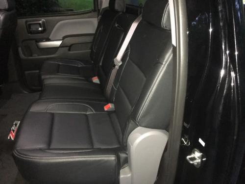

  7. Did the rear seat fold down mod. I only did the long side. May do the other side later. I have been wanting to this mod since I got the truck.

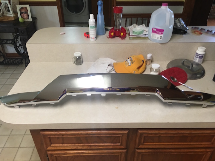

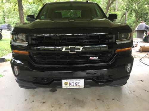

  9. Vinyl wrapped the chrome skid plate. Special thanks to Viktorrocks15 for the idea. Before After the wrap. 1st time I ever wrapped anything. It only took me 3 tries. To me the Truck looks so much better like this.
  10. My original idea was shadow chrome paint. After seeing yours I decided I wanted it black. Just ordered some gloss black vinyl wrap to try. Never used vinyl wrap before so we will see how it comes out.

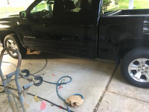

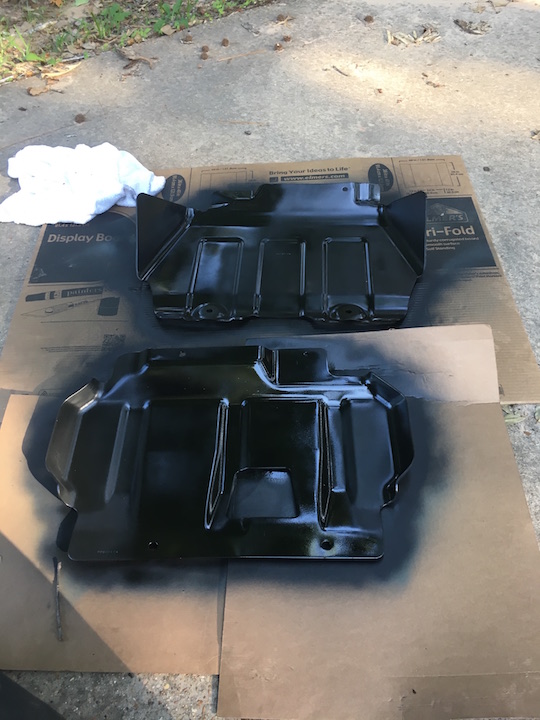

  14. Put a set of Bestop Powerboard NX automatic running boards. Also got in my new skid plates. Gave them a good vinegar and water wash. Then a few coats of self etching primer finally black epoxy paint. It was a long day. I am covered in that frame coating.
