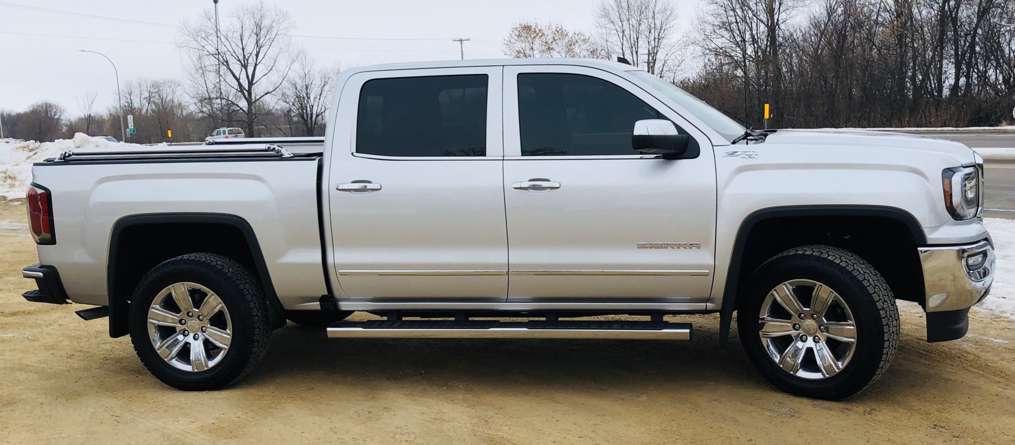

  1. I have a -16 offset 20 by 10 and a 12.5 wide tire would need some trimming. I have factory size tires with a leveling kit and I had to modify mudflap a bit.
  2. Still need to get windows tinted. Tire is Nitto RG 275/60. Wheel is Hostile Typhoon. Also did 2” level
  3. Which side wall do you have showing? Looks nice!
  4. Nice. What size you looking at? I thought a 285 50 22 would be a nice size?
  5. What tire set up is this? Toyo?

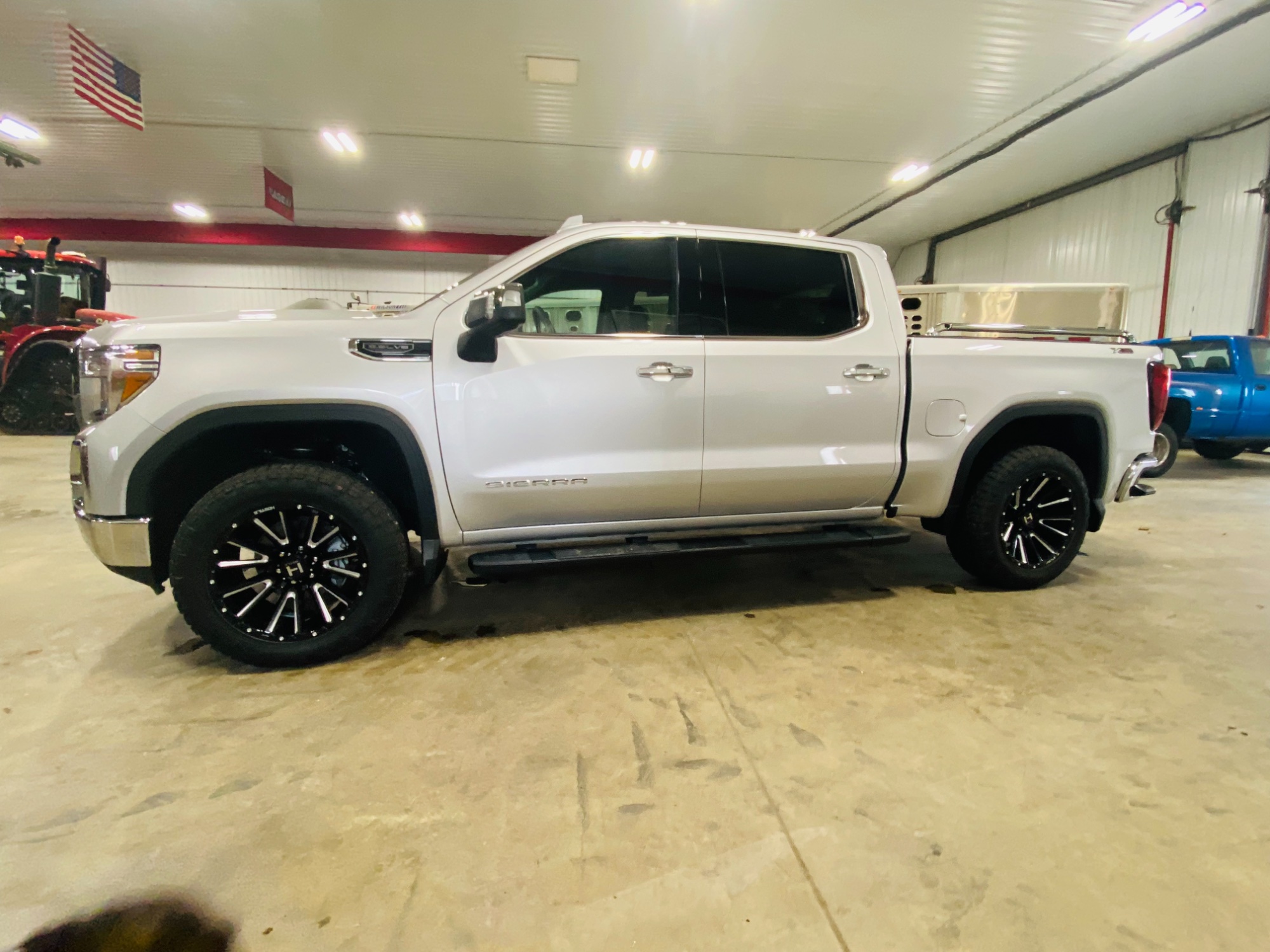

  9. Traded in an 18 Denali for this 18 SLT. Had vibration issues that they just couldn’t figure out. RC 2” level with 275 60 2 Hankook tires. Happy with the look and even happier with the ride! No more vibration!

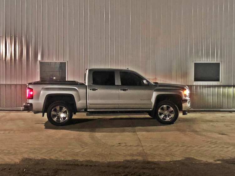

  10. Here’s my 18 SLT I picked up. Kept it simple. Did a rc 2” level and 275 60 20 Hankook tire and a little window tint! Traded in a 18 Denali that I had all sorts of vibration issues . Couldn’t be happier!
  11. Any road vibration at high speeds?
  12. Do you have any rubbing issues? I currently have a 285 55 hankook on my truck and sometimes wish I had more tire. I have 2” leveling in front. That looks really good. How does it drive at 75-80 mph?
  13. Would you go 285 60? Would you go 285 60?
  14. I’m curious if the dealer checked your front drive line? Took mine off and brought it in to a drive line place. It was so bad they couldn’t balance it. They made me a new one and all problems went away. Less than a year old.
  15. Finally got all my issues fixed. 90% of my problem was in front driveline. Brought it to a drive line place and there was a curve in it. So much so they wouldn’t balance it. (GM) says it’s within range of normal ?. Had them build me a new driveline. The other 10% were in the tires. I had 295 55 toyo. Went to a 285 55 hankook and all my problems went away! Was thankful the dealer picked up entire bill except tire exchange. Just thought I would throw it out there if anyone else comes across this. My dealer found another truck on their lot with same drive line issue after I told them about mine.
  16. Looks awesome. Any rub? How’s the ride?
  17. Honesty the dealer called me and gave me an awesome deal. I really like this body style so I thought why not have the newest in this style I could get. Now I really wish I wouldn’t have. Yes without the level everything is fine.
  18. I can’t be the only one has the vibration issue with a leveling kit out there! Like I said my ‘17 denali was perfect with a rc 2” leveling kit. My 18 denali shakes under a load. ESP in 4 wheel drive. Had rc 2.5 and currently has readylift 1.5 with factory block in back. Both have shake issues. Really regretting my good buy on the 18 now ?? I guess if there is anyone else that had this issue, I’m curious what was done if anything to fix issue. Would really hate to go back to stock
