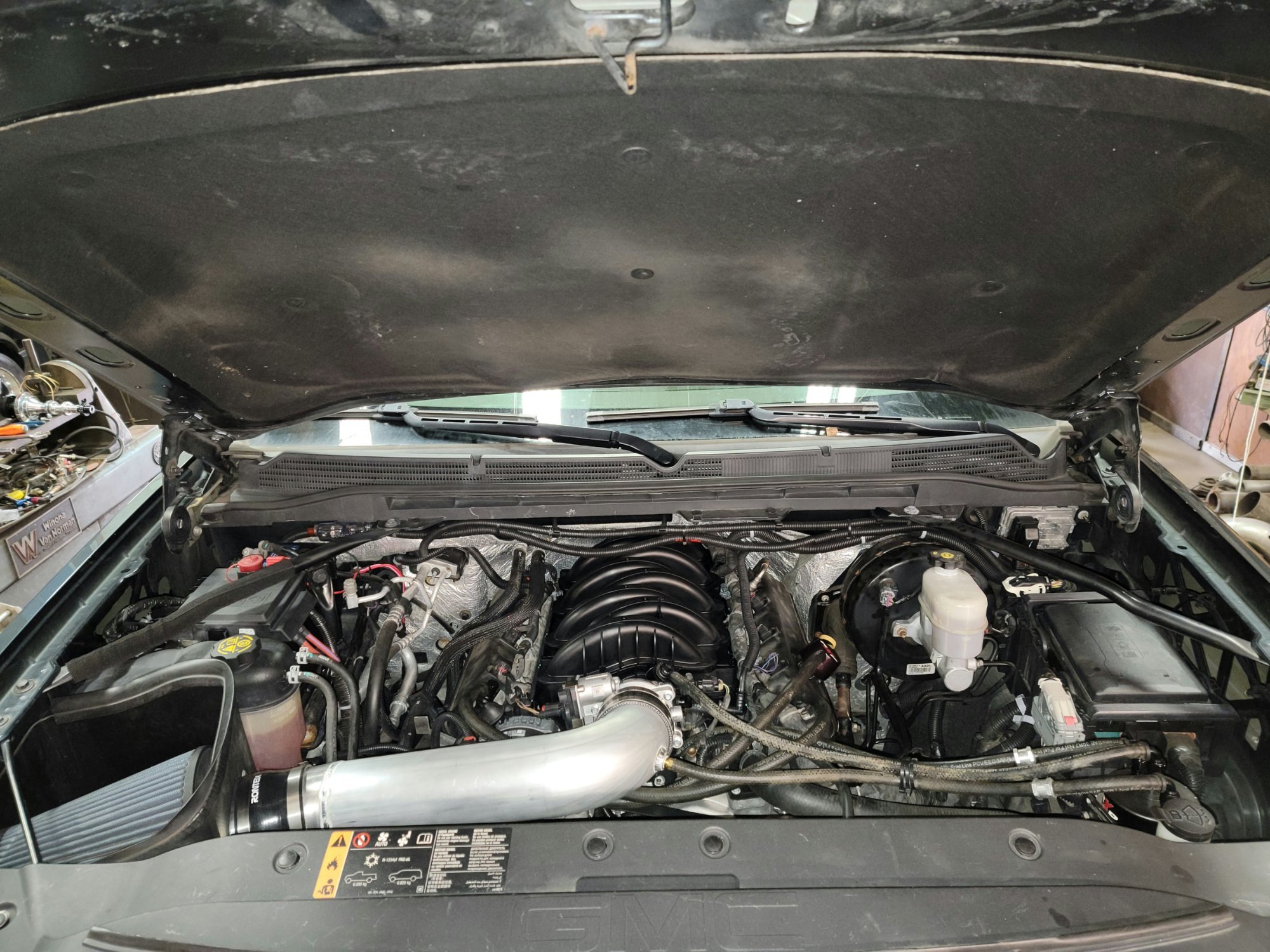

  4. @M1ck3y Still can't have my cake and eat it too. I have looked at the adapter. It's only 95mm and doesn't look like it can be ported any bigger and you also still need to relocate drive belt with Atomic. The Atomic is also ported to 103mm and necking it down to 95mm seems bad. That Katech 103mm and l86 manifold ported to the same still seems like the best option. Unless I had something professionally fabricated.
  5. I totally agree that there is some more HP on the table. I feel the same way about there not being any truck intakes being made it's depressing. All they would have to do to the MSD Atomic is get rid of the downward angle of the TB opening. I thought about pie cutting it and plastic welding it straight. A minor mod and MSD would have a whole 'nother market with the truck intakes.
  6. This guy did the porting https://instagram.com/454chuy?utm_medium=copy_link I think I'm going to send him the l86 intake I have now and have him port it for the 103mm katech I have laying around. I didn't do it before because he needed the 103mm to do the porting job. He was able to send me out an l86 ported to 95mm the next day. Tuner also said the engine was still pulling a bit of a vacuum still and could probably use a bit more air.

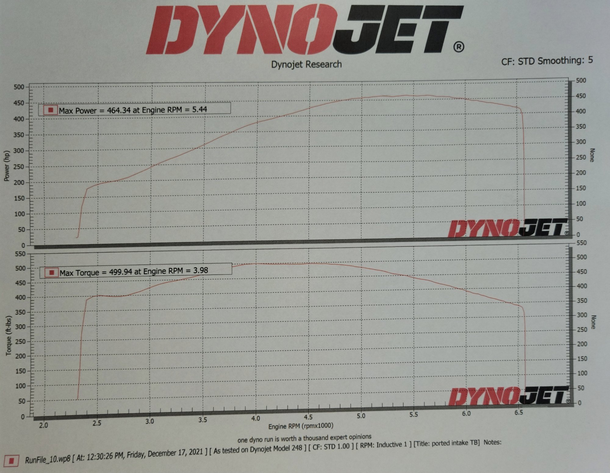

  7. First dyno result was 432hp with 87mm and stock l86 manifold. Ported manifold and 95mm was 464hp so 32hp gain. Runners were ported as well. Also added aluminum 4in intake tube.
  8. Here's the dyno chart. I will post some video in the next day or so.
  9. I was looking for that to post That was the only dyno graph I could find of my engine. It has to be damn close to the exact same specs because the compression ratio is exactly the same as mine 11.8:1. I also would have to think they are running E85 which would make a big difference, as well as the dyno exhaust and open intake tube.

  12. It's been a long ride but this week I should be picking her up from the shop. Got a fully built 416 long block from Texas Speed and performance with the EL-C7 cam. Camshaft w/ +32% Fuel Lobe: 231/240, .645/.635, 113 LSA, 109 ICL. Also put in a circle D 8L90 PRO SERIES MULTI 258MM high stall torque converter, LT4 fuel pump, LT4 injectors Tuner has it running getting around 435 rwhp with stock intake and throttlebody. I have a Katech 103mm and MSD Atomic intake but it seems like a pita to install (adding idler pulley and angled adapter. LT1 intakes are angled different). So we are going to try a stock ported l86 intake with the ZR1 95mm throttle body and hopefully that gets me some more horses. I also would really like to see the dyno charts because a stoker should pick up bunch of torque and horse power may not increase as much. I will update https://www.texas-speed.com/p-4418-tsp-416-cid-gen-5-lt1-long-block.aspx Pic was getting towed to shop on 7/22/21 with blown engine.
