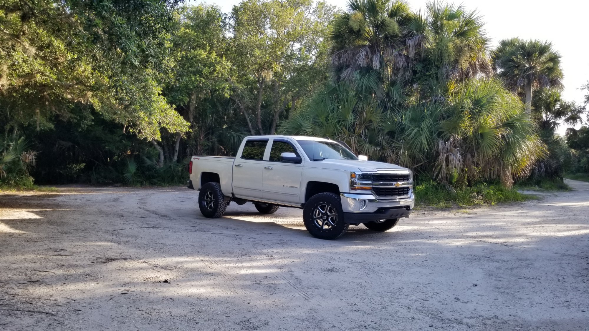

  7. My 2016 driveway build in progress... 6" fabtech with BDS 6" front struts (5" lift in front to keep factory rake). 20x9 hostile rims with 35x12.50 nittos. Cai, black widow race venom muffler and blackbear tune.
