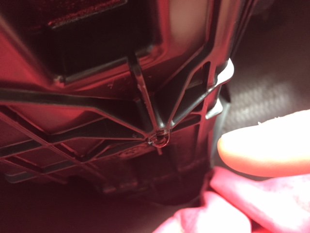

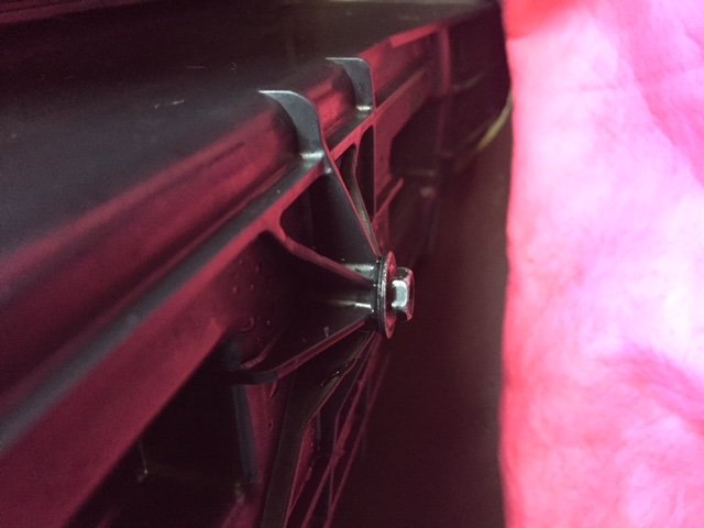

  2. Back when I replaced my blower motor it turns out that I installed all but one bolt that mates the cover under your dash (the one that covers up all of your HVAC components) to the HVAC box that houses the evaporator coils. I just had an epiphany on Friday and screwed in this bolt to that hole you see in the first picture where the leak was coming from and wa-la no more leak to this day. I was so happy that I fixed this, but also felt like a jacka**.

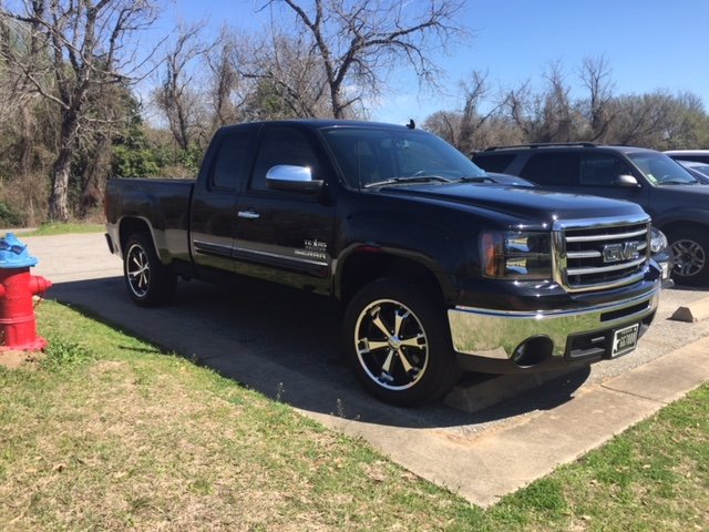

  8. Second picture you can see me pointing to the water drip when my truck has actually been off for hours. When it is on though and the a/c is running this drip is pretty darn steady at times.

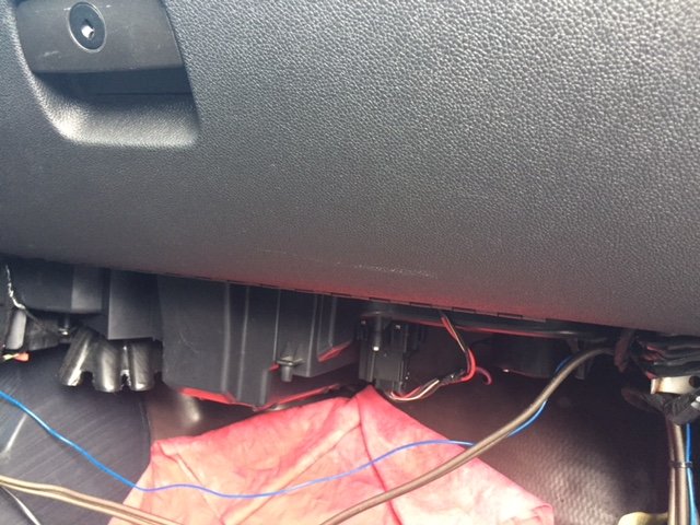

  9. A few weeks ago my truck began leaking water (not coolant) underneath the dashboard on the passenger side. I have exhausted myself researching what the issue could be and have tried all methods suggested to unclog the drain pipe if it was indeed clogged. I even purchased a new L shaped drain tube and installed it. The a/c blows cold and works fine it just leaks like crazy inside and out. I understand it is supposed to drip on the outside, but not the inside too and not at the rate it is dripping at. I am so hard headed that I refuse to pay the dealership god knows how much to fix this because in my mind this has to be something silly that I should be able to tackle. I would really appreciate anyone's thoughts or guidance as I am tired of rolling around with my carpet peeled back and a towel under the dash to soak up the water that is dripping. My truck is a 2011 GMC Sierra!
