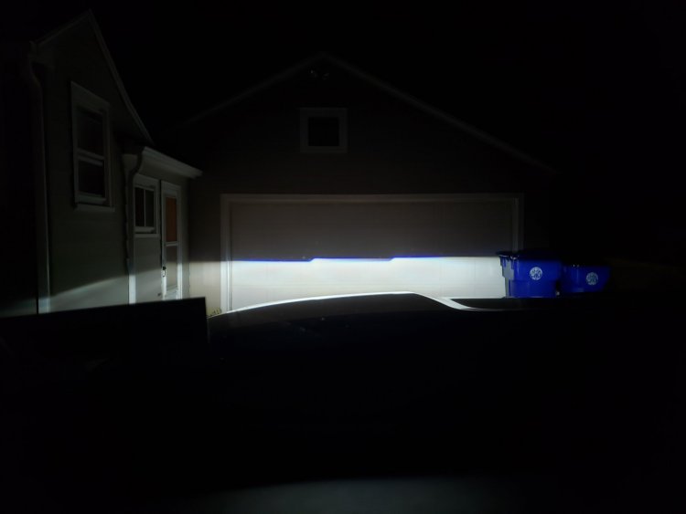

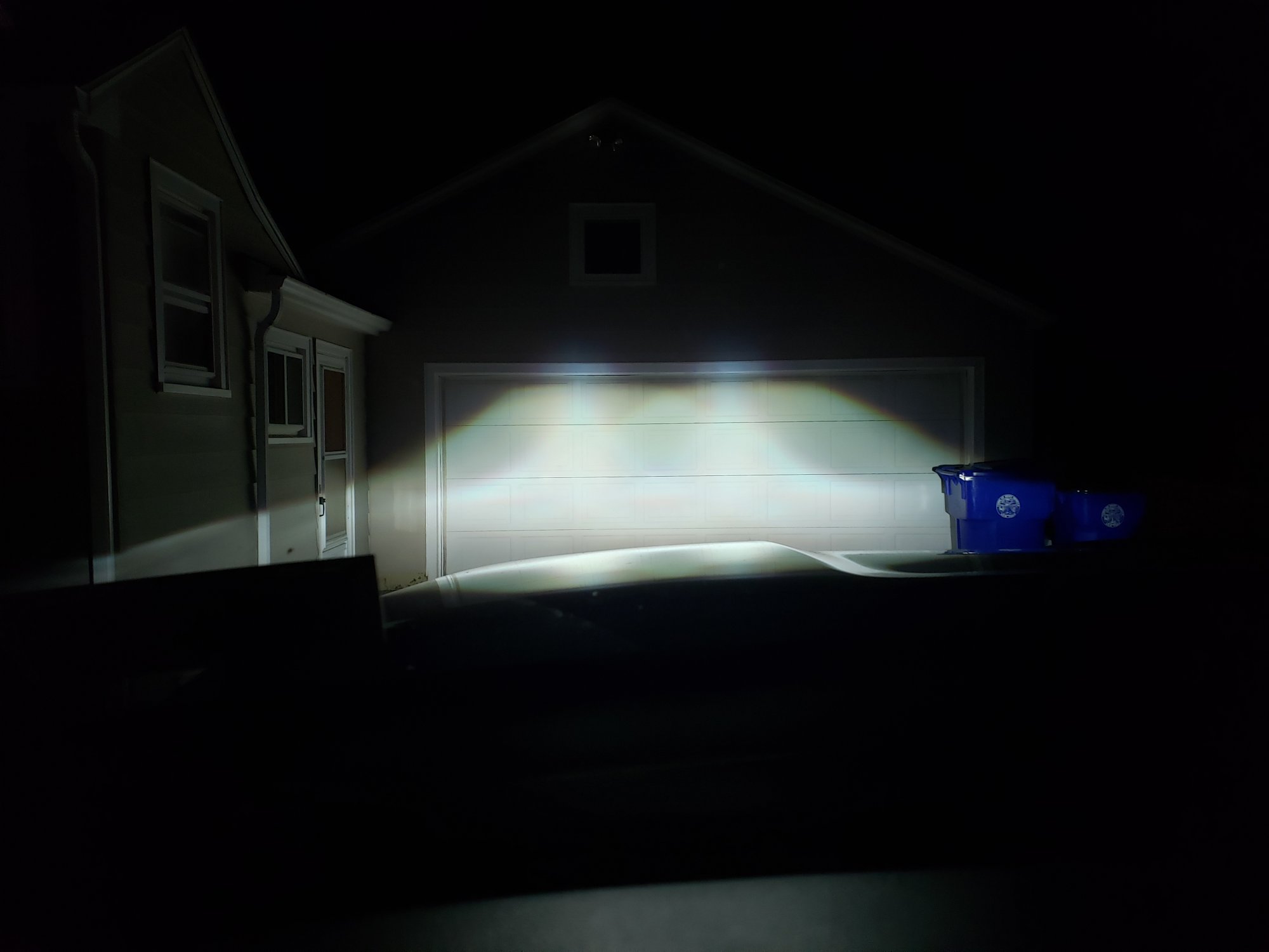

  1. I got everything from Lightwerkz a few months ago but just did the install over the weekend.
  2. My 2015 Sierra. G5-R, CBI, Hylux 35watt. When you attach the bracket to the headlight there is a little play with the screw holes so my drivers side seems like it has to be rotated counter clockwise a little bit. Over all the light output is amazing. CBI's are a little warmer than my morimoto fogs, CBB's would probably match a little better. 25ft from garage door

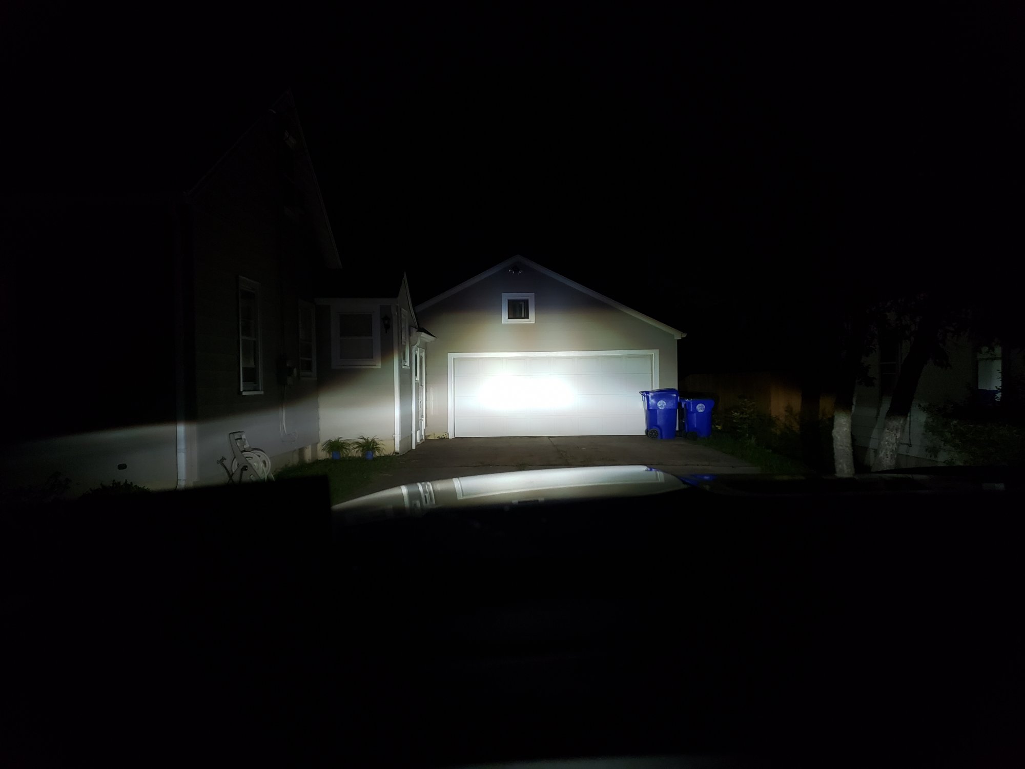

  4. Quick review on on morimoto fogs and drop in HID's. I'm using hylux ballast with morimoto 5500K bulbs. The hylux ballast are top quality, my only complaint is the canbus module is kinda big and make mounting a little awkward but 3m self stick Velcro works great for install. The morimoto bulbs came with an extremely ugly brown/tan grommet. I don't know what they were thinking, I opened the box and said WTF is this. Asked retrofit source about it and they said that's how they come now. I also had an issue with one of the connectors not holding the pins securely but was able to fix that. The fog lights are nice, little hard to get them to "click" back in but nice wide output. Color wise they do look whiter than the 5500K bulbs. Output of the factory projectors with the hid bulbs is much better than stock. Best way to describe is like comparing a candle to a flash light. If you been on the fence about doing it have no fear you wont be disappointed. I do have a set of g5-r projectors waiting for me to find the time to install them so im excited to see how they do.
