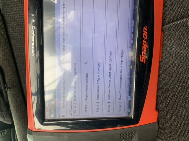

  3. pulled these codes today. Can anyone help me get started on diagnosing/fixing these issues. I picked up a knock sensor, knock sensor wiring harness, and new intake manifold gaskets which I plan to replace tomorrow.
