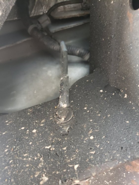

  5. Hello everyone, I have a 2017 Silverado 1500 LT Z71 with a leveling kit and 33x12 wheels. So I've been dealing with the problem of my truck shutting off when parallel parking and for the first time it shut off while making a right turn after a stop. Sometimes I'll start my truck and the problem will happen. In each of these times the "service stabilitrak" message comes on and my steering wheel flings to center itself and my truck shuts off. It has always started right back up after a few minutes. I also have a steering assist is reduced message but my steering has been feeling perfectly fine. I've been researching this problem for a while now and so far I have: checked the ground under the dash (G218) and there was no insulation present there ( i believe GM fixed this problem). I cleaned the ground behind the passenger wheel and even went as far as to change the entire negative cable. My ABS wiring was messed up from rubbing on the control arm which i fixed as well and no longer rubs. Even though i dont have a check engine light on i ran a scan and the code P10E4 came up as a possible issue, but after work i ran the scan again and the code disappeared without clearing it or anything. If anyone has some type of advice or direction it would be greatly appreciated!
  6. Update: Ended up seeing people talk about the grounds on this truck causing this problem to happen. Ended up checking the ground right behind the passenger side tire and it was caked with grease and dirt.(As seen in photo, if it works lol) Cleaned up the whole area, sanded and wire brushed it all and put the screw back on with dielectric grease and some undercoating spray over it. Haven't had the problem come back again yet. I just put some new tires and rims on so I had to remove the factory mud flap, as well as do a norcal mod and such, so that probably exposed the ground even more. Hopefully this will hold, otherwise I'll relocate the ground.
