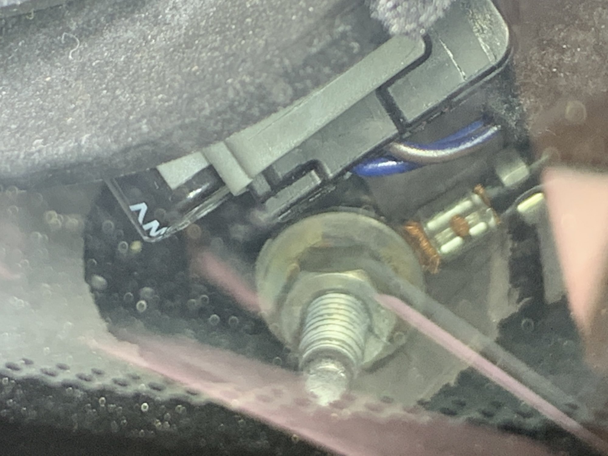

  1. It is just a little plastic piece that runs a harness over the ground. I’m sure it’ll be fine. Probably just for assembly/ rubbing reasons.
  2. Well taking the dash apart was very fast and easy less than 5 minutes. Now getting to the ground is another story it’s in an awful spot and but I finally got to it. And yup the plastic was pinched right there. I had to use a shallow well 10mm a universal and a few extensions but I got it off and trimmed. I’m just realizing I forgot to put a harness clip back on that ground but oh well.

  5. I'll pull the dash one G218 this week or weekend. looks to be like a 10 minute job to get to it.

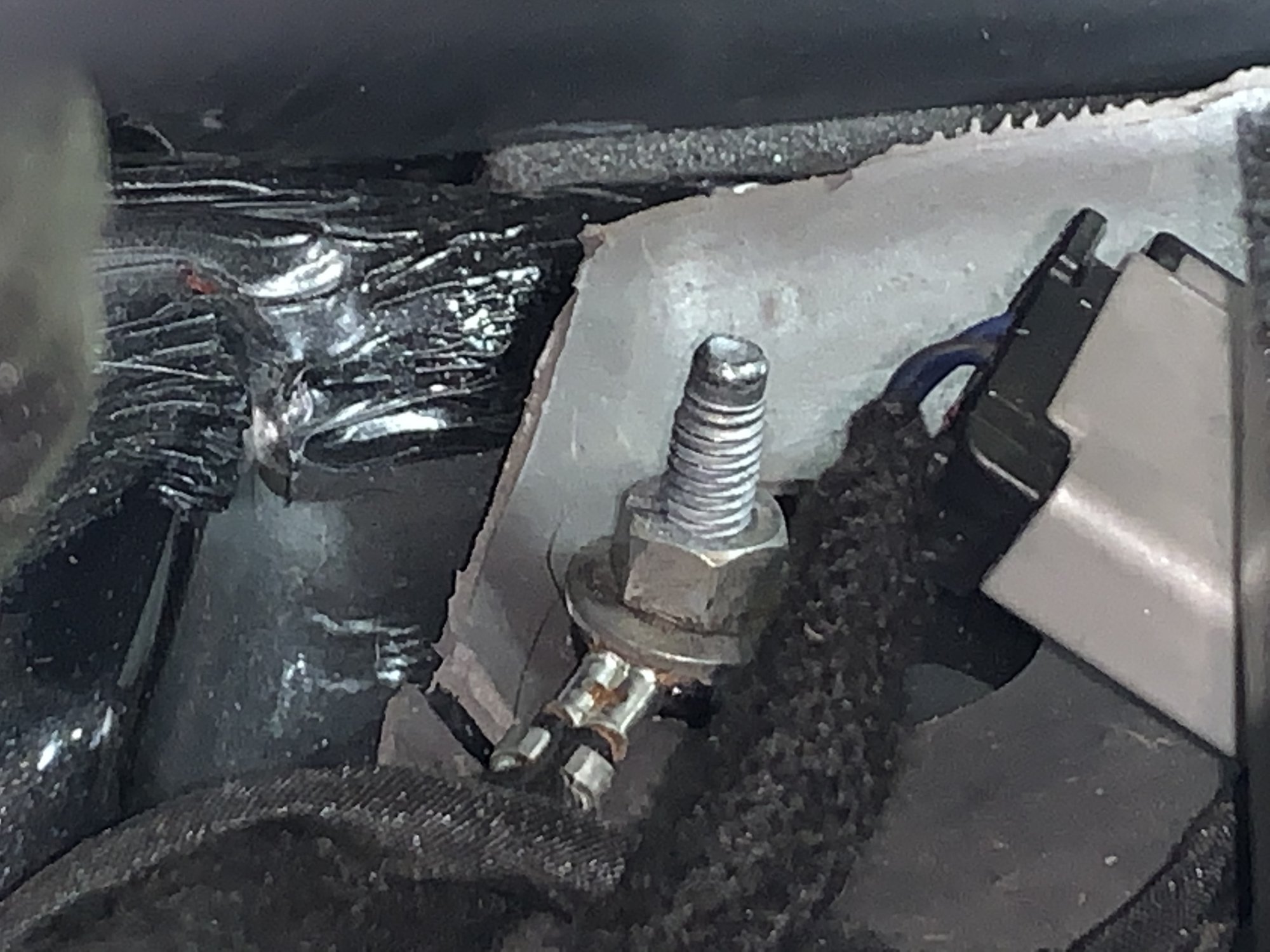

  6. This ground is in the passenger side wheel well. You do not need to remove the fender liner to get to it. I used a wire wheel and adhesive remover. I cleaned it up pretty well when I was done. But you can see that something may have been going on with the ground itself. The other runs to the back of the engine block and looked fine. I may do what someone else did and add another ground to to brake booster. I have not pulled the dash apart yet for the BCM ground. That will be my next step.

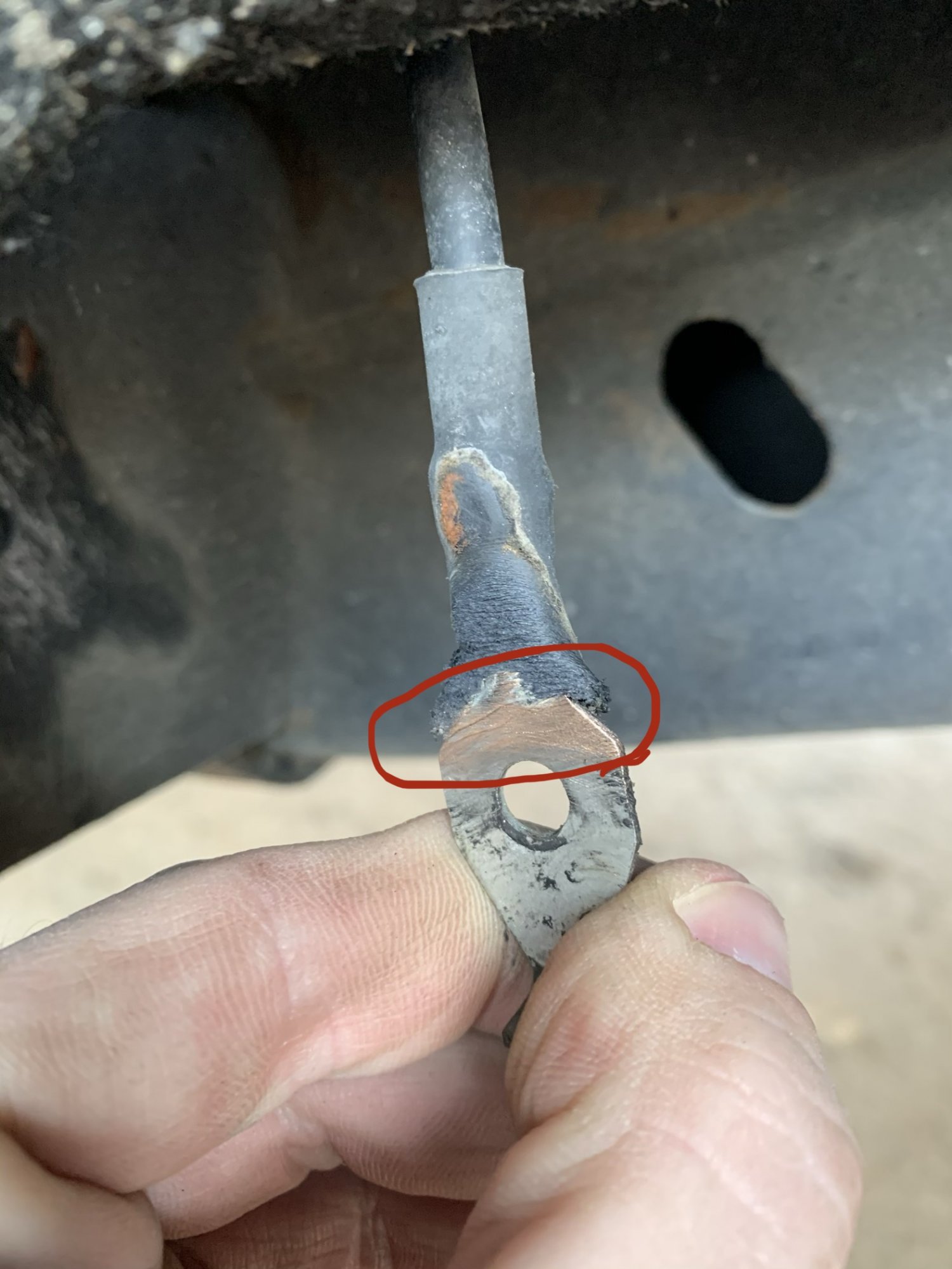

  7. Alright. So I couldn’t do my push to start last night. The screw on the terminal was so rusted it was going to break off the terminal so I didn’t go for it. I took the wheel off the fender flare and the fender liner. The command terminal on the starter solenoid wiggles a bit so I wonder if something internally is broken. I ran a zip tie to hold it tight for now, if it holds. The starter looks like a massive pain in the ass to do. What I did find was a rough looking main ground from the batteryZ the rubber coating came down half the terminal I circled how far it came down and then there was a ton of under coating under the terminal itself. I took a pic half way through cleaning the ground up. The red circle is how far the wire coating covered up the terminal.
