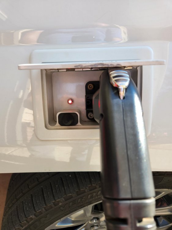

Hope you have luck with this. My truck had a charging fault this week. This has been resolved in the past by cleaning the leads on the plug or blowing out my charging cable since my truck sits outside year round. While checking some fuses and relays in the hybrid fuse panel, I managed to disable the driver mode of the truck. Travis sent me document to troubleshoot the charging fault and that appears to be a resistor on the charging plug has gone bad. He hasn't been able to provide guidance on the drive enabler issue yet. -

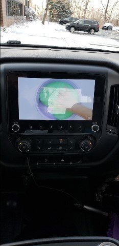

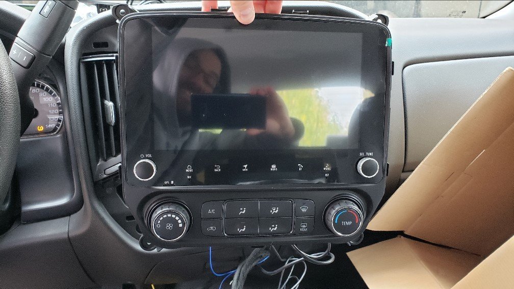

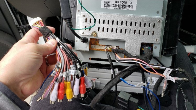

Because the truck is just a w/t, there's almost no options on it. It has basic power options and cruise control, but aside from the G80 rear axle, nothing else. This meant the radio was awful. I wanted a tesla screen, but the little things about it were bugging me. Because I don't have dual climate control or heated seats, I didn't really need either of them to be digital. I also hated the fact that the screen moved the volume to the passenger side. Then, the price was just so much. Instead, I shopped on Ali Express and came across this: https://www.aliexpress.com/item/4000922321153.html?spm=a2g0o.order_list.0.0.21ef18025RP3MO This got me a 10" screen and Android Auto while maintaining a factory look. I also changed out all the door speakers for some Rockford Fosgate R165X3, then some Kenwood dash speakers (KFC-X2C), and added an Infinity basslink under the center front seat. The screen is an Android tablet, so if you don't want to use carplay, you can hotspot it off your phone to do standard internet things (youtube, netflix, etc). Pointless things for myself when I'm driving, but super great when I have the kids in the truck. The sound is probably on par with a factory Bose setup, but I listen to audiobooks most days now so it's good enough. I have about a thousand dollars into the whole stereo at this point. The next thing I need to install is this 360 degree camera. I'll post that after it gets installed. https://www.aliexpress.com/item/1005001419631649.html?spm=a2g0o.order_list.0.0.21ef1802t7da91

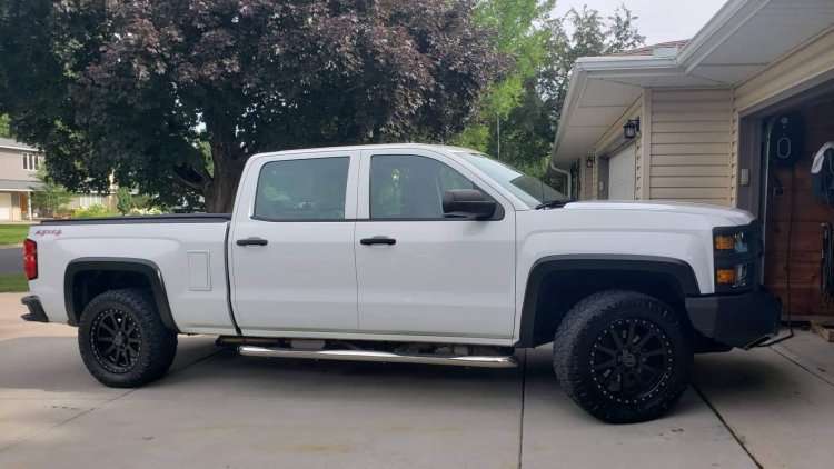

Hi guys, If you saw the title and were wondering wth a Vtrux is, please see my intro thread here: Short story is the truck is a Silverado that's been converted to a plug-in hybrid. It operates similarly to a Chevy Volt. I bought it on a whim because it was cheap and good on gas (my best mpg so far is 119mpg!). This thread is my documentation of my modifications and likely weird issues I'll likely have with this thing. This is how I bought it. A 2014 CCSB with 17k miles on it. Leveling kit, 33" Nittos on Black Rhino wheels, and a Smittybilt bumper. Great looking truck, but the big tires aren't great for EV range and I really like the look of a lowered truck. I installed an IHC 3/5 kit that's a flip kit and control arms. I wish I could've gone lower, but the battery pack and its housing (roll cage I guess?) sit so far down that I'm already 3.5" off the ground as it is. Here is the truck now: And this is a mini can, so Just over 3.5" to the 2"x4" steel tubing around the battery pack. If you're wondering, I have bottomed out on this a few times, but nothing I've worried about. You get used to it with lowered vehicles. I'm slowly changing things on the truck and will update this post accordingly. Regards, Slim
