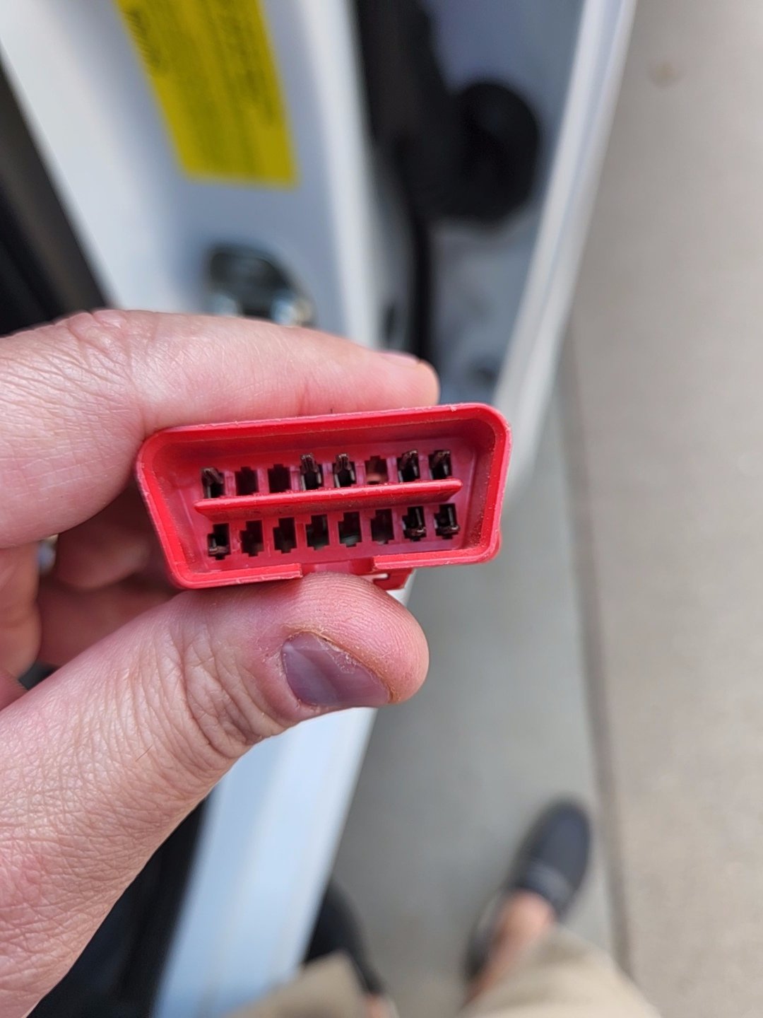

I know we talked offline about getting the scanner on ebay. https://www.ebay.com/itm/296191031859?mkcid=16&mkevt=1&mkrid=711-127632-2357-0&ssspo=wqii6h_vrto&sssrc=4429486&ssuid=kA-lrmBkQD-&var=&widget_ver=artemis&media=COPY I went through my old photos and found pictures of the pinouts, so hopefully that can help. Slim -

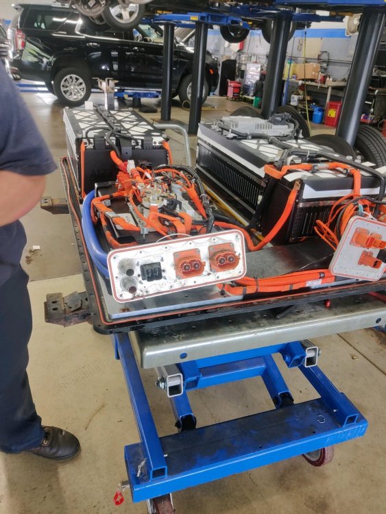

Here's a link to the battery removal procedure: https://docs.google.com/presentation/d/1XXZV49iR-8I96M1XYJ9f6kRRpwb7QzyG/edit?usp=drivesdk&ouid=115164390539392329881&rtpof=true&sd=true Getting the right to repair this was more work than I anticipated. Via Motors even had the dealership sign a liability release form before providing the procedure. The dealer's tech had no problem with the repair. There was moisture in the battery pack with is common in a high moisture climates. It probably doesn't help that I love puddle jumping during the winter thaw here in MN, so I'll have to dial that back. Via suggested to clean the o-ring and it's groove. There was corrosion on the top of the battery hold down plates, but nothing to worry about on the batteries themselves. Because there's no book time available for my truck, the dealership had to charge straight time of $175 for the 1st hour, then $230 after that. My buddy is a service writer there and only charged me $175/hr for the entire repair. They also only charged me 11 out of the 14 hours it really took. Total bill at the dealer was just shy of $2k. Add the parts and rental of the Via scanner brings the total for this repair to around $3k. Not cheap, but I knew this was the risk when I purchased this truck. The concern at this point is there's a yellow triangle warning light on now which indicates something is still wrong with the hybrid system. There's also 2 weird noises when the generator (the gas engine) is running. The truck drove home 25 miles without issue though, so I'm just going to see what happens at this point and hope the issues self resolve . Thanks to everyone for following along and adding information along the way. Slim -

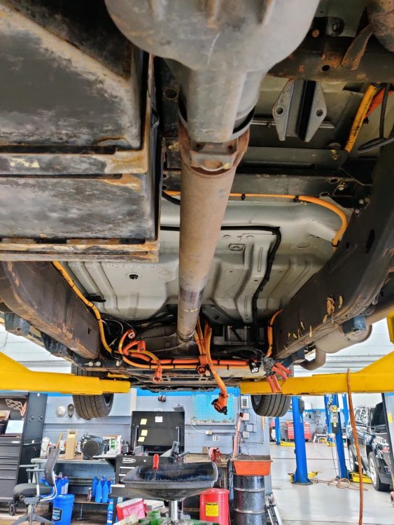

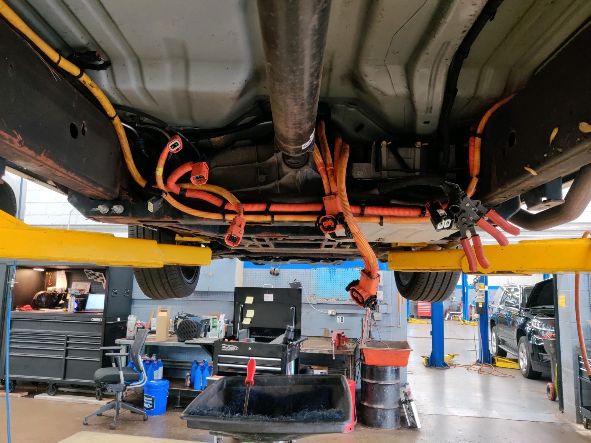

Apparently the truck was too heavy for the lift in the EV tech's bay, so they had to move it into a diesel bay with higher capacity lifts. Here's some pictures of the repair: -

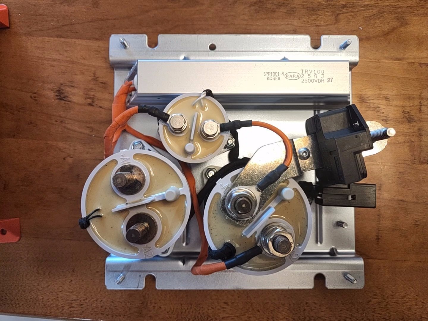

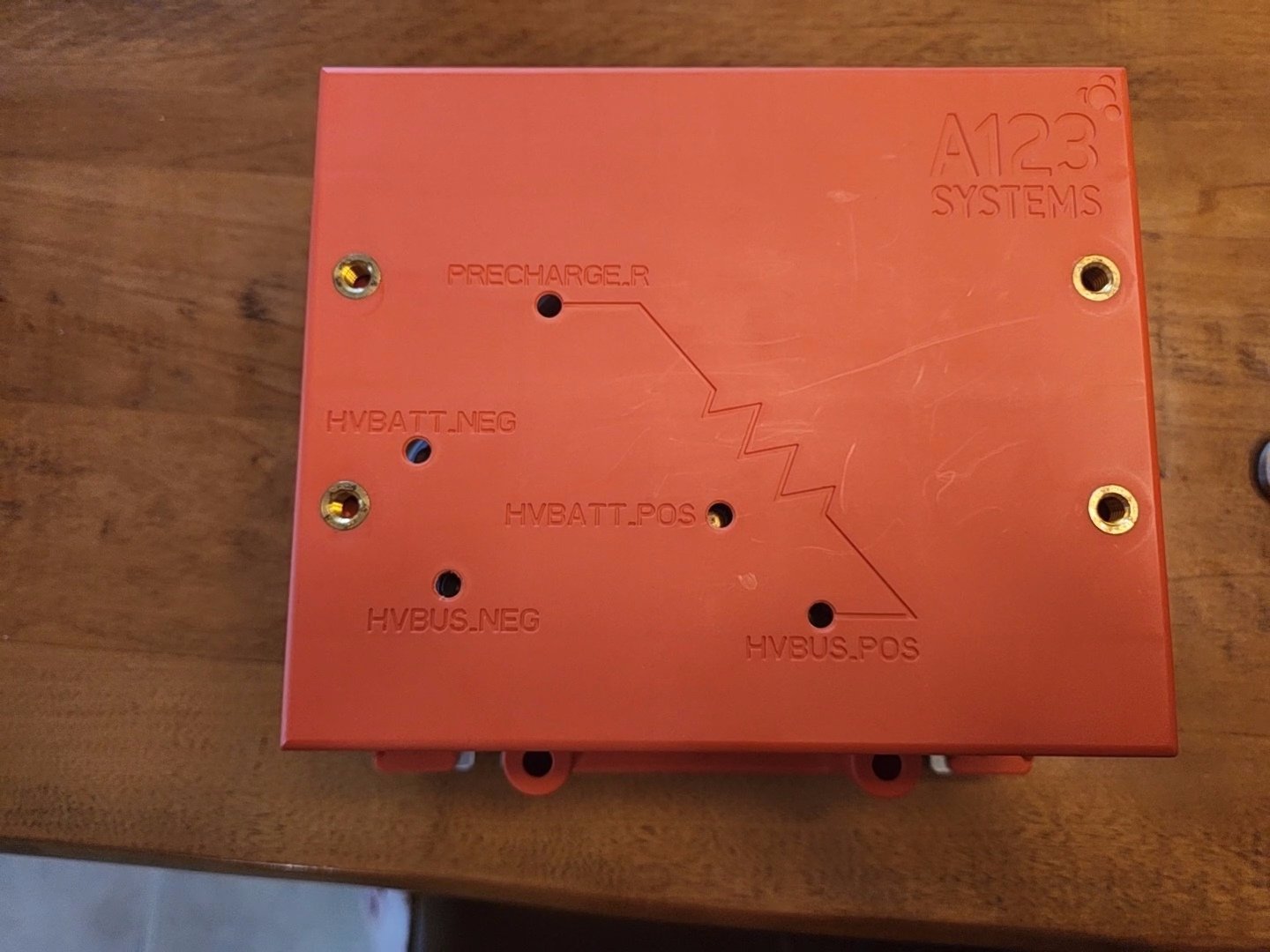

Yes and it also shows that contactor bundle as well. I think it's a great tool to visualize how everything in the pack is put together. -

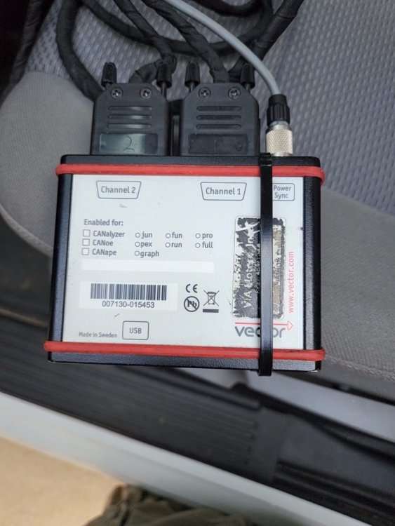

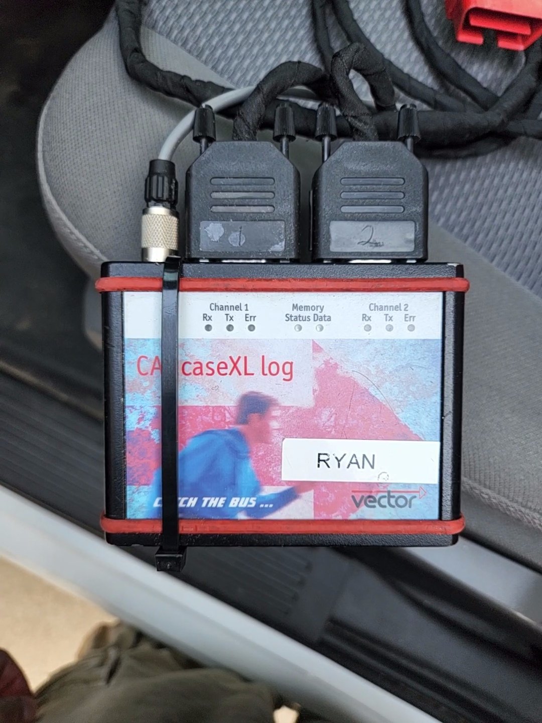

Charge System Inspection (Truck).pdf This is the procedure Via Motors sent me to troubleshoot the charging fault at first. When everything looked good according to this, the rented me their data logger. This plugs into the white ODB2 plug (this is under the gm ODB2 plug).
