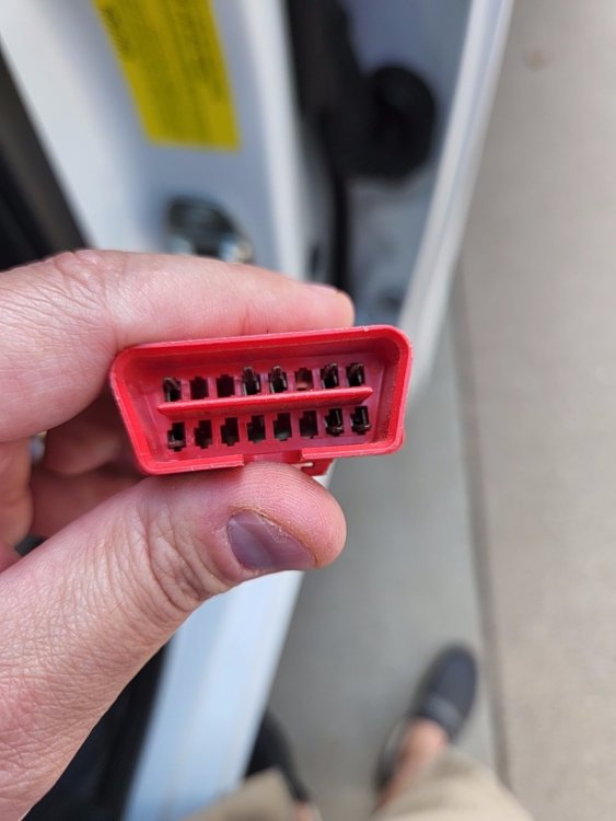

  4. I know we talked offline about getting the scanner on ebay. https://www.ebay.com/itm/296191031859?mkcid=16&mkevt=1&mkrid=711-127632-2357-0&ssspo=wqii6h_vrto&sssrc=4429486&ssuid=kA-lrmBkQD-&var=&widget_ver=artemis&media=COPY I went through my old photos and found pictures of the pinouts, so hopefully that can help. Slim
