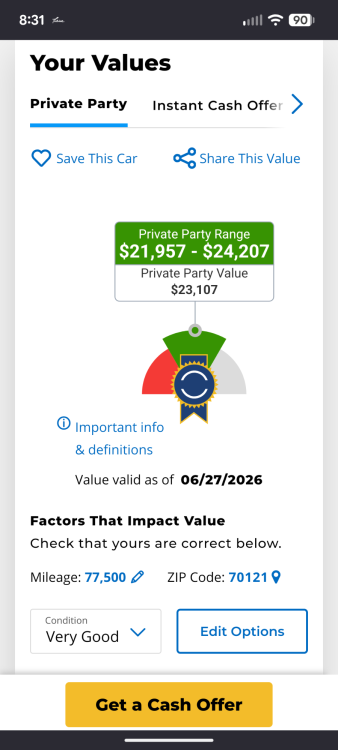

  2. The truck had about 10,000 miles on it when I purchased it in the fall of 2020 for about $31000. KBB seems to think it's worth between $20 and $25k now, assuming a good transmission.
