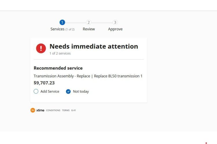

  5. I wonder as well, why they would send me a text message with links to these suggested procedures totalling over $10,000 without even the slightest hint of how they arrived at these being necessary.

  7. Thanks! I'll ask for that. What's the acronym for?
