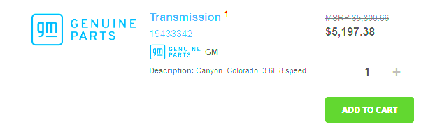

I wonder as well, why they would send me a text message with links to these suggested procedures totalling over $10,000 without even the slightest hint of how they arrived at these being necessary.
$10,000 for a transmission?
Pretty sure I could buy all the parts, tools, and education to rebuild it myself for a quarter of that amount.
or swap it out with a new one...
OP's quote is parts and labor.  Not just parts.
The # you found isn't the right one.  But besides that, the right # is the same price within a couple bucks.  $5802.01.
Now, factor in labor and fluids.  Book time is 17.1 hours for a Colorado 8 speed.  At $200/hr for a dealer average rate, its $3420 just in labor.  We are already at $9222.  Fluid and other necessary items, there's your $400-500 more.
Also.  Your "discounted" transmission.  Which is 99% likely quoted off of GM Parts Direct as that's the MSRP I found on their site.
You failed to note the $597 in shipping charges.  So we are right back almost to MSRP.  $5794.  Oh.  AND, you better have the $4000 for the core charge which you'd have to pay and get refunded, AND you gotta pay to SHIP THE CORE BACK.
So now you'd have paid MORE to buy that one online yourself, just for the transmission, even after you get your core refunded.
