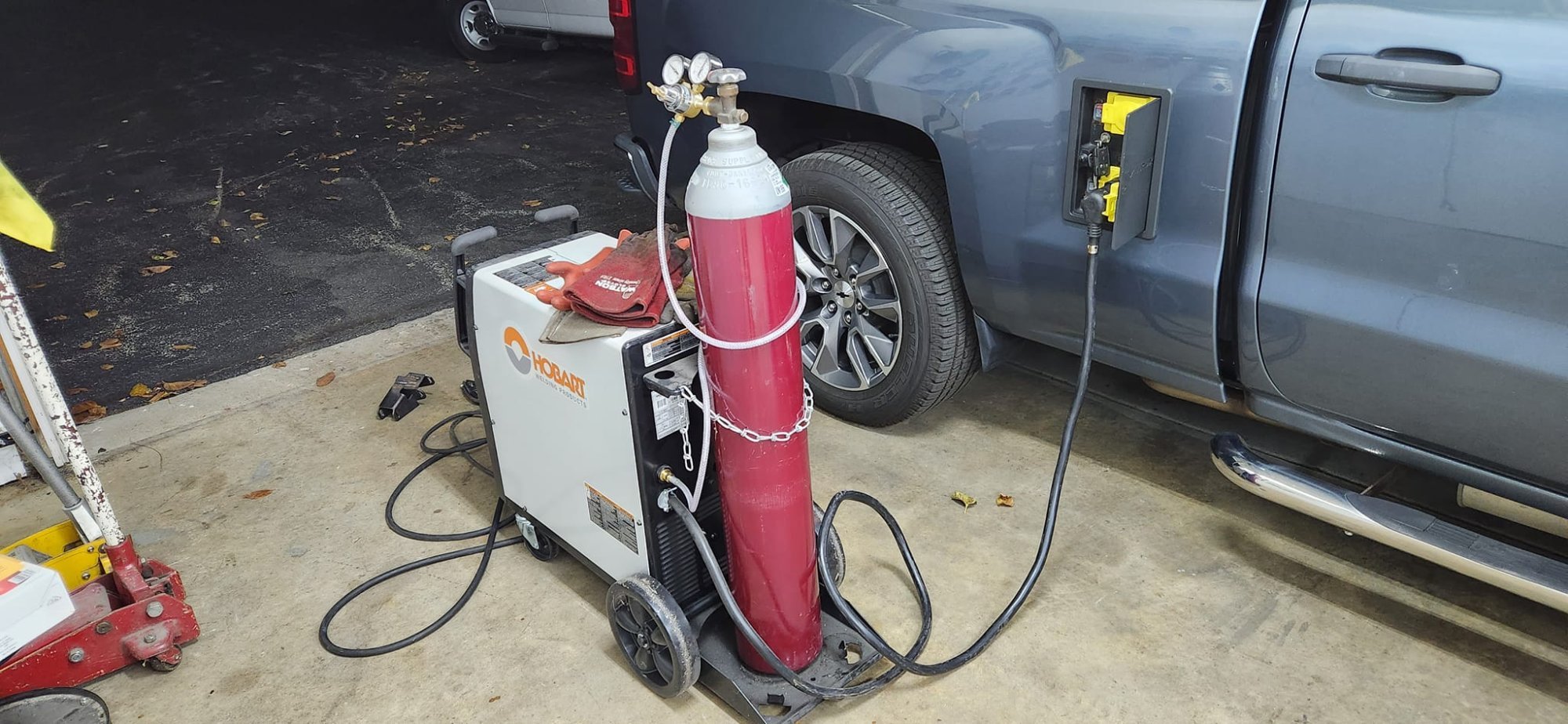

  1. Just to follow up on things - After a few charges all systems seem to be normal. The light will show solid green when charged. As Jim explained, it will not always charge fully if you are not driving the truck much. Every 5 days it will want to kick in the generator to purge the evap system and will not charge any higher than 2/3. However, if go for a drive and charge it after this it will charge fully. A bit concerning at first glance but normal operation. This is certainly an interesting truck. Have been putting a few miles on it. Cleaned it up with a new set of wheels and tires off of a 2022 Silverado. Even tried out the export panel with my welder, pretty cool.

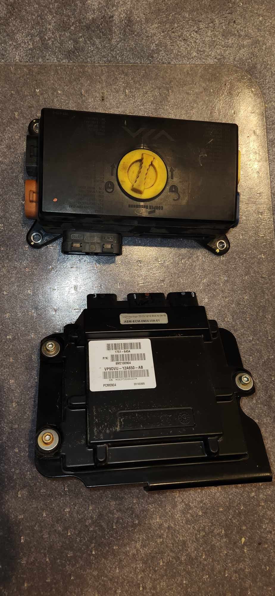

  4. I have the Distribution box and HCU out of the Van if you would like them to test. I am not sure if the programming is the same for the van and truck. Send me a PM if interested.

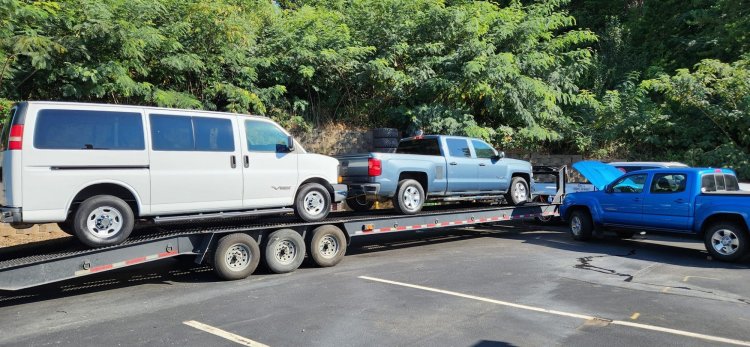

  6. I recently purchased a 2014 VTRUX Silverado and Express as a package deal. These are very interesting vehicles and this thread has been very helpful to me - Thank you everyone! My truck is not white, which appears to be somewhat rare. It is a LT Z71. When purchased, both vehicles were inoperable. The van was complete, but had a fault in the battery pack. It may be the contactor, may be a dead cell. I am not very concerned as I plan to convert the Van back to gas. The truck was incomplete. It appears the bidirectional charger was stolen and the MSD was missing. I took these parts off the van and got the truck driving, albeit with issues. The vaccum pump was dead and the electronics coolant pump was full of dexcool sludge. I replaced both of those as well. The truck is still having issues. If I drive it 5-10 miles the system temperature on the dash goes into the red, the engine revs to redline and the truck loses power. I read this could be due to a dead generator ATF pump, but it appears to be working, I can hear it running. There is also the exclamation mark light on the dash. I think at this point I will try to reach out to VIA to try and do diagnostics on the EV side. I see in this thread they have lent out their proprietary tool before. I am happy I brought it back to life, but it is not yet something that can drive farther than the neighborhood.
