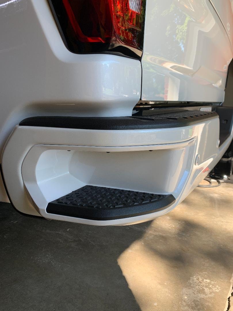

  3. Nothing is staying chrome! just a ton of parts once everything is disassembled. A far as the mirrors i would paint it all. Once you get them taken apart you'll notice they actually move out, slide, then retract back in. The bed steps come off without removal of anything else. Pop the pad off and you have 3 torx up top, couple under the pad, and a couple on the backside.

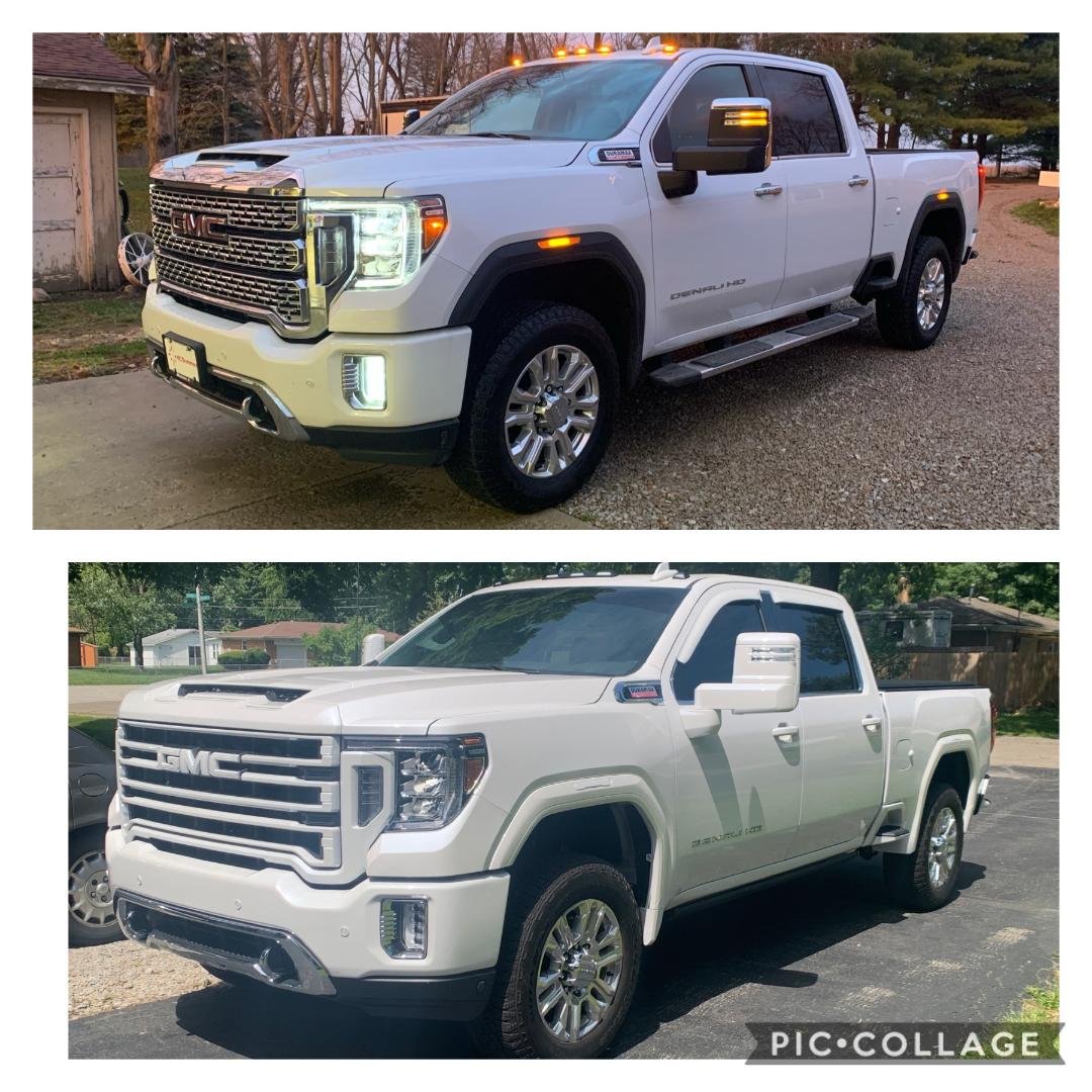

  4. currently paint matching everything chrome or black. ditched the denali grille for the At4. Gave it some amp steps and removed all the emblems on the tailgate. leveled with keys and upper control arms. getting ready for some forged wheels!
