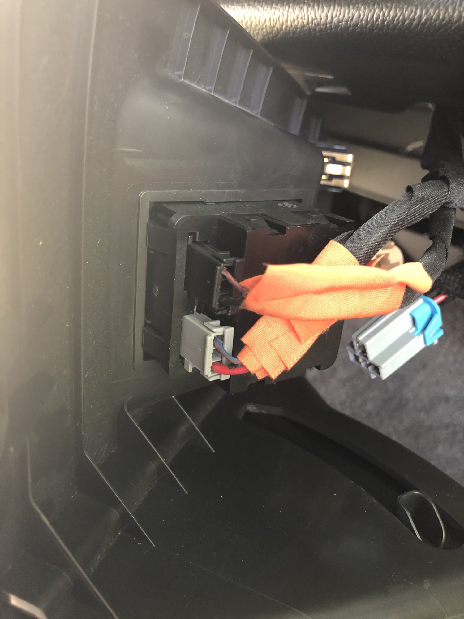

At this stage of the game now. These do not wanna come out easy. I don’t wanna rip the wires either lol.

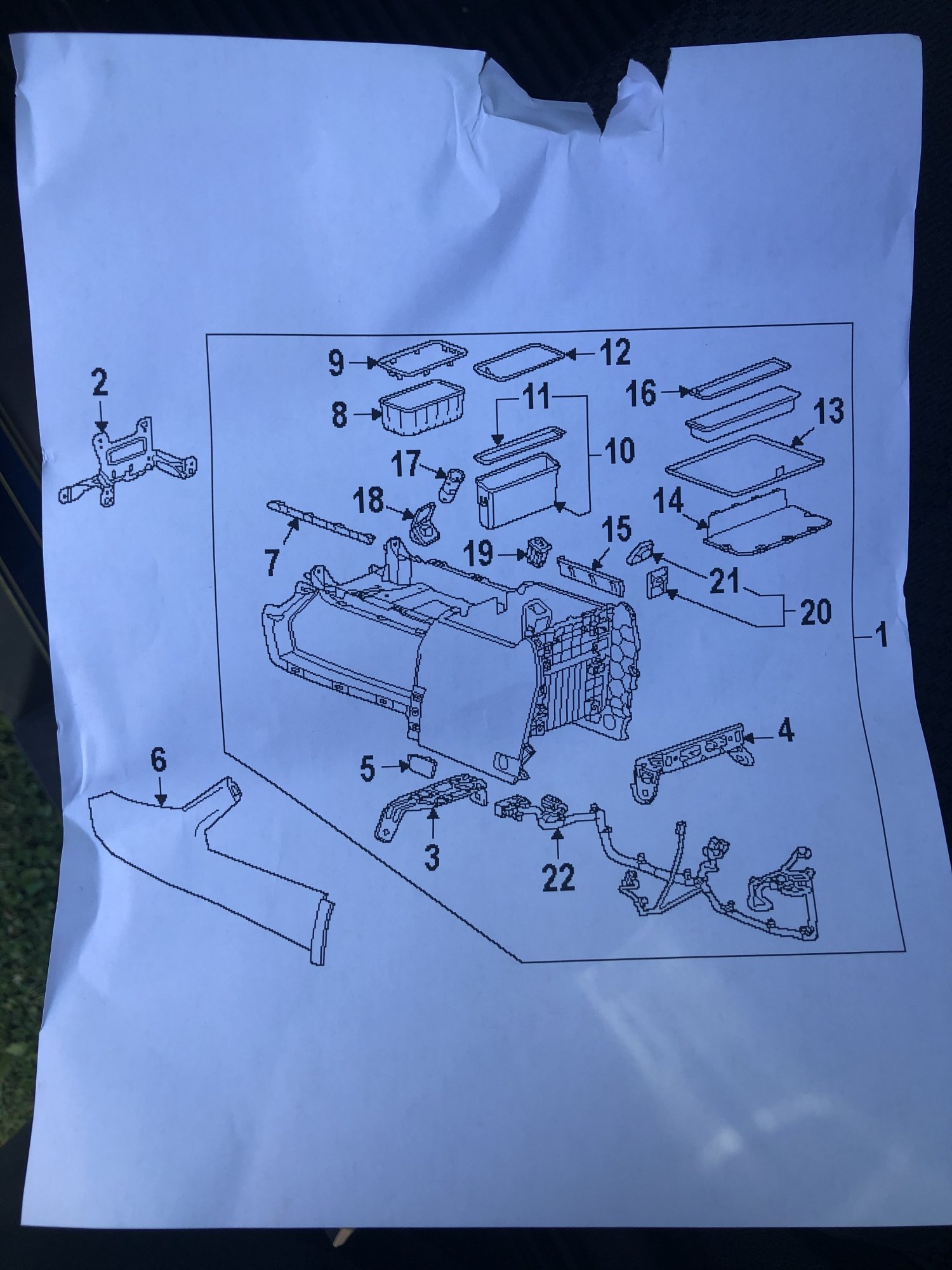

So even though they’re sending me a new harness I have to remove the one in the jump seat and use it? Attached images is what I should be getting with the assembly. I wasn’t aware that I had to send him anything! Thanks for that info. I’ve reached out in the past and he was informative! Hope to catch him up with him soon.

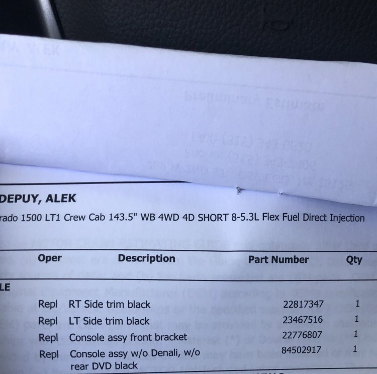

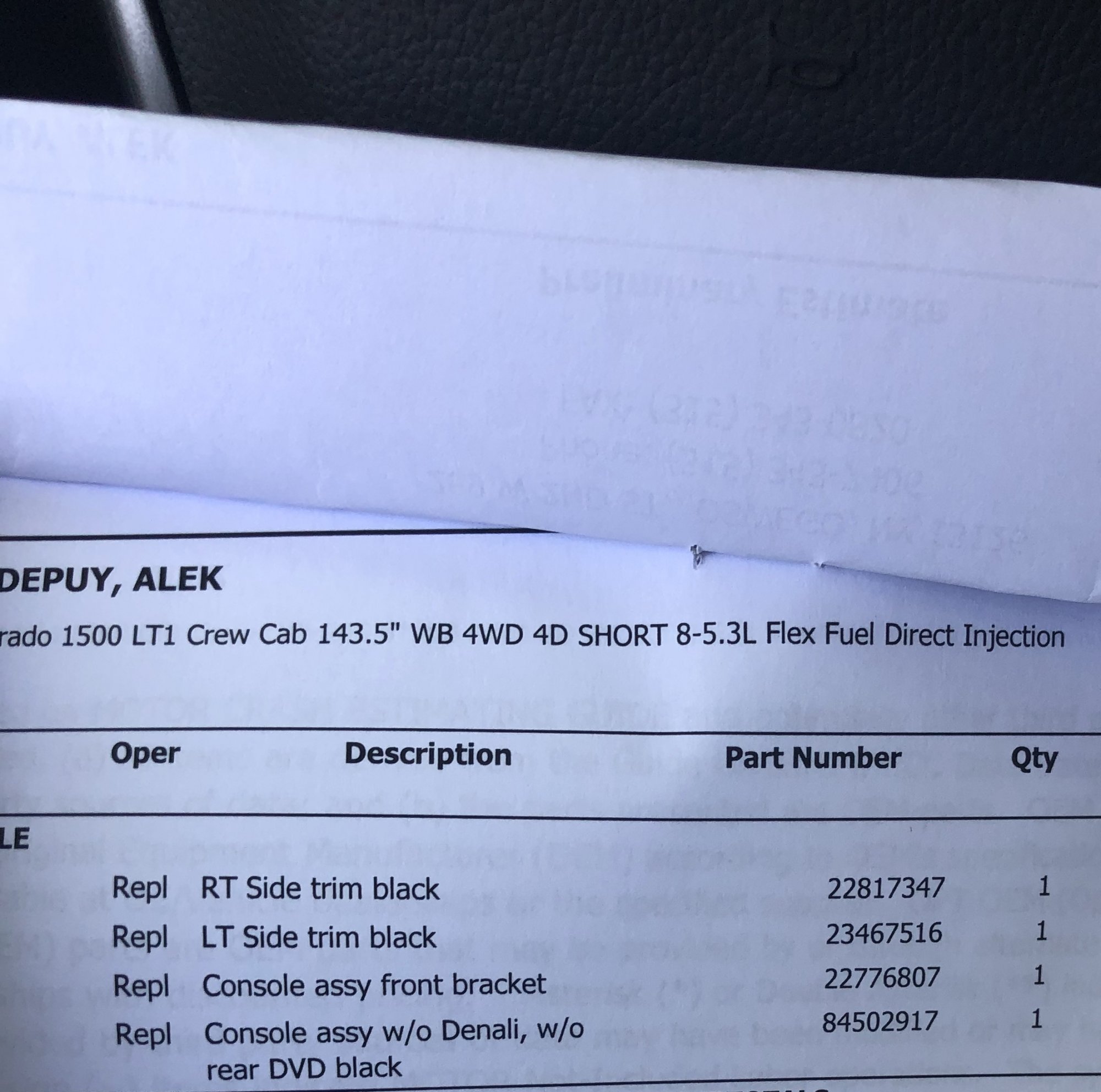

This is what the Body Shop gave to me for a parts list (image attached). We were also skeptical on if the entire assembly would show up or if were going to be missing anything. We’ll find that out tomorrow.
