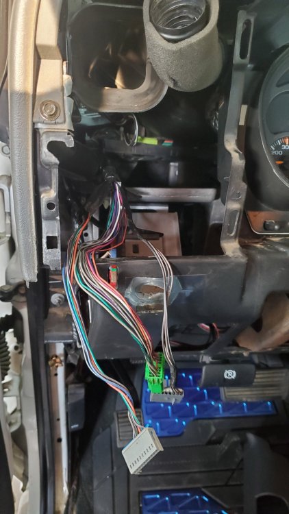

tgrisko's Achievements

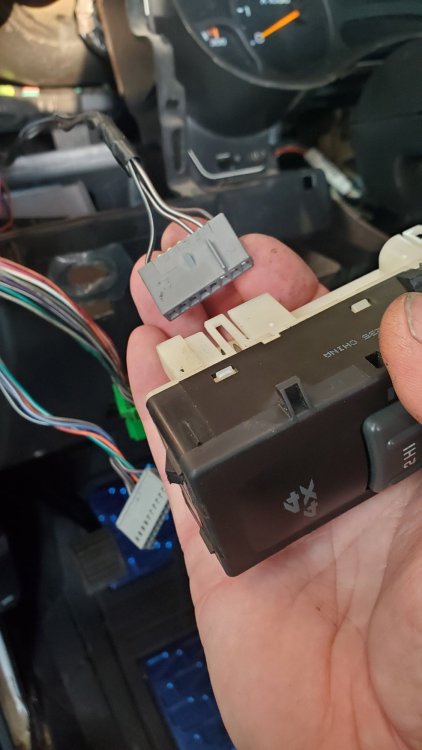

  3. Gonna have to do that for sure.... my hunt right now is trying to find detailed wiring diagrams/ schematics to nail down what I need as far as wiring harnesses... I know I am missing the Transfer Case Control Module ( TCCM) and the connections for it. The TCCM connections come out of the main harness that connects the Distribution Block ( fuse block) under the hood, thru the firewall, to various parts inside the cab This harness may have come from a 2wd donor... This is an assumption on my part... since there is no provisions for the TCCM connection in this harness. The part number on this 2003 date coded harness ( 15204375 ) does not come up anywhere in my search. I cannot even locate a part number for this harness for a 2001 online either. My guess is I need the technical name of this harness to try and find it. I am determined. My best recourse of action at this point is to find a donor 03-07 25/3500 4x4 with this harness in tact with the TCCM and 4x4 switch from the dash. I can't find any local yards with these exact parts... so the hunt continues. Again... I appreciate the help with this.

  13. Thanks for responding ... the title and dash match....no door tag... its clean....i would love to verify this... if only just for getting the correct parts...i just want to get it all working correctly... 4x4 is all that doesn't work... everything else is cherry What do you make of not having a TCCM and no.connections on the harness for it or the 4x4 switch? Sent from my SM-G975U using Tapatalk

  15. Ok... First off I just bought this truck with the LB7, 156K on the clock in pristine condition, ( at a GREAT price) so I thought the 4x4 issue was going to be an easy one since I have a 2004 Z71 and know it pretty good. The PO didn't even know the 4wd wasn't working as he never used it and didn have the truck for very long, so I can't blame him ( he is like 80yrs old). Here goes the story..... ( pic #1) 2001 K3500 dually with the LB7.... somewhere along its life, someone did a 03-07 front clip conversion on it.... its been a while for sure as all the paint matches and weathering is even... all parts were painted prior to install as there is no sign of over-spray anywhwere.. not even bolt heads on the fenders. ( pic #2) I get the truck home... she runs perfect! I went thru all the essentials the first week and made a 1000+ mile trip towing my 38' Raptor Toy Hauler at 65-70mph with zero issues on the 6th day of ownership. Time to tackle the 4x4 issue: The 4x4 switch is dead... no lights. I pull the switch... NOT CONNECTED!!! can't find the connectors. I dig deeper and I find one... but its different than the switch ( pic#3) no other connector to be found Keep digging.... ( pic #4) Follow t-case wiring up to side of under the hood fuse box.... NO CONNECTORS GOING THRU THE FIRE WALL connecting to the t-case harness! WTF!?! Continued on next post....
