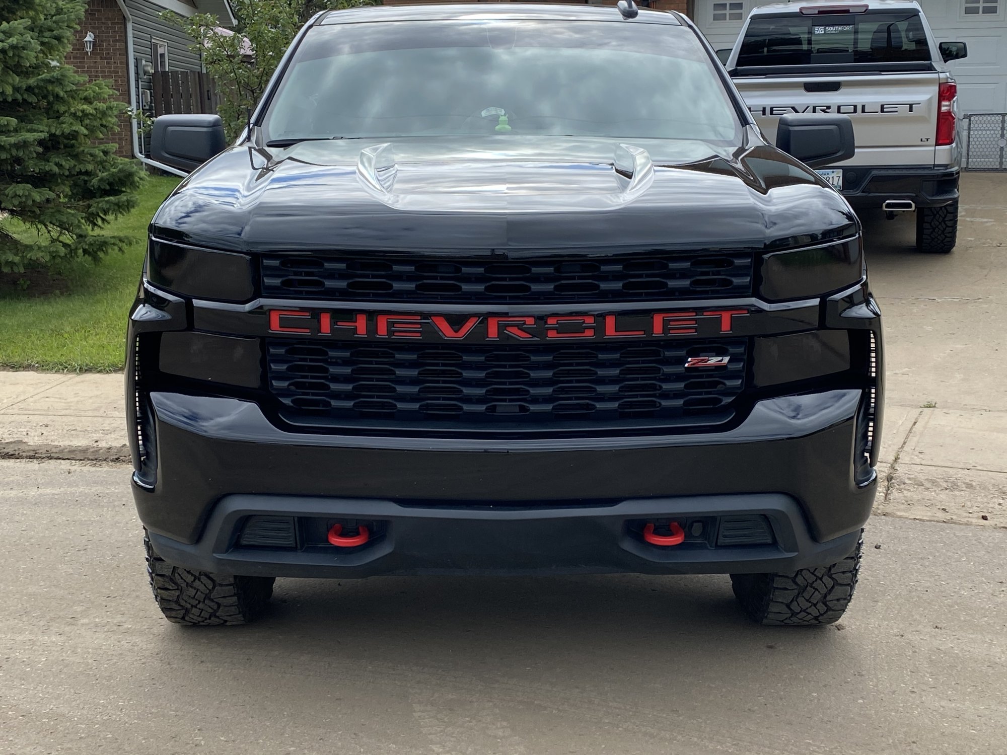

  3. Very easy to do, remove grille then Center piece with Chevrolet lettering, then I jus installed 2 layers of 3M automotive vinyl and a layer of PPF over that reinstalled everything, take n hr at the most I did 2 layers of the red vinyl because u can see the shaper of the squares behind the red vinyl still, but with PPF of it I haven’t had an issue, can go 2 inches away with pressure washer to get bugs and debris off no problem.
