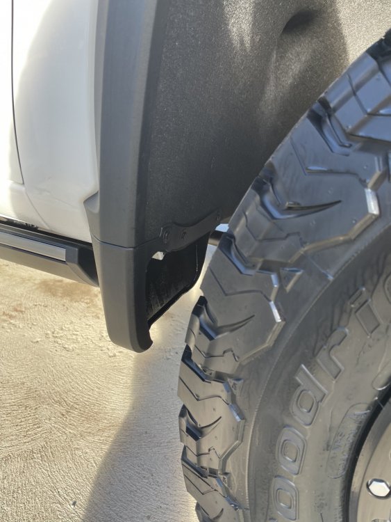

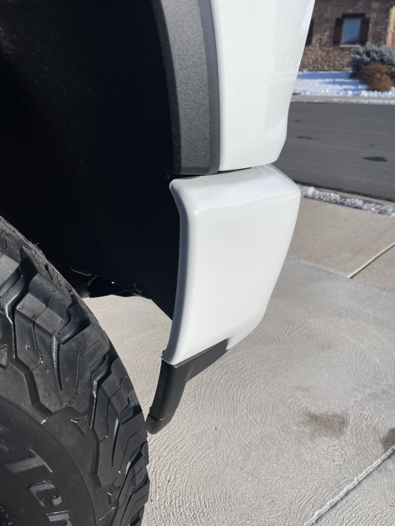

  2. Im adding the extended GM flaps so will need to trim those as well. Will post when finished. They appear to a flare out another 1-2 inches for some additional coverage but still factory look.

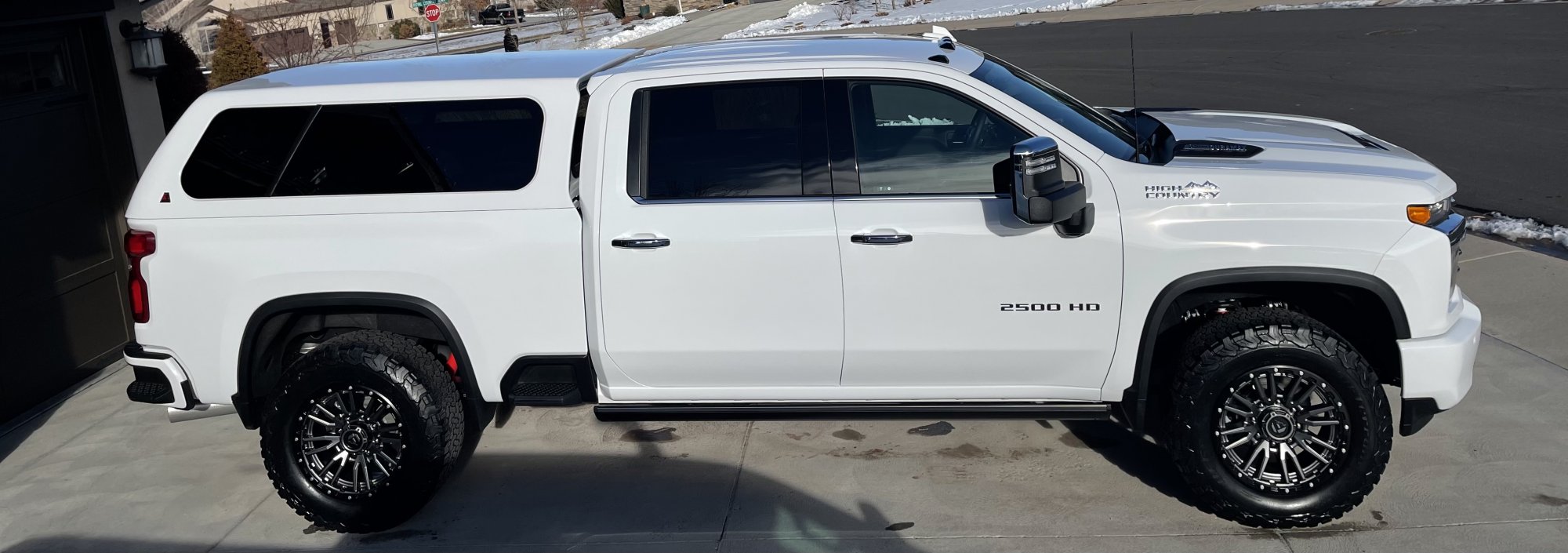

  3. Thanks.. It did have all 4 tires/rims in the rear when the pic was taken but overall, it’s very level without touching anything. Also should consider weight of topper I guess. Trimmed the mud flap and liner, nothing else. I have not installed my airbags yet.‘FYI

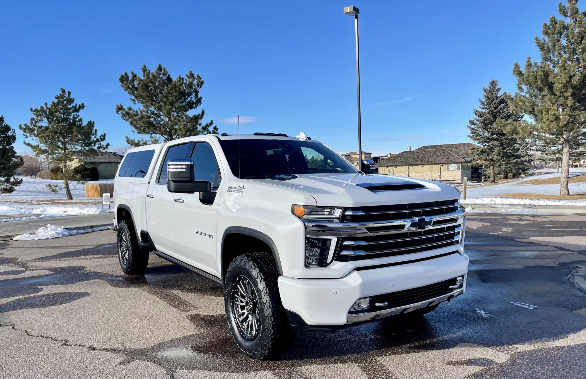

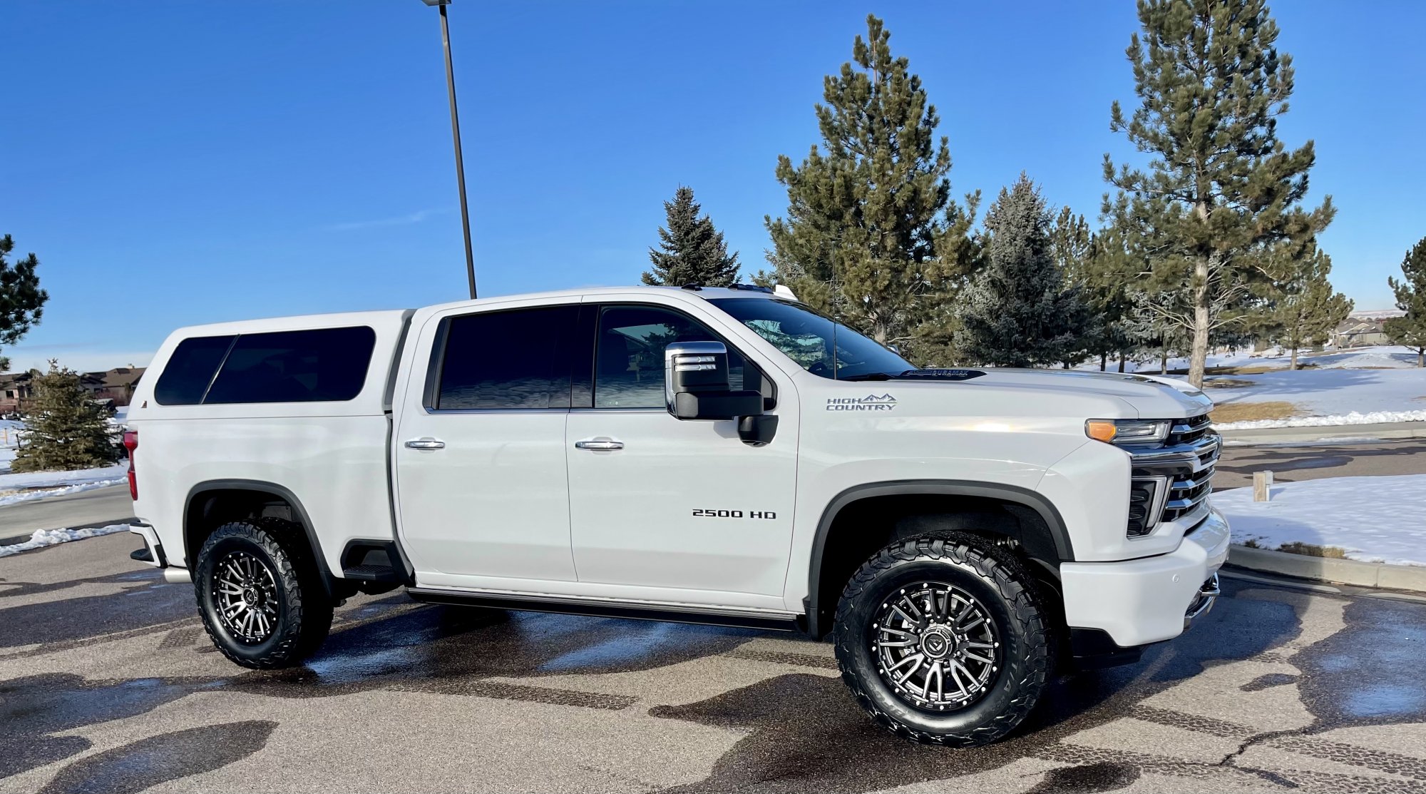

  6. Just finished my ‘21 High Country. Goals were: 1. Clean look for ****** 54 yr old, no more lifted trucks.. 2. Keep stock ride height and suspension 3. No rub, minimal trimming if needed 4. More aggressive stance, minimal offset 5. Slightly bigger tire, 10 ply towing, beef it up 6. Run airbags for towing 7. Clear bra paint protection, drive in winter mtn conditions, lots of sand,salt, and mag chloride. Mods: 1. Leer 100 XL Topper 2. Bed rug 3. Fuel Rebel 8 Anthracite 20x9 +1 offset 4. BFG KO2 295/65/20 5. Factory installed Amp boards 6. Firestone Air bag setup for towing. 7. Clear bra front bumper, inserts and hood 18”. Damn these new HD’s are big! Happy with how it turned out. Beefed it up a bit. Was very surprised I was able to do it without a level. Wanted to make sure I could park in my garage and take it to a car wash etc. Minor trimming didn’t bother me vs a level kit. Love the wheels but couldn’t get them in a +18 offset, only +1. Went with 295/65/20 hoping the 11.5 wide would help me, which it did for the most part. I do a lot of hauling and driving in winter mountain conditions. Lots of sand and rock on the roads. Could always clear bra and paint protect more of the body sides and learning edges? That will be expensive. I can’t seem to find any aftermarket flares that I like that won’t make it look goofy. Any thoughts or suggestions ?
