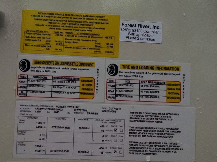

  2. Yes, I did have the discussion in past. I want to say I was given quite a few leads, and unfortunately nothing panned out. The place I did contact through GM stated it was not their problem that the sticker was not fixed to truck but would charge me $$$ for a new to be sent and blamed the problem of it missing on dealership. So here I am again. Sorry! How do I prove dealership removed sticker and why pay for something that should have come with truck originally. I did request and get the buildout on my truck through dealership by VIN (no weights listed). Not upset over fact, just need a new direction to get this information. Then I will ask, are vehicles suppose to have both these stickers? Looking at a Forest River Travel Trailer Heritage Glen 272RL (used 2017) see attachment

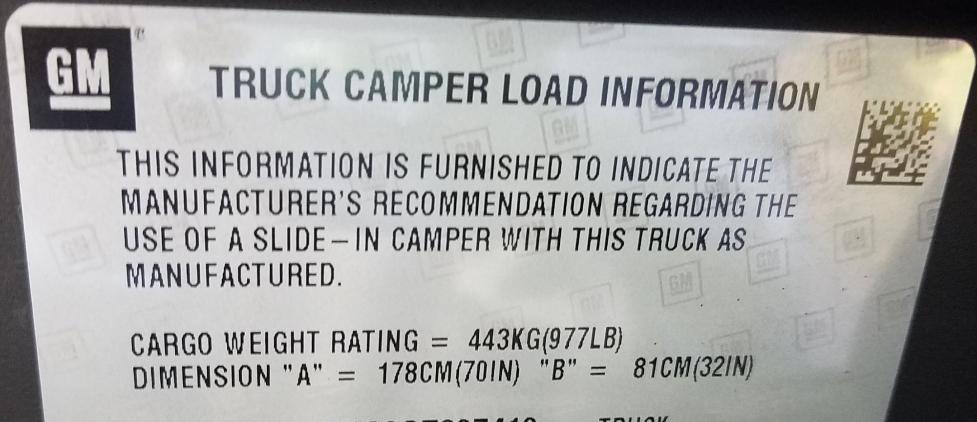

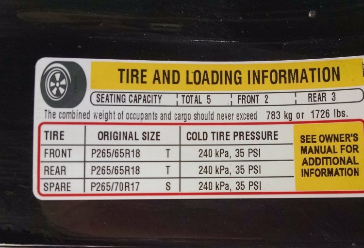

  3. Hi, I own a 2016 GMC Sierra 1500 SLE Double Cab 4WD 5.3L V8 w/3.42 rear axle ratio. I am interested in towing a travel trailer. After reading about axle weights, vehicle weights, hitch weights and so on I found that I should have two labels on my drivers door. One is the Tire Loading Information (tire size & maximum air pressure along with the maximum cargo weight) and the other is Certification Tire Label (truck load limits such as curb weight, axle weight. and so on), sometimes called the Federal Compliance Label (yellow sticker). I have the Tire Load Information with maximum passenger/cargo weight at 1726 pounds but nothing that gives me any vehicle weights. If anyone knows where I should look, write, or call to obtain this information, I would appreciate it. My dealership was of no help. Please, see attached pictures of what I have with information verses a copy of what is missing. Thank you for any help you may offer. Ken

  6. These are the only stickers I found on my door(s) and glove box. Checked all four doors, the jambs front and back.
