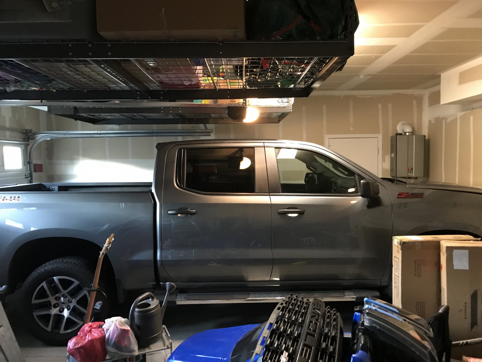

  4. Thanks! Spent a few hours and was only able to get the grille and passenger headlight out. So far no broken parts lol. Saw a couple videos on the web regarding headlight removal and your guys post were all extremely helpful. I didn't have to remove the panel filler on the sides of the front bumper since I was able to reach one of the headlight bolts using a ratcheting wrench. Next to the inner part of the headlights are gaskets that are secured to the front frame with Christmas tree rivets which need to be removed otherwise sliding out the light would be difficult. Will try and upload pictures of gasket. Ran out of time so it's back in the garage waiting for tomorrow morning when I can hopefully complete the front conversion.
