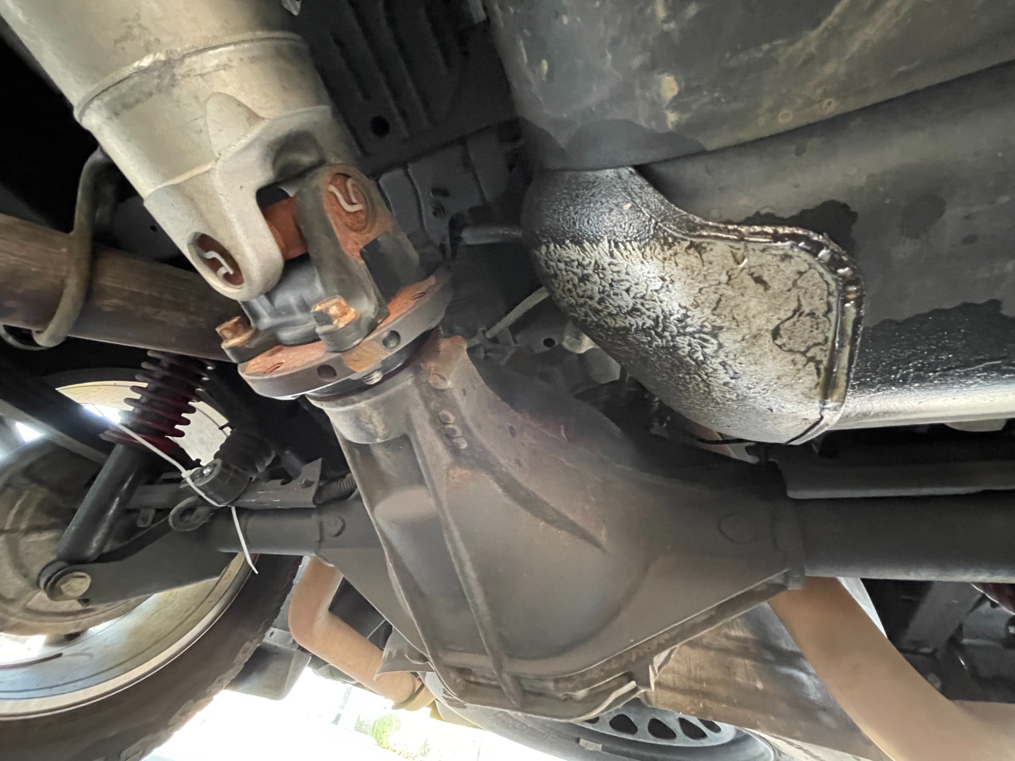

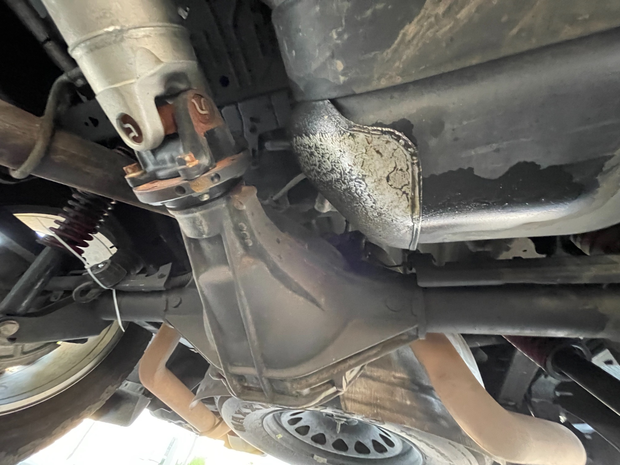

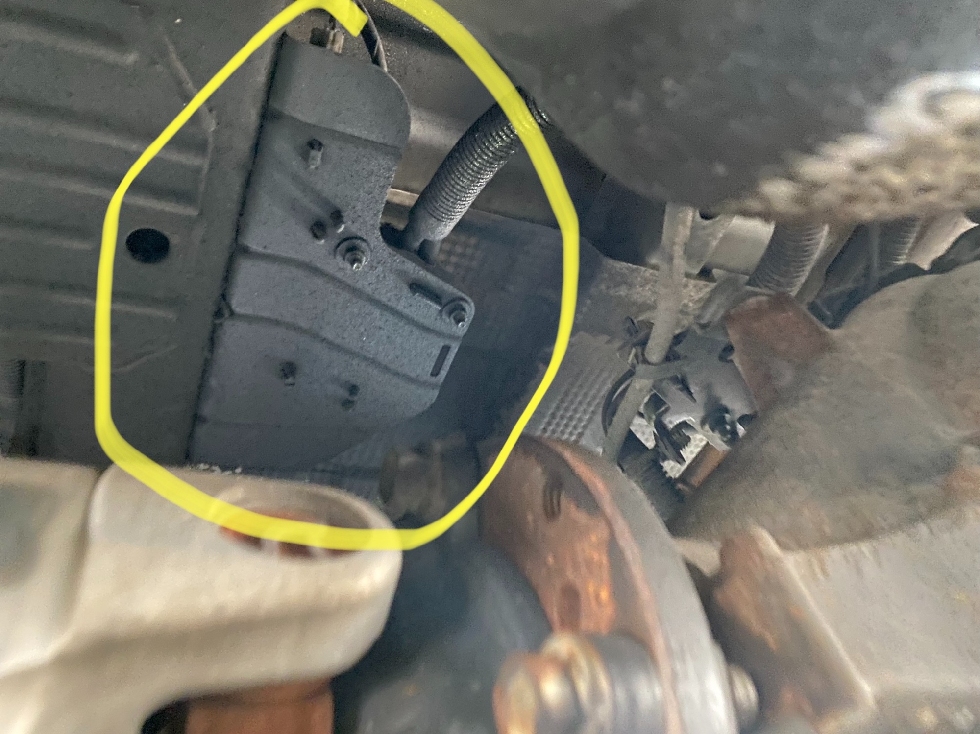

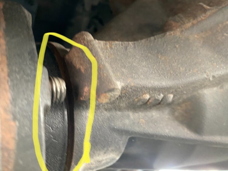

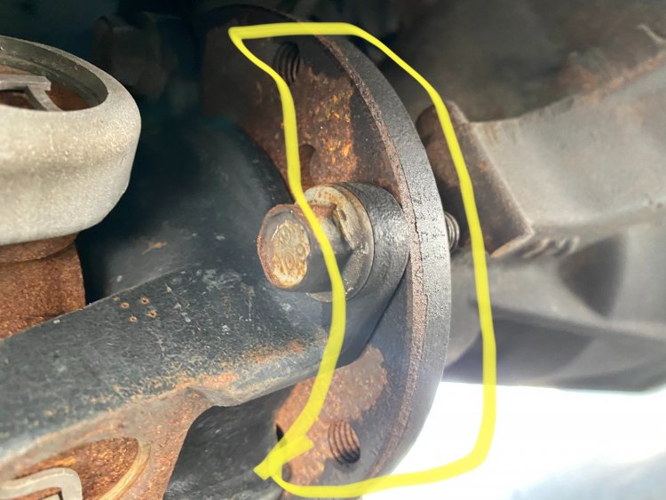

  6. I’ve added more photos. Everything I’ve circled has oil on it. The arrows represent the direction at which the oil is being flung. Looking at the shield over the fuel tank is a give away. And then on the bottom of the bed. It all correlates. also; I’ve also been experiencing a shutter at times on certain on some interstate hills. Doesn’t do it all the time. Im hoping this is related to low diff fluid and nothing more serious so we will see.
  7. It definitely smells like gear oil. Has lubricity like gear oil. Everything around the pinion is oily. The tank is only wet on the side where the gear oil is being flung. Above the pinion is the bottom of the truck bed and that is wet. Dirty is sticking and making a mess.
  8. I did a quick search and I think my pinion seal is going bad. I’m having fluid flung onto my gas tank. Also getting a shutter sometimes on certain hills pullin my trailer. I’ve attached fluid
