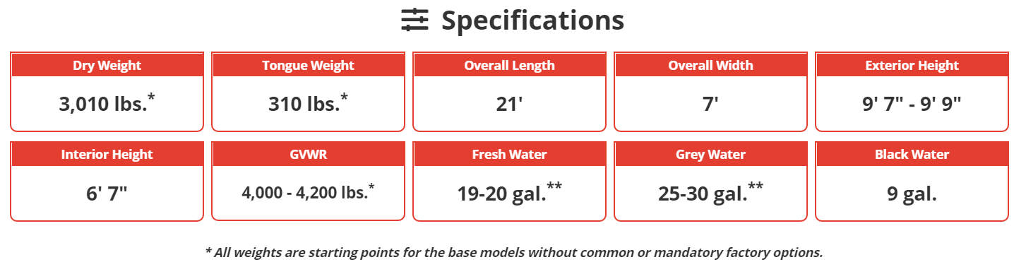

  3. I don't know about gear ratios or transmission cooling, but I want to share that I bought a Little Guy Max teardrop trailer with the following specs (dry weight 3010, tongue weight 310, GVWR 4000-4200): I then tried to pull it with a 2018 Toyota Highlander which has a rated towing capacity of 5000 lb. I tried pulling the trailer with it in Oregon, Nevada, Utah and Colorado. I was very unhappy with the reserve power--I was that guy driving at 60 mph going uphill with the four-way flashers on. Also, I was uncomfortable trying to pull the trailer through remote state parks -- up and down fairly steep unpaved roads to get to the nice camp sites. After about 2000 miles of towing, I had the car serviced and the front brakes were shot, the rear shocks were leaking, and the transmission (fluid) needed servicing. I traded the SUV in for a 2021 Silverado with a 3.0L Duramax diesel with a 10-speed transmission and the trailering package. Towing capacity of approx 9600. What a relief! Now I can accelerate going up hills if I want to and I can pull the trailer through pretty tough unpaved roads without worry. As a fairly new truck / trailer person, I recommend getting a truck with 2x the towing capacity of your trailer GVWR. Hth.
