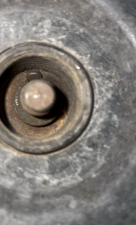

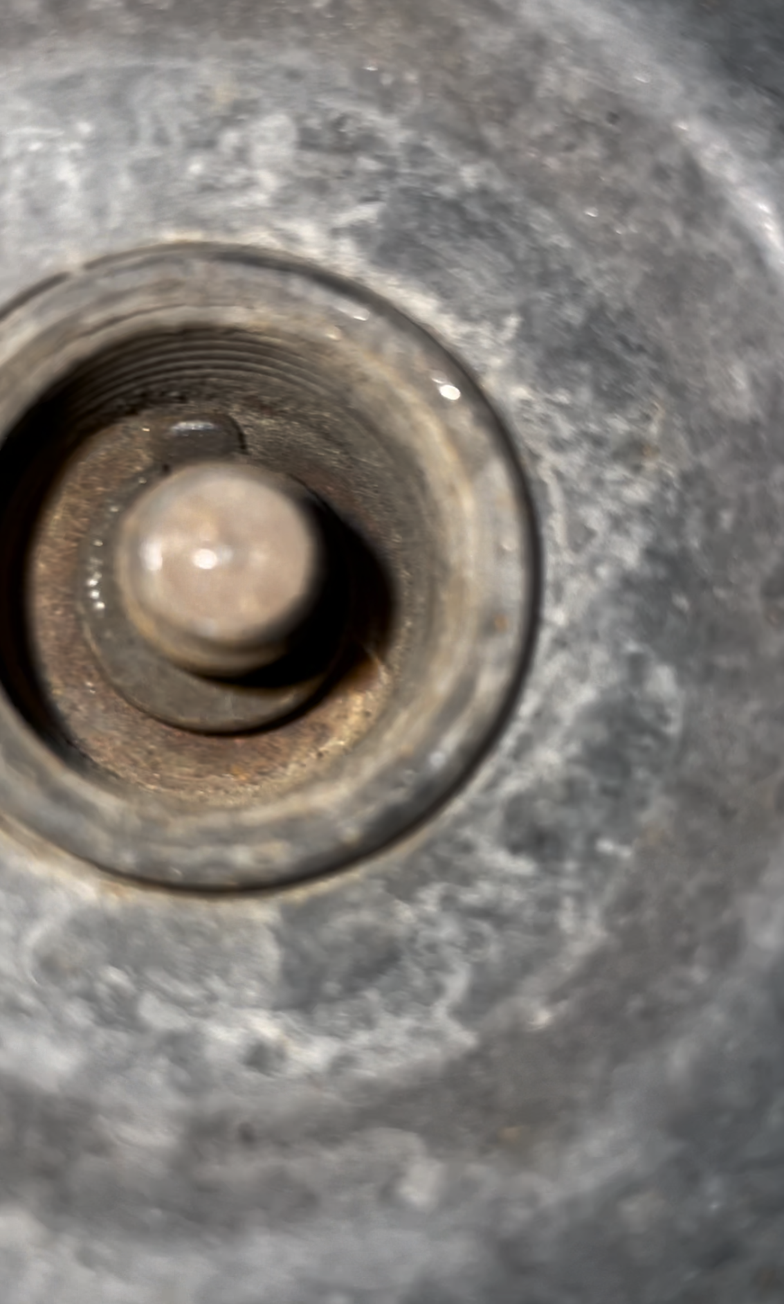

  3. Hello, The AC compressor on my 2000 Silverado 1500 has been acting up. It will work on cold starts, but once the truck gets warmed up the compressor clutch will disengage itself and will only work again if I turn it off for a few minutes and let it cool down. So I thought the solution was to replace the compressor clutch. I watched a video of a guy doing it without having to breach the refrigerant system so I bought the bought and gave it a shot. I took off the intake and fan shroud to get down to the compressor. And I was unable to get the face plate of the clutch off. What was holding on the face plate looked different from what I had seen everywhere else online. I'm assuming the current compressor on it was a replacement before I bought it (I bought it at 172,000 miles). I attached a couple of photos I was able to get of what is holding on the face plate of the compressor. It looks like some kind of clip, and I assume it's threaded onto the shaft since I never took any nut off before I found it like this. Has anyone seen anything like this before? If so, am I able to even to replace just the clutch? Or is it a better idea to just replace the whole compressor? Trying to keep the old girl going for a while longer. Thanks!
