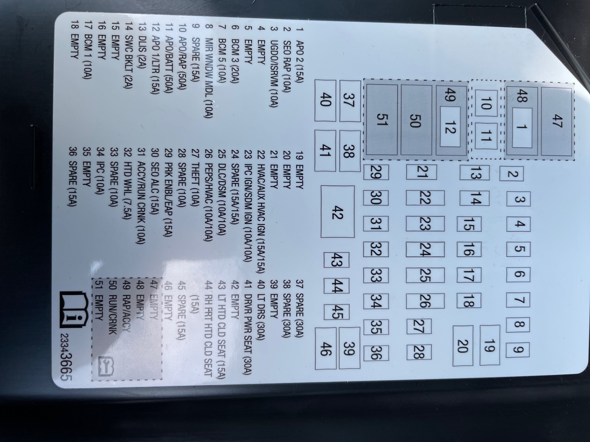

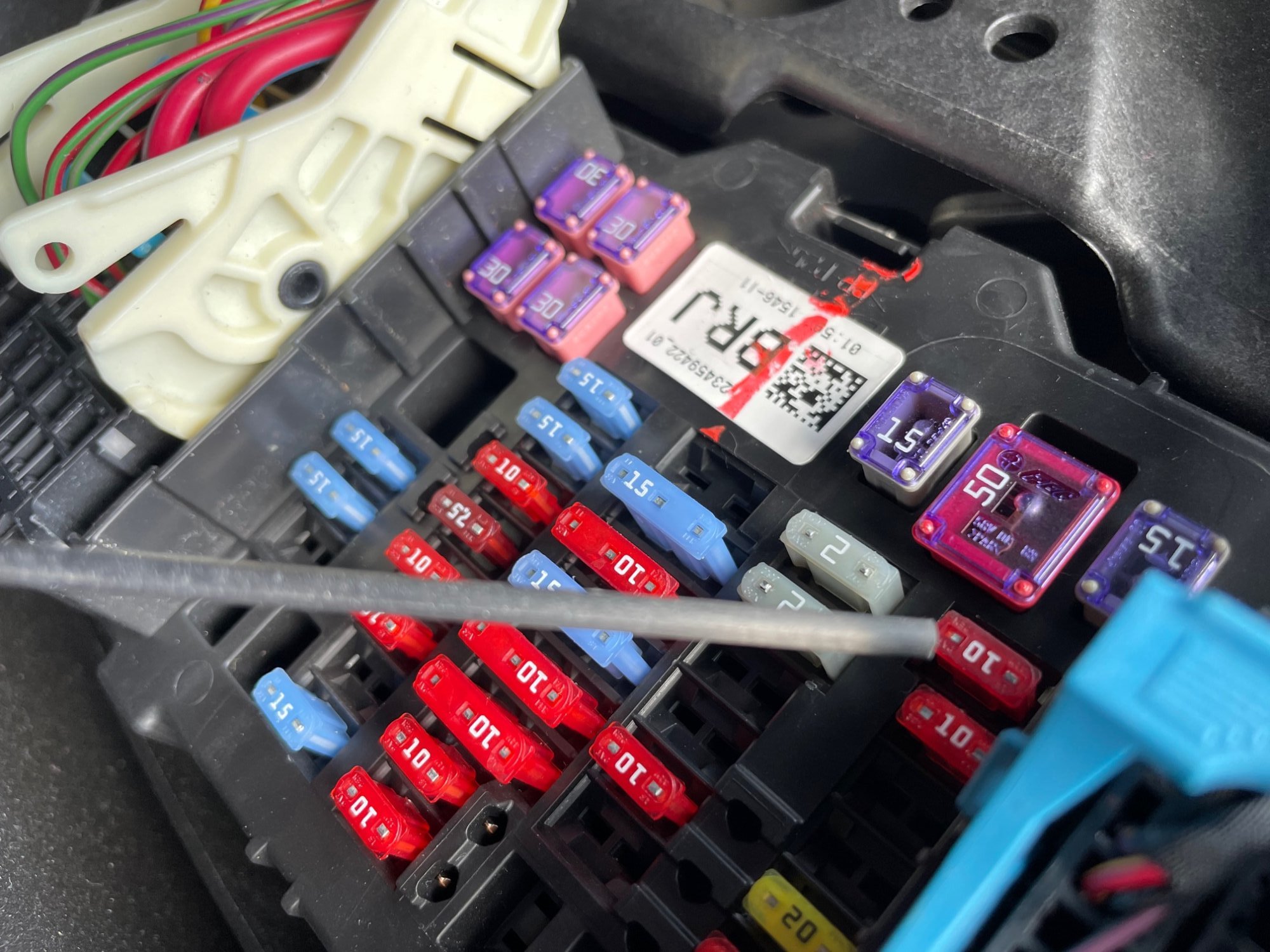

  1. Hello, My pictures rotated 1/4 clockwise when I uploaded them. Number 1 is that square 15. To the right, or below in the pic, is number 2 that little red 10 that I touching with the pointer. I found that if this fuse in my truck was blowing there was a short somewhere.
  2. You're in luck. I just finished getting mine to work again on my 2016 Silverado. There is a known issue with the wires that run from the console charging pad to the main harness where they get cut by the console door after many times opening and closing. I replaced my wiring harness last night and it didnt work. I changed the 30 pink fuse on the passenger side. No luck. Then I decided to pull and look at each fuse. I started on the drivers side. When I got to number 2 it was blown. Replaced it and now the charging pad, and the window work.
  3. Update: I got it to work!!!!! I woke up this morning thinking "I know that pink 30 amp is not the one I changed a few years ago." I started on the drivers side at the bottom and pulled each fuse and inspected it. When I got to fuse number 2 (SEO RAP (10A)) it was busted. I replaced that and BOOM it is all working now. The charging pad is now charging as well.
