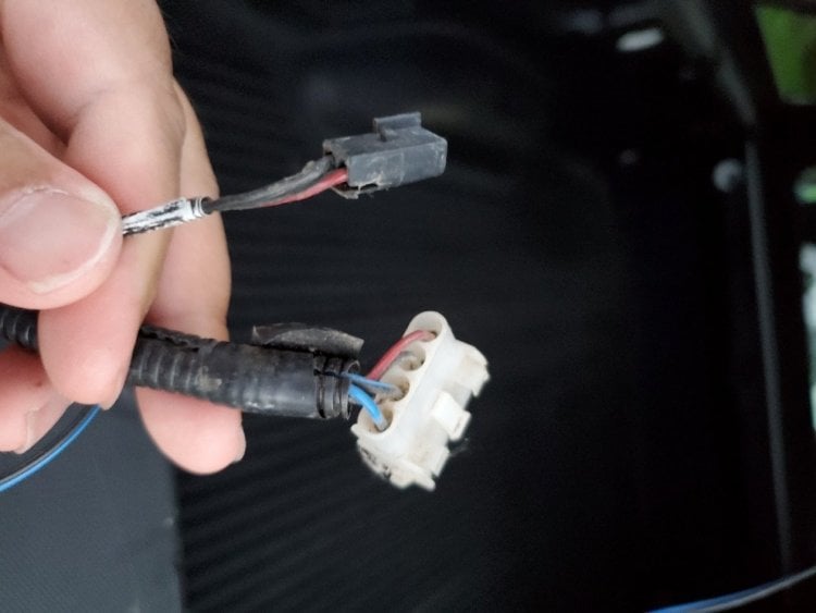

  1. From what I can see it runs to the third brake light, but there is also a small dome light inside the cap as well. I assumed that wire went to the interior light and the bigger harness went to the brakes.
  2. Hey Everyone, Bought a used bed cap for my 2015 Silverado 1500 WT. I know its probably a stretch to assume this, but is factory harnesses to plug in the wire harnesses on the truck that Im not seeing? or am I gonna have to cut and solder up my own harnesses? From what I know, my cap was specifically for my model and generation of of silverado so I figured maybe it came with factory compliant hook ups. Figured it was worth asking. Ive attached pictures of my wire plugs that attach to the cap's third brake light and it also has an interior dome light. If I gotta solder my own harness on, can anyone direct me to the best way to do this for my truck?

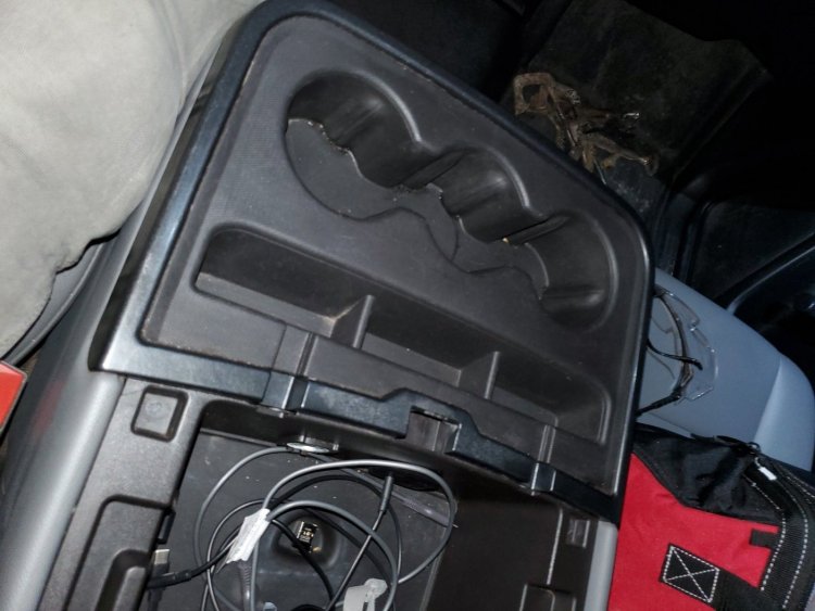

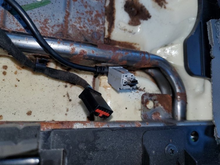

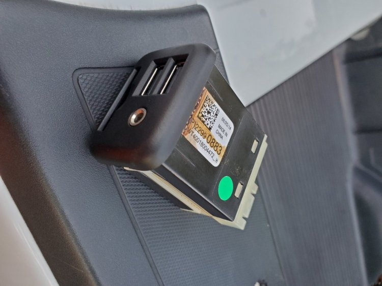

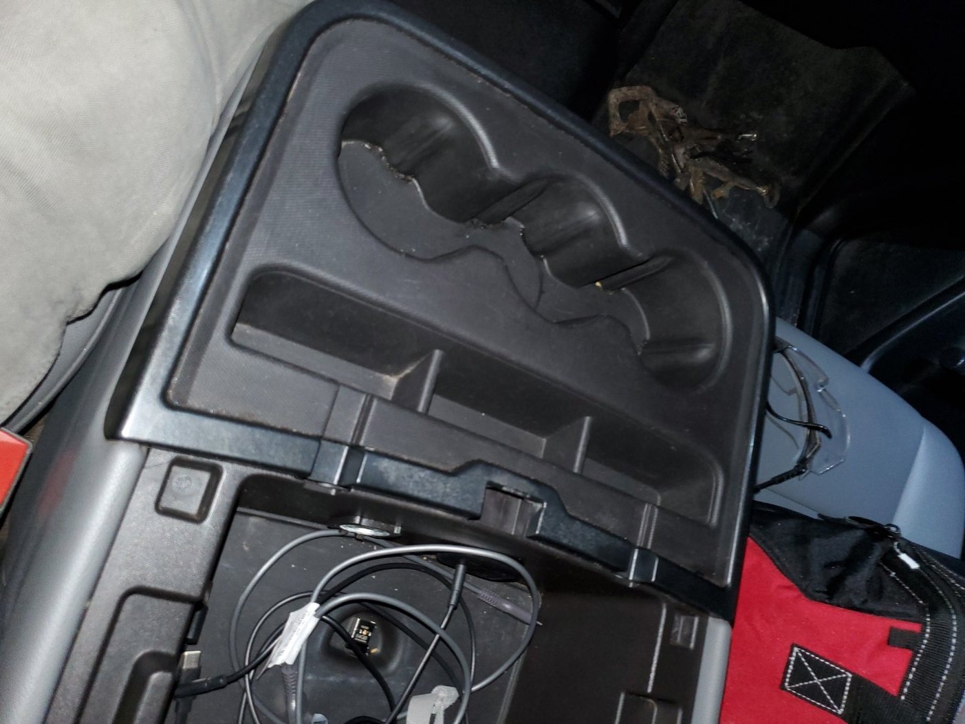

  4. So yeah, I took my cupholders out. Looks like someone spilled a lot of coffee at some point in the past. I checked and it seems the USB is plugged into something, but no power seems to be going to it anyway. I unhooked the two plugs, properly reassembled the module, then tried hooking everything back up, started the truck, and still my phone wasnt getting any power. Are the W/T usb plugs just for show or something? or does my truck have an issue somewhere? for the record, my phone does charge when hooked up to the 12v outlet next to it, and the aux cable works. the SD and USB seem to be unusable.
  5. So made a little discovery earlier, my USB ports dont seem to be doing anything at all, not even charging my phone. I checked the fuse and it seems fine, so I went to try checking the wiring on the module itself, maybe the USB isnt plugged in or something... Well upon trying to pop the port assembly out from the center console, the wire seemed too short or caught on something and I ended up pulling the while assembly apart... The back board that the plugs connect to stayed in the console, and the housing and circuit boards came out in my hand... ugh. I was able to put it functionally back together but the back board pushes in before it all clicks firmly together. So I guess Im gonna explore how to take these cupholders apart and look at it from the inside...
