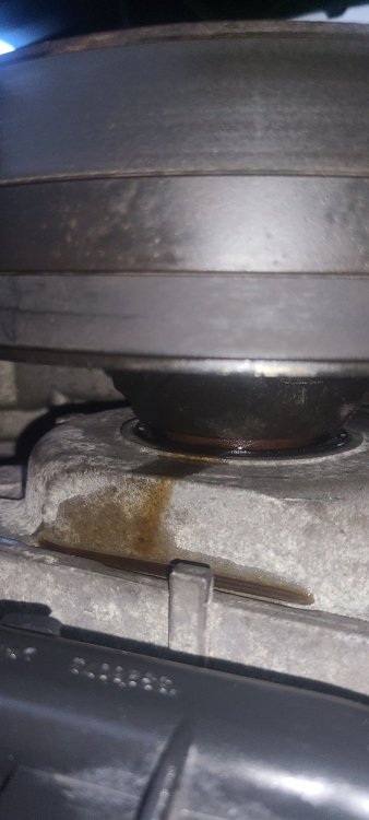

  1. I just finished up doing the AFM/DOD delete on my 2013 GMC Yukon Denail and it seems i have a front crank seal leak. When installing the new OEM seal and balancer, i did not put any sealant on the outside of the seal or grease the inside of the seal prior to the balancer installation. 3 questions: 1. Upon re installation of the seal, is common practice to put sealant on the outside and grease or oil the inside? 2. Are there any best practices to hold the crankshaft still while we tighten the bolt outside of wedging a pry bar in between the balance? If i can stick pry bar in the sprocket of the flywheel, will that be able to take the torque needed to fully tighten down the crank bolt? 3. I bought an ARP bolt this time around. The ARP website says to torque to 235 ft lbs, is that correct? That seems like an awful lot. Any help is appreciated. I cleaned up all the excess oil and verified the leak was coming from the seal, i have included a picture.

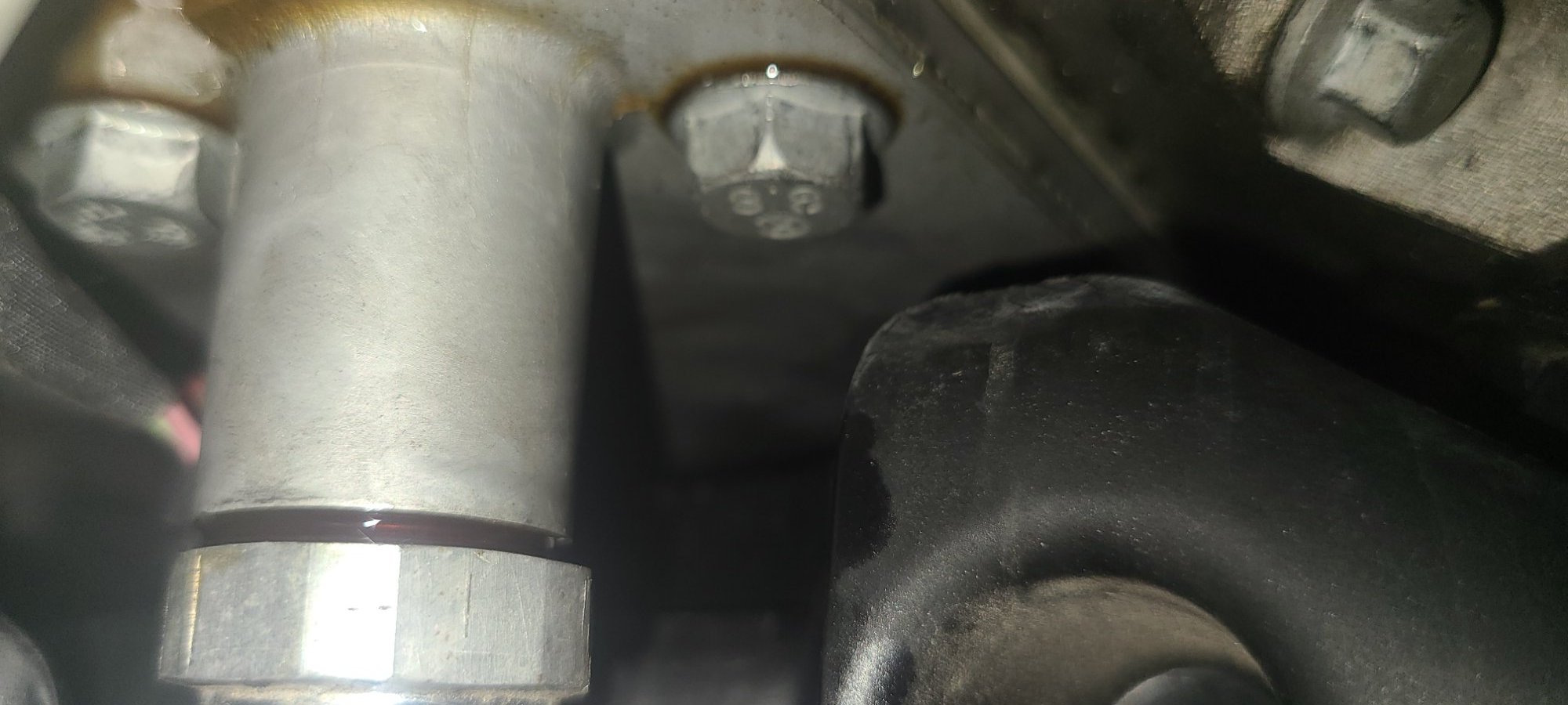

  2. Yea, I took it out yesterday. Apparently when I put it back in the new valley pan I didn't seal the threads. I wrapped it with Teflon tape, put it back in, roughly clean the stuff under the car with brake cleaner and took it for about a mile test drive and had a little more oil pressure (was right below 40 from a cold start, now its right above 40) then let it sit overnight. I checked this morning and it looks like there may have been a few drops from the front seal which I know about but not a stream like before in the middle of the truck. I included pictures of what it look like around it before and after. I'll take it on a longer drive later and make sure everything is good to go. Now to figure out the front seal. Baby steps! Haha
  3. I swapped over the oil pressure sending unit to the new vlom. Is it possible that it is causing the leak down the pain and to the middle of the truck?!

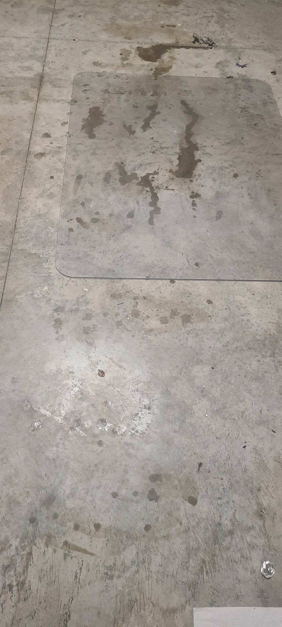

  4. We were able to slap everything back together and I reprogrammed the truck to remove the AFM/DOD. Truck fired right up and runs great however now I have a lil leak. It drips right under the pulleys and looks like the main seal may be leaking and then there is a stream where it seems to run down the oil pan, I'm not sure if it's 2 leaks or 1. We did not replace the oil pump, timing chain or chain tensioner. I did loosen one of the oil pan bolts not paying attention when trying to remove a wire bracket under the bottom of the timing chain cover and front of the oil pan, then tighten it back. Gaskets that were replaced: Main crank seal Timing cover gasket Water pump gasket new VLOM with new gasket Head gaskets Valve cover gaskets Intake manifold gasket Exhaust manifold gasket I've read it is tough to get the main crank seal right and I'm not sure if ruined the oil pan gasket by loosening that one bolt. I've been debating running blue devil oil stop leak through the system but I want to verify where the leak/leaks are coming from. I included a picture from my floor from the past few days. The few drops at the front seem like they're from the balancer area and the stream seems like it just runs down the oil pan and drops in random spots. Again, thanks for the help so far
