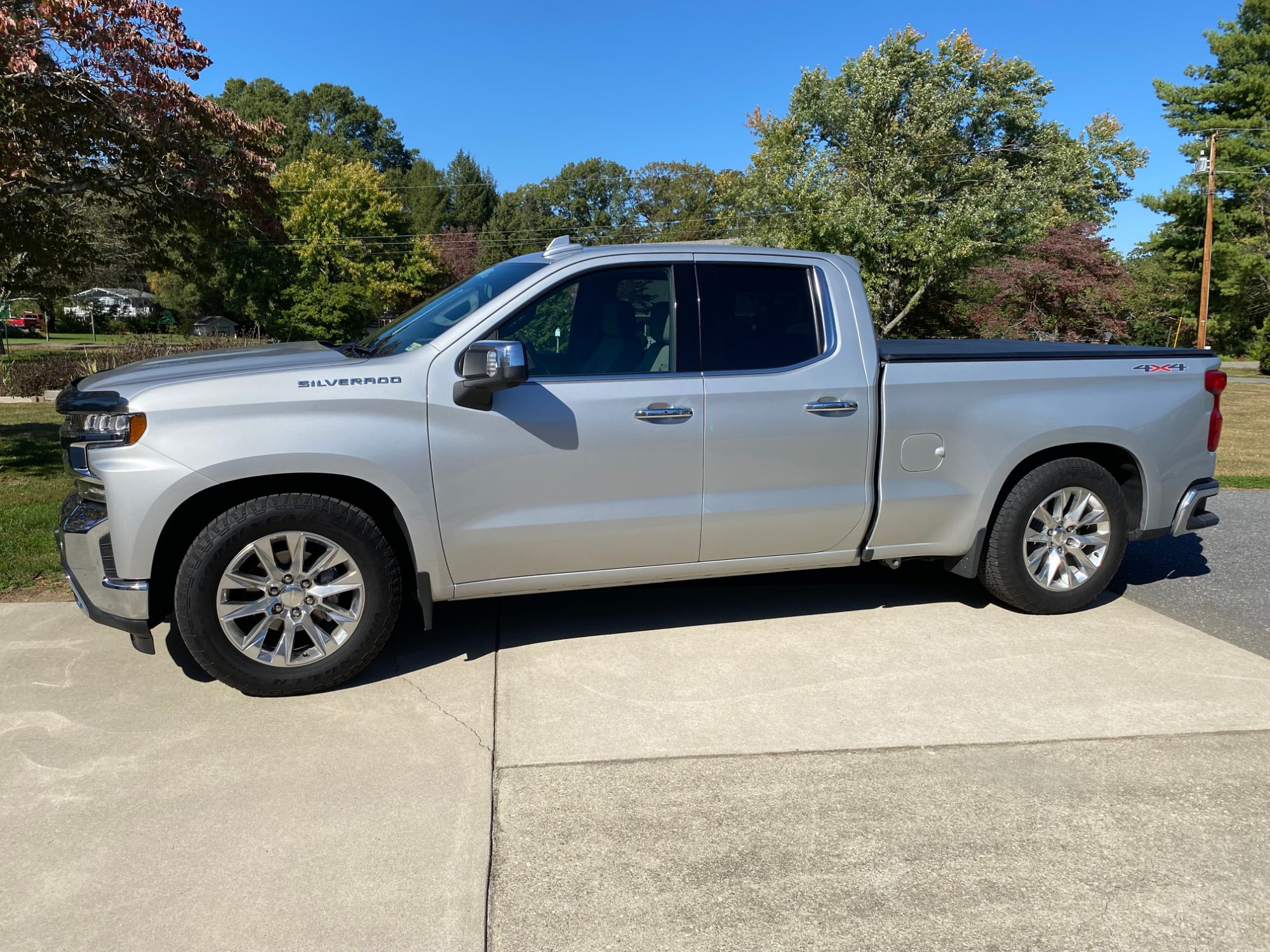

  1. Saga continues: I installed the Rancho shocks today. Impressed so far. I have them set on 5 out of 9 settings, so I can still stiffing them up if need be. Also I cut the Timbren bump stops in half and removed the 1/4 inch spacer. This left me a little over a half inch clearance between the axle and the bump stop. Ride is much better but I need to go find a rough road to find out how they really feel. Shocks for this setup: Maxtrac shocks are junk - Don't even buy them. OEM shocks were better than the Maxtrac's. Belltech Street Performance shocks were good shocks but I thought they were too short and hence the truck sat lower in the back then the front and also made my bump stop issue worse. Rancho shocks are heavy duty and have leveled out my setup and I believe will assist with the bump stop issue. If I still have a bump stop issue, I'll notch the frame after my warranty runs out in 8 months.
