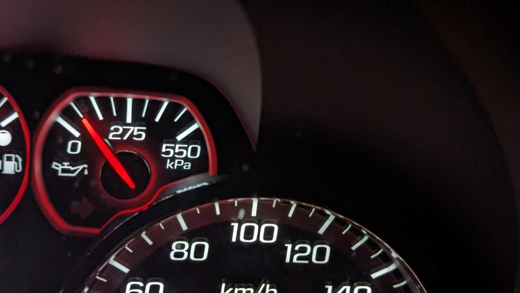

  3. I get what your saying but if it starts making noises it's already too late to save it... Seems unlikely normal wear would be enough to make a 10psi difference. It's only got a 140k on it. If it was 250k miles I'd be less concerned about it. I ended up telling them to go ahead with it. Will see if it improves.
  4. It's getting worse though which is what concerns me, it never used to drop below 20psi (1/4) on gauge, down at the 1/8th mark now (10psi). When would you start to be worried if it continues to get worse? 5psi?
  5. 2017 sierra 5.3 with 230k kms/ 140k miles. Oil pressure when hot drops to 10 psi at idle. Spikes back up as soon as you hit the gas. It's always dropped low to like 20psi since new but seems to be getting worse very gradually. At highway speeds it's up around 35-40psi. If I step on it it will jump up to 60 or so. Local shop is recommending oil pump replacement which is a pretty pricey job. Anything else this could be before we go ahead? They checked with a mechanical gauge and otherwise the pressure seems correct so don't think it's a sensor issue....
