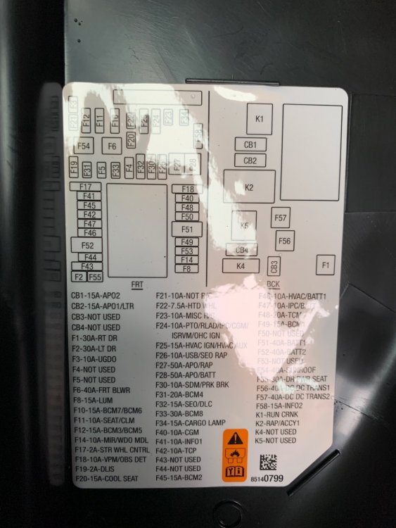

  6. Ok great so this confirms there must be something wrong with my fuse box since I cannot find a single hot fuse. I’m grounding my test pen correctly to the frame of the truck. weird home the internal components are working though.. unless the passenger side is a redundant side and they are being powered by another fuse
  7. Nice.. but did you have any Power to the fuses when you tested it?
  8. I just checked with the truck running and with the tester pen there is no voltage going to any of the fuses. But I don’t understand as everything in the truck is working. No faults or alarms

  10. Thanks, I’ll double check this again. But if that’s the case then it means the dashcan can’t be connected to this side on the battery wire? other users above seem to have achieved it
  11. Hi all, I have a 2022 GMC Sierra 3500HD and want to hardwire my Blackvue 900x. Using an electrical tester pen on the passenger side fuse box, none of the fuses illuminate whilst car is running, on accessory mode or off. Whereas on drivers side fuse box the fuses do indeed illuminate on my electrical tester. is this normal? Suffice to say the camera is not powering up. But doubt it’s the entire fuse box because things in my truck are working
  12. Hi all, I have a 2022 GMC Sierra Denali 3500HD and installing a Blackvue 900x dashcam. Hardwiring to the truck and going to utilise the passenger side fuses as per most people have done. Using an electrical tester I notice none of the fuses in that panel are emitting any power while truck is on or off. Thinking it may be my tester I tried on the drivers side panel and all those fuses illuminate my tester pen. could it be a faulty fuse box? But then should there be multiple things failing in my truck if no fuses on the passenger side was working? wondering if someone could offer some insight thanks Sachin
