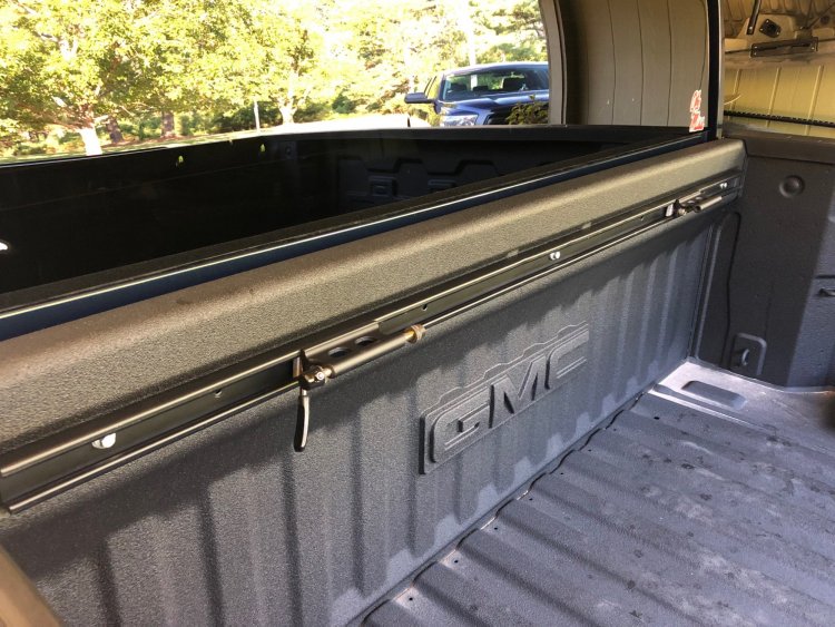

  5. The channel was simple uni strut channel. I’m can’t remember the exact size but the pic should give you a pretty good idea. The tie downs came from Amazon. I’ve screen shot the item below.
  6. I bought this GMC Sierra 1500 Elevation a month ago and have been thinking about how to mount a bike rack in the bed every since. I didn’t want to drill the bed so I bought some tie down loops made to fit the existing holes. Cut off the loop and ground the surface flat. Then I used it as a bolt base for the channel mount I had in my previous Tundra. Worked great. See pics!!
