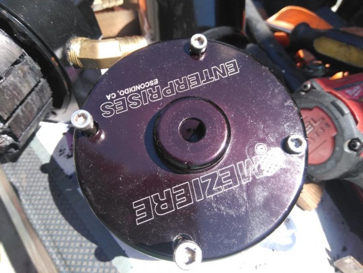

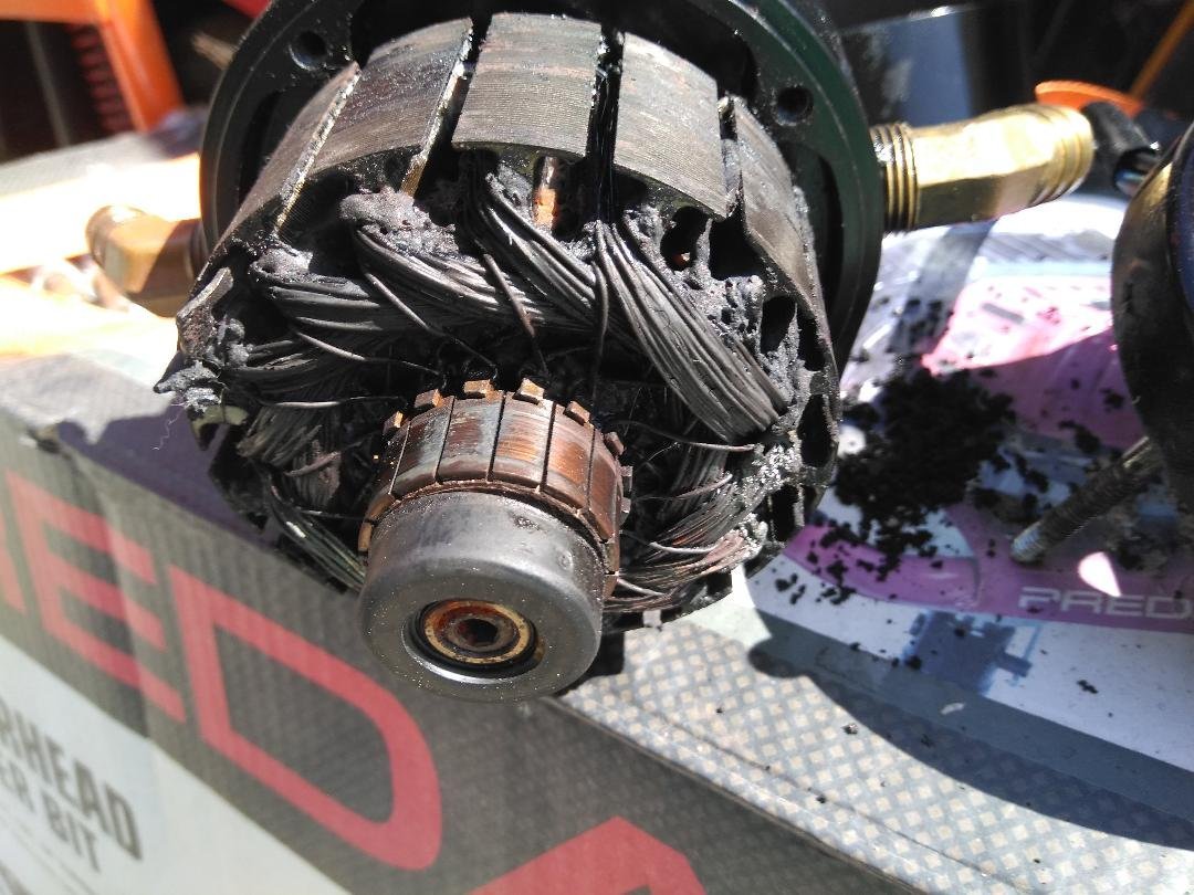

  11. So far, I believe this is the best thread on the internet about these trucks. I have both the truck and van version of VIA motors conversion. The pump you are talking about is likely not cleanable to make it work again easily. This is my pump I just replaced and it was burnt to a crisp. It is a Meziere wpx702 and they still make it though it costs $1000+ typically. VIA sold me mine for $540 and shipping which cost $570 total shipped to my door 3 days later. It is the best deal going and Travis is a great guy. It has 4 hoses with automatic transmission fluid going to it. Be ready to take a swim in ATF if you are replacing this unit. You will need a crimping type of pliar for one of the hose clamps as it is a crimp on type or you can buy a screw on one to replace it. When this pump is not working, no coolant goes to the traction motor or the generator and my guess from reading the motor document, it "demagnetizes" at a certain temperature probably for self protection so the ICE engine has no load and revs to redline and not able to charge the battery pack. I want to find a way to attach an external lithium ion battery pack to add to the capacity of the factory pack and maybe even eliminate the ICE motor altogether. If anybody have suggestions, I would appreciate it. Based on the information I believe, the truck uses A123 Lithium Iron Phosphate type of battery that has 3.3V nominal voltage per cell and they are 120 in series (3.3V x 102) to make 396V nominal battery packs. I figure an equivalent voltage of 3.7V lithium ion batteries will take 107 in series x 3.7V to get 395.9V nominal voltage. I believe these trucks are good for gearheads with a good mixture of "nerd" in them to own but not for everybody. I have been working on ICE vehicles for decades and taken apart a few EVs and hybrids (Prius, Volts, and these VIA converts) while repairing some that were worthy.
