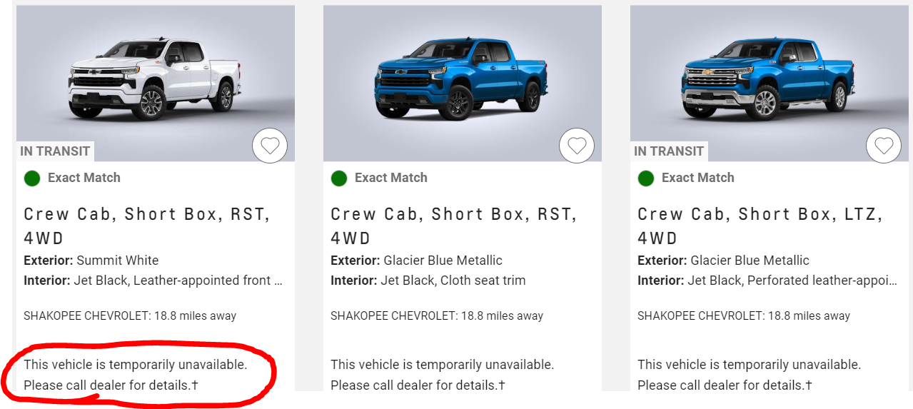

  11. I happened to notice this when looking through inventory on the Chevy site: This note is on the vast majority of trucks listed but I can't seem to find any information on it. I also found the same message when looking at inventory directly on the dealer sites. Does anyone know what's behind this? Is it possible this is related to this thread?

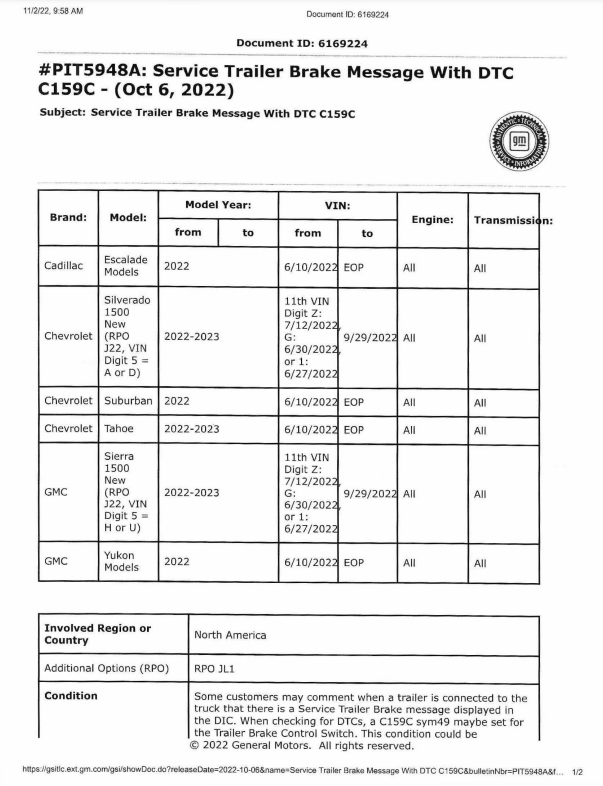

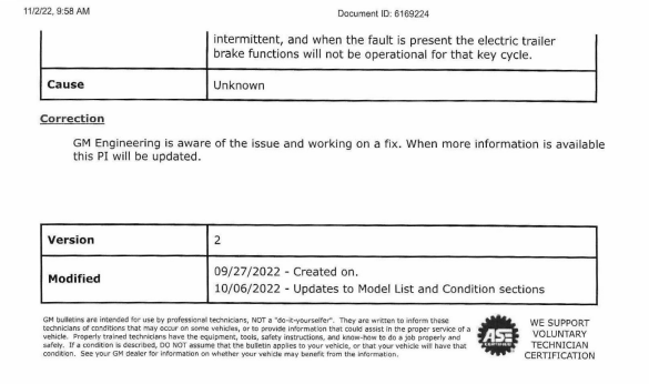

  14. PIT5498A.pdf Here's a more legible copy of the service bulletin. What confuses me is if there is a known end-date on affected trucks, 9/29 in our example, then does that mean everything built after that date is functioning? Wondering if 9/29 speaks more to when the bulletin was issued because otherwise it means there is a fix but for unknown reasons it can't be rolled out to impacted trucks quickly/easily.
